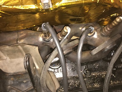

I just got my wideband o2 sensor in the mail today, and I am looking for a good place to mount the o2 sensor on my 2000 XJ with the dual pre-cats after the manifold. I am going to be swapping the stock exhaust manifold for a banks header, but there still doesn't look like a good place to mount the o2 sensor before the dual cats. I just wanted to see where other people ended up mounting their widebands when they have dual pre-cats. I was looking at possibly the area right after the manifold flange mount on the y pipe/cat side, but it looks really tight.

In looking at the exhaust system, I was thinking the only location to mount it is where the large red circle is, where the y pipe merges. I considered mounting it in the flange right after the manifold - small red circle, and before one of the Cat's but I am not sure there is enough room there.

No o2 bung hole there in the intermediary pipe on my truck right now, that pipe basically runs from near the oil pan drain plug past the Tcase to the third cat. I have no problem welding in a new o2 bung, but I was trying to figure out the best place to locate the wideband o2 for the most accurate reading, and to see where others have mounted it. I want to be able to get accurate data logs for when I tune my stroker. I guess with the space available I'll have to put it where the red circle is downstream.

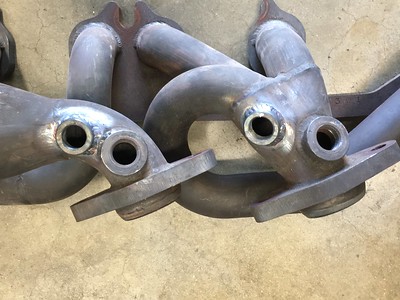

I agree its best to monitor both banks before the cats, I'm no expert. I have a 2000 federal emissions and am running the earlier style Banks manifold and have installed the wide band's O2 90 degrees from the factory's upstream O2 sensor at the collector (your large circle). I don't have precats since it a federal, and Banks EO number is the same for Torque Tubes and Revolver header so smog guys haven't caught that. I like being able to see it for peace of mind especially when towing when failure could mean a derailed vacation.
I had a JBA and wrapped it and it failed in less than 2 years in So Cal. The Banks I got ceramic coated (Jet Hot) and that lasted a few climbs to Big Bear and Round trip to Moab before it started flaking off.
Looking at the sidewinder header, there isn't much room at the outlets with the Ca upstream sensors already there. So I think you are right at installing them above the precats if you want to constantly monitor your AFR. I think I have a set of precats if you want to experiment on them. Maybe install on both banks and you can toggle between them. I think hollowing out cats may log a cat in-efficiency code. I also have a 2000 federal y pipe you could borrow for motor tuning so you can read both banks without precats.
