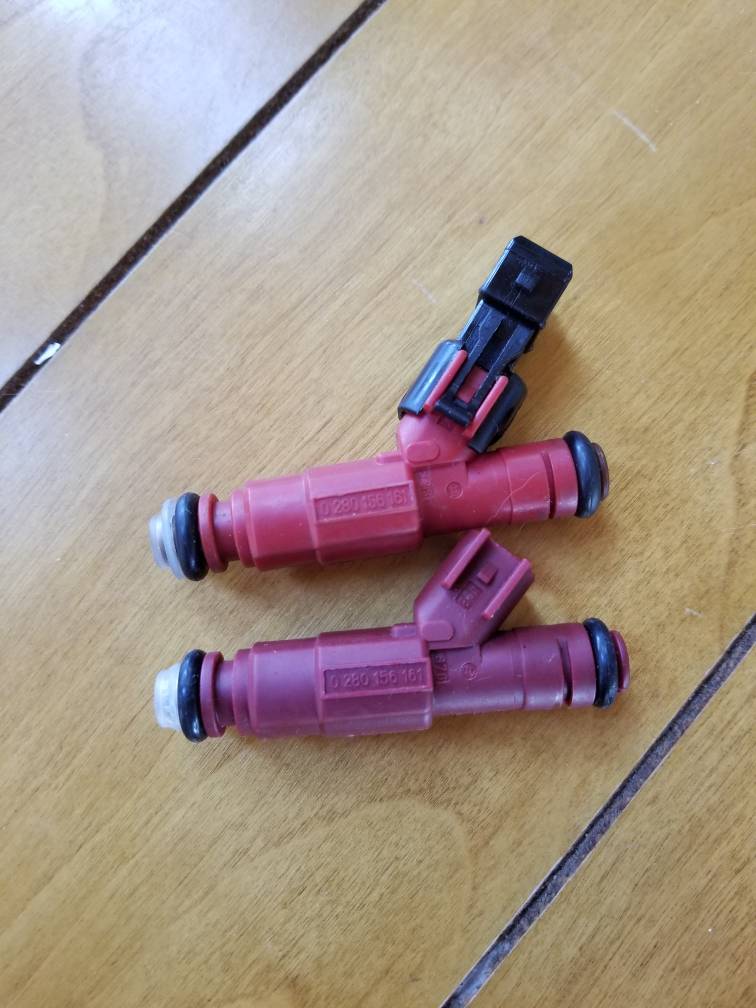

Problems after 12 hole injection upgrade
This is also more strangeness. When the first set didnt work I was sent a second set. I now have 2 sets. Both are different colors and have a different spray pattern. I'll post pics

Set 1

Set 2
