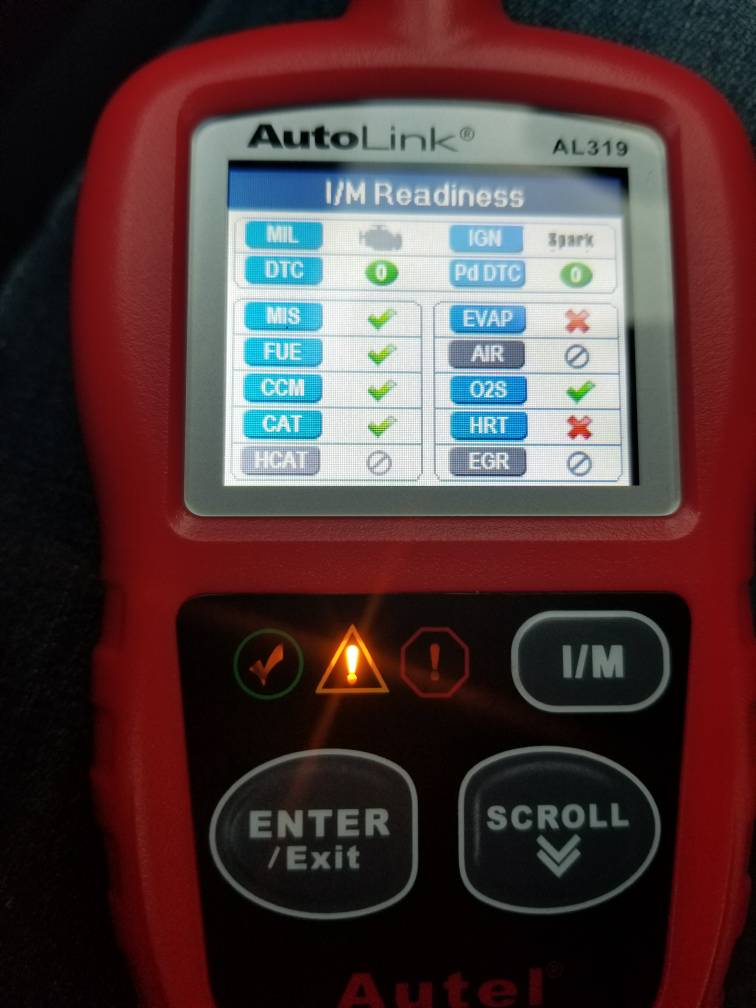

Today I upgraded to 12 hole fuel injection from ksuspension. When running it runs great! Foot to the floor and your head is pulled back, idle is lower and runs much smoother. But having some issues.
Late start
Runs suspiciously quiet for a flowmaster exhaust
Seems to be consuming more fuel than it should
Does not pass readiness test (pic supplied below)
It's important to note that I did not reset the ECU because in my experience it takes many hours for it to actually reset after pulling the battery cables. I simple let the engine adapt.

Your scanner shows the evaporative system and O2 heater tests have not passed.
Neither is dependent on the injectors.
I have tried different injectors in several stock XJs.
IMO, most of the improvement people feel is the result of clean injectors, with a good spray pattern, compared to the old, dirty injectors they replace.
The factory supplied injectors are the right size for a stock engine.
It would be interesting to do side by side dyno comparisons between new, stock injectors and the newer injectors, with more holes.
