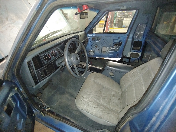

More progress. Spent the day wrenching, and mostly trying to find the right bolts to reassemble things taken apart almost 4 years ago. You know, fun.
I got the dash and interior harness in the truck. Not totally together with the harness inside, I was mostly working under the hood today.
I ended up having to rotate the interior fuse box 90 degrees, made it a bit tight to get the steering column brace bolt in, but it's manageable. The wiring adapters I made seemed to work out well.

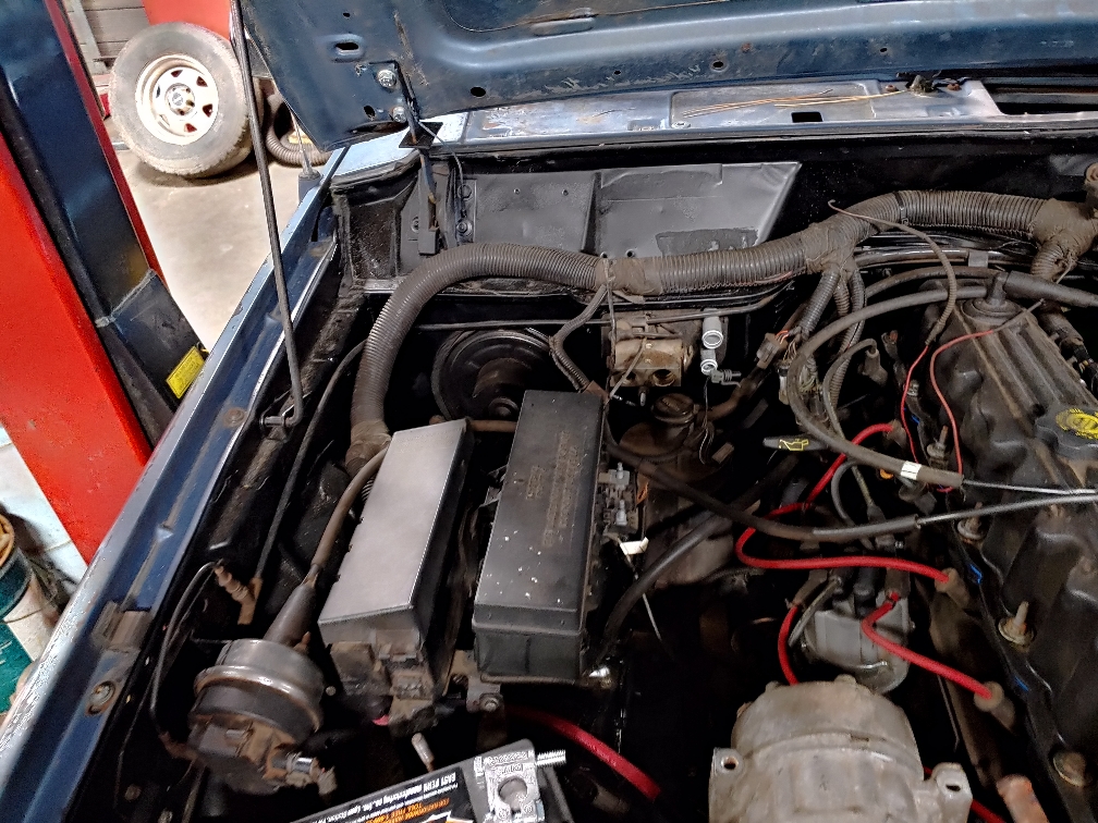

I got most of the accessories installed, verified the belt size, got the starter on, installed the rocker arms and pushrods, added the cruise control servo, and EVAP canister.
The WJ booster and master cylinder are installed. I used the brake pedal assembly from the 93 XJ, so I didn't have to modify the booster rod or brake light switch at all. I'll have to run new lines, but we'll cross that bridge when we get to it.

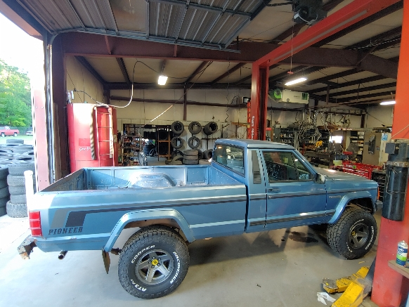

I've made very little progress since last week, had some family health issues, but I did manage to get the radiator, condenser, hood and bumper installed. Looks like a truck again. I'm worrying about cosmetic issues later, just trying to get her running for now.
Managed to snap a bolt off in the front pinion yoke so that should be fun.

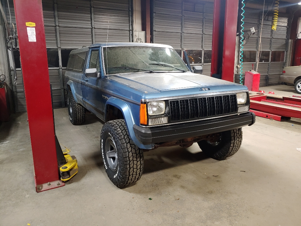

Test fitting the new wheels.
See that nasty header panel trim? I had some chrome pieces lying around that needed somewhere to live.
I did rear brake shoes, wheel cylinders and hardware so that I can have a parking brake again.

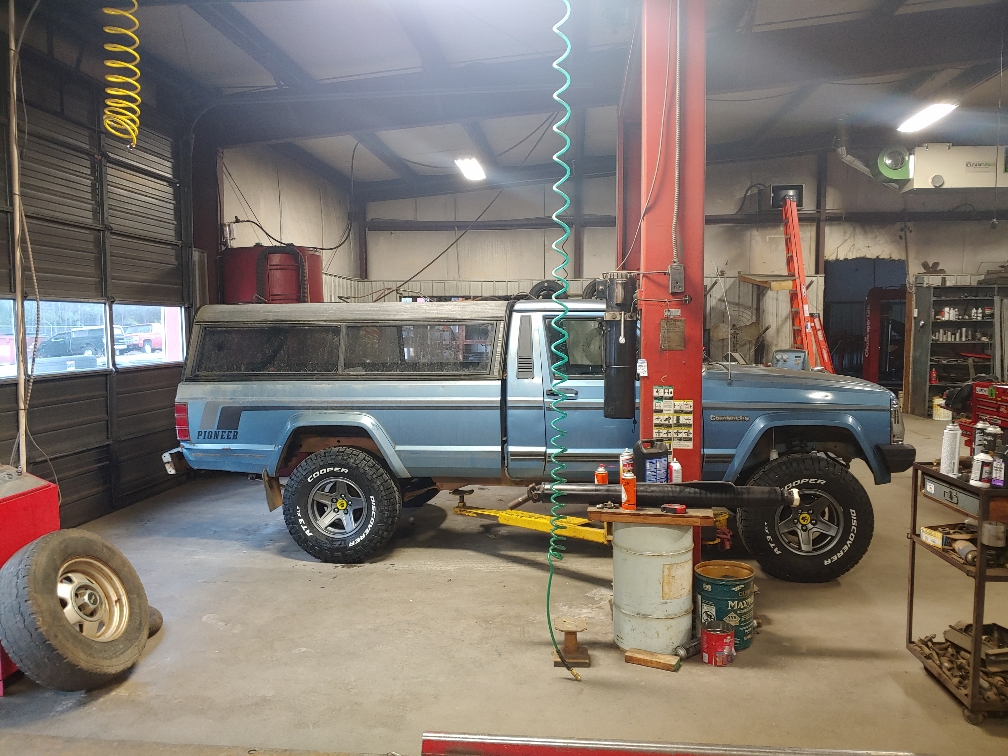

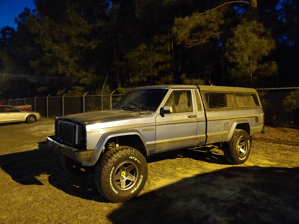

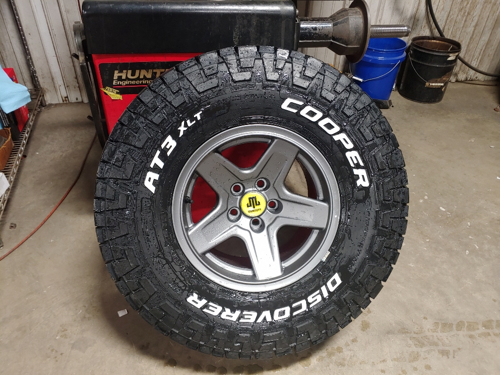

Like a kid at Christmas over here. New tires arrived! Cooper AT3 XLTs in 32x11 50R15. Wheels are Mammoth Boulder 15x8.

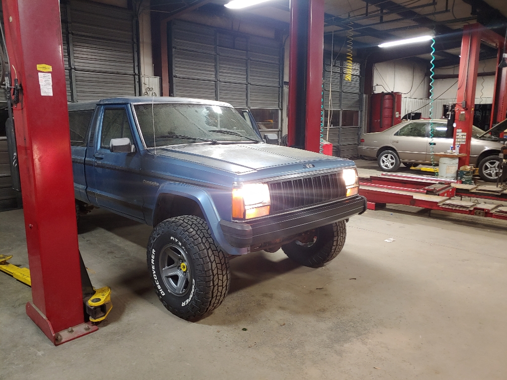

Wheels and tires are on. Adjusted the trackbar finally. I thought about buying new premade battery cables, but figured I'd make my own for a lot less, so I'm running 2ga cable.

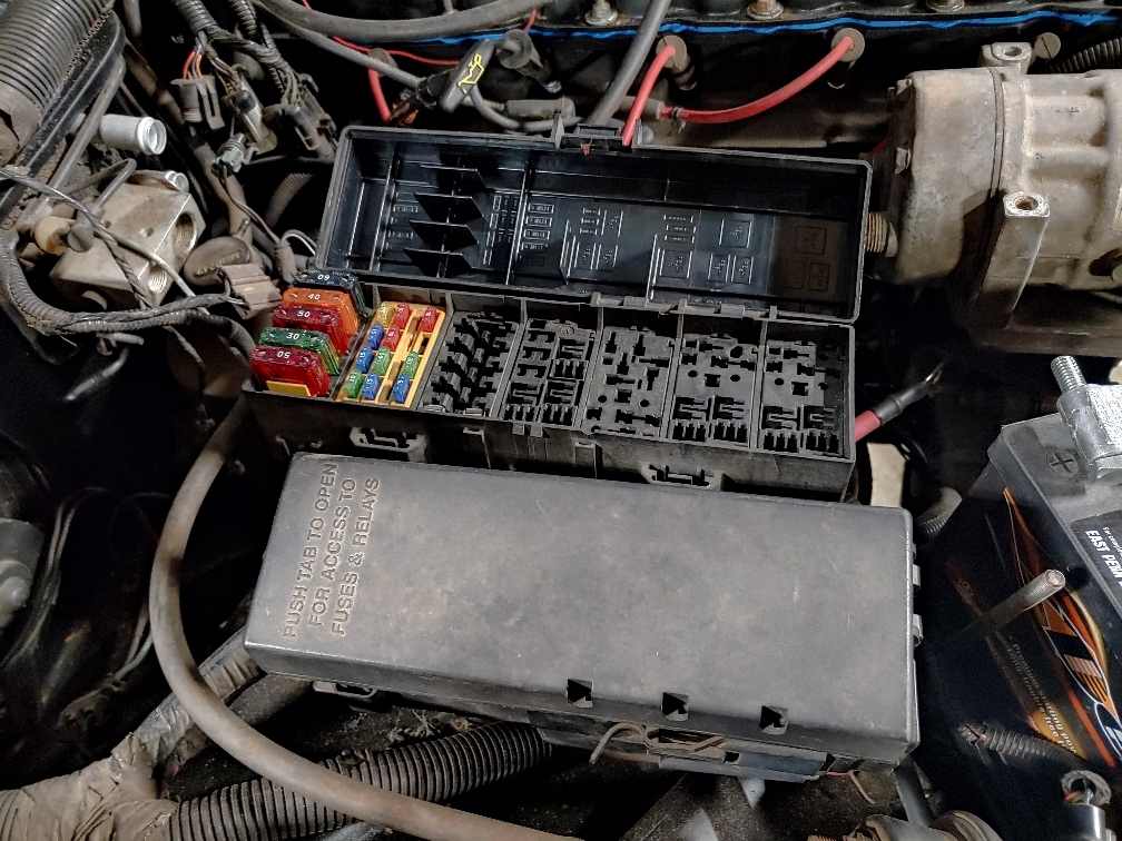

I plan on having quite a few circuits that need relays, at least 5 for the low beam, high beam, fogs, low and high fans. I don't want all those relays hanging out on the fenders, so I snagged the fuse box from a Mercury Mountaineer we have at the shop. It's PLENTY of room to expand into. There are 13 relay slots. Can't beat free.

Most of today was spent with wiring. I finished the battery cables, all 2 AWG including a new run to the new fuse box and a mega fuse for the alternator. I have the relays in the new box wired to be ignition switched and I'll just have to run network cable to my switch panel for relay grounds.

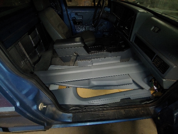

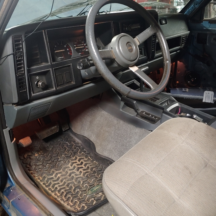

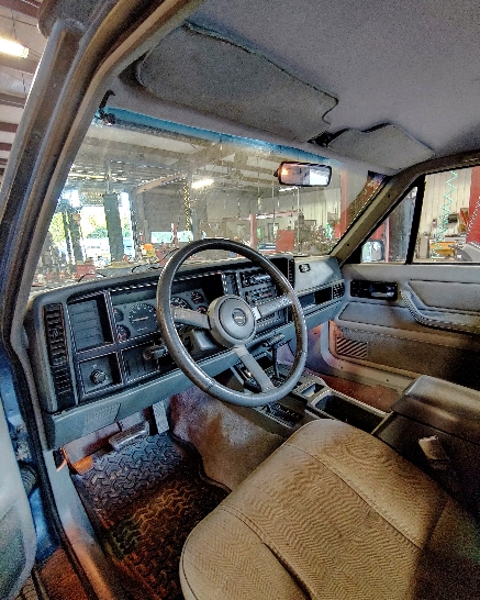

I trimmed the carpet a bit more, installed the center console, ran the cable for my fan controller, swapped the 2 door XJ driver's bucket seat onto the MJ bucket track. It didn't want to fold, but the cable wasn't broken, turns out the corner zip tie was missing. It folds now. That's my kind of fix.
I got a decent bit of the blue interior parts painted grey with SEM ColorCoat.

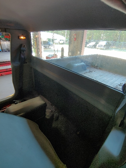

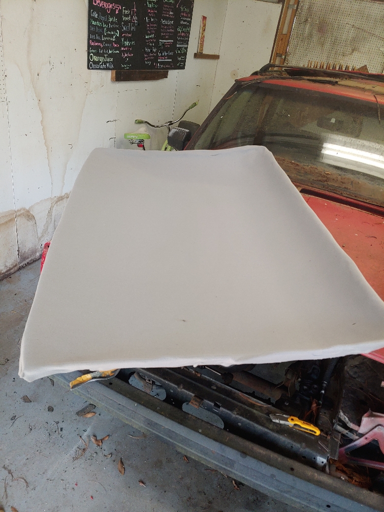

Next step is headliner and dyeing the rear carpet panel.
