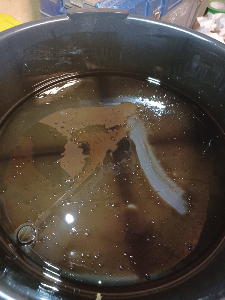

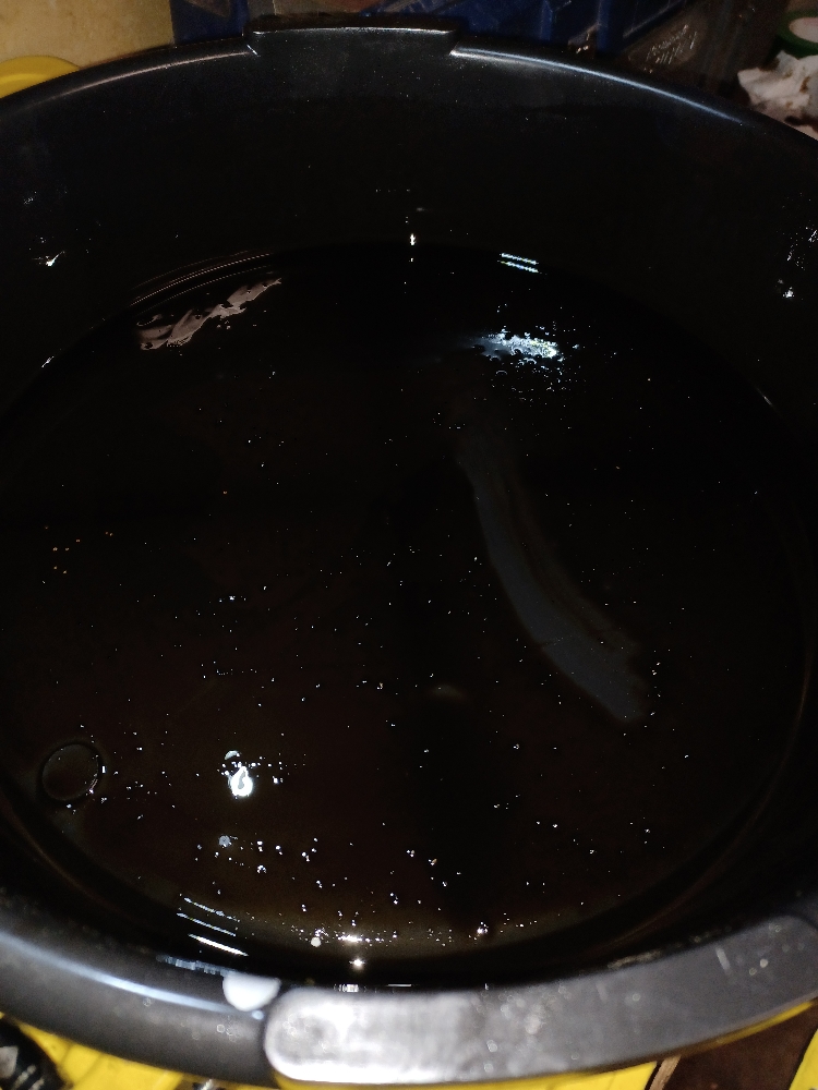

Ive through the threads on here and i still have a few questions. I changed my oil last week and found significant metal chunkys in the bottom of my oil tray. I have owned the jeep for less than 50,000 kms. I do not know its history. There was always a light knock in the engine, i assumed it was a lifter tick and didnt really examine it. After i found the metal i listened closely and it is coming from bottom end. I cut the filter open and it had no chunks in it. I always add lucas stabilizer when i change my oil (every 5,000-8000kms)
Based on this i am planning on buying a used replacement engine, preparing it as best i can before it needs to go in, and when my engine goes ill have a motor ready and i wont be in a panic.

Those are the above mentioned chunkies
