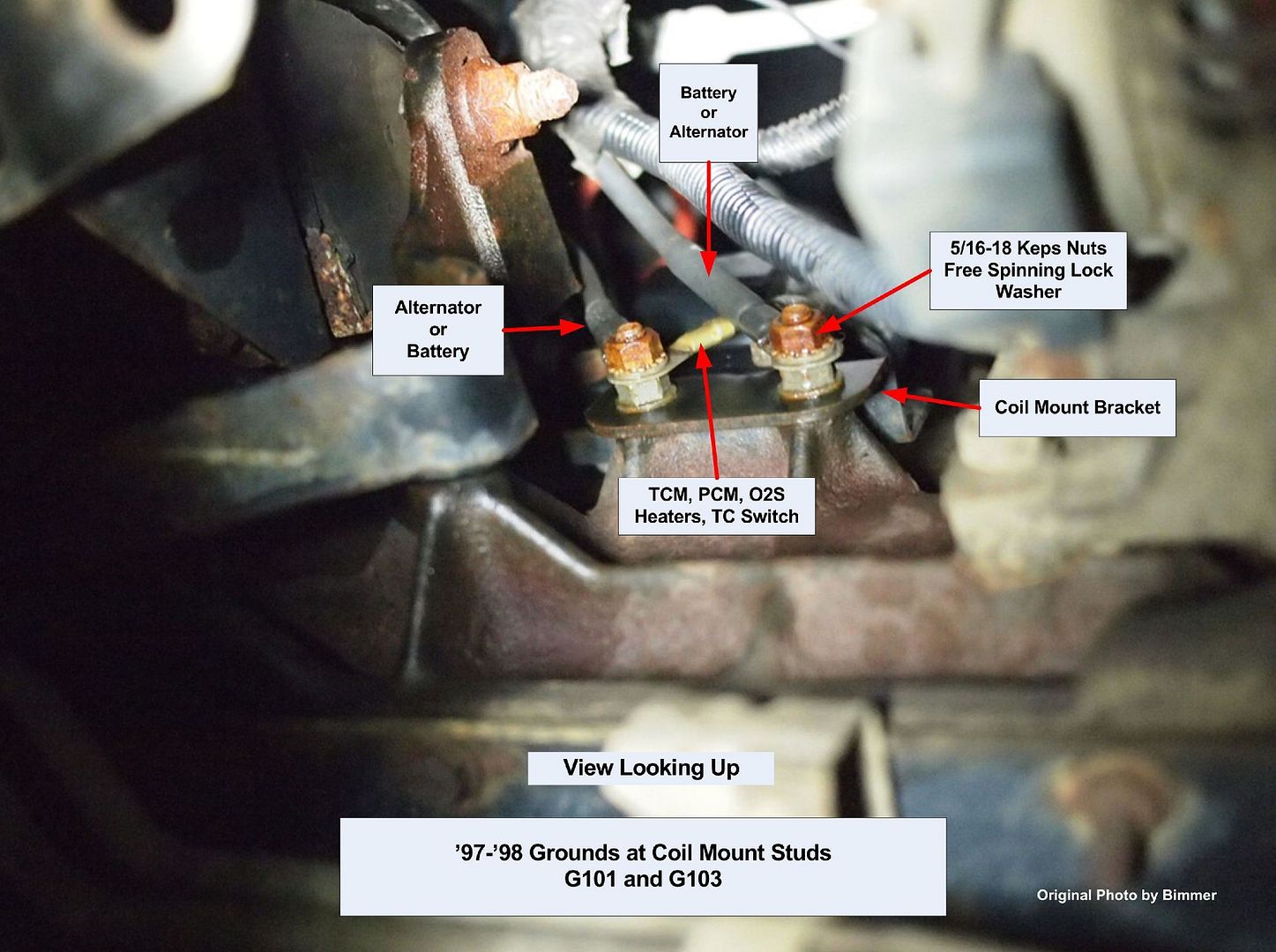

P0700 indicates the PCM sees a defect has been set in the TCM. The TCM has its own diagnostics program and will set a DTC if it detects a problem with its circuits, but I don't think you have any TCM DTC's. The P0700 may only mean that it is not communicating with the CCD Bus.
As Tim suggested, clean the TCM & PCM grounds at the coil mount bracket. See pic.
Clear the codes and see if the problem comes back. If it does, check the health of your CCD Bus.

did you ever figure out your problem? i am having the exact same thing. but when i pull the fuse #22. which is for the rear wiper motor, all the things go back to normal. i haven't looked further into whats going on but mine only has the same symptoms when the temp out side is close to freezing.
Originally Posted by Panther_spawn View Post
I have checked all wiring and grounds. Nothing seems chafed, cut or damaged. All grounds cleaned and tightened. Removed all interior panels headliner etc and found no issues.. I'm running out of ideas. Rear windhsiled wiper and defroster stay running. Door locks don't function just make noise. Clusters intermittent.. Turn signals and hazards don't work.
Sent from my SM-N960U using Tapatalk
