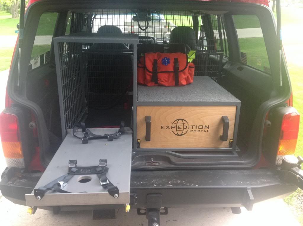

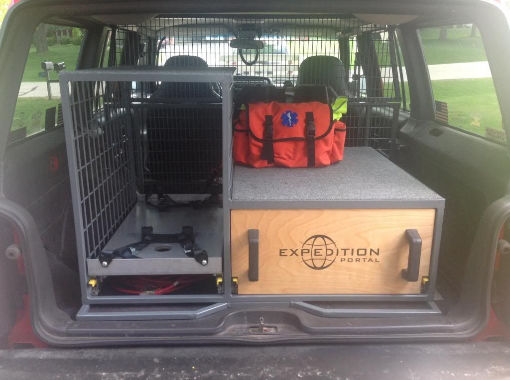

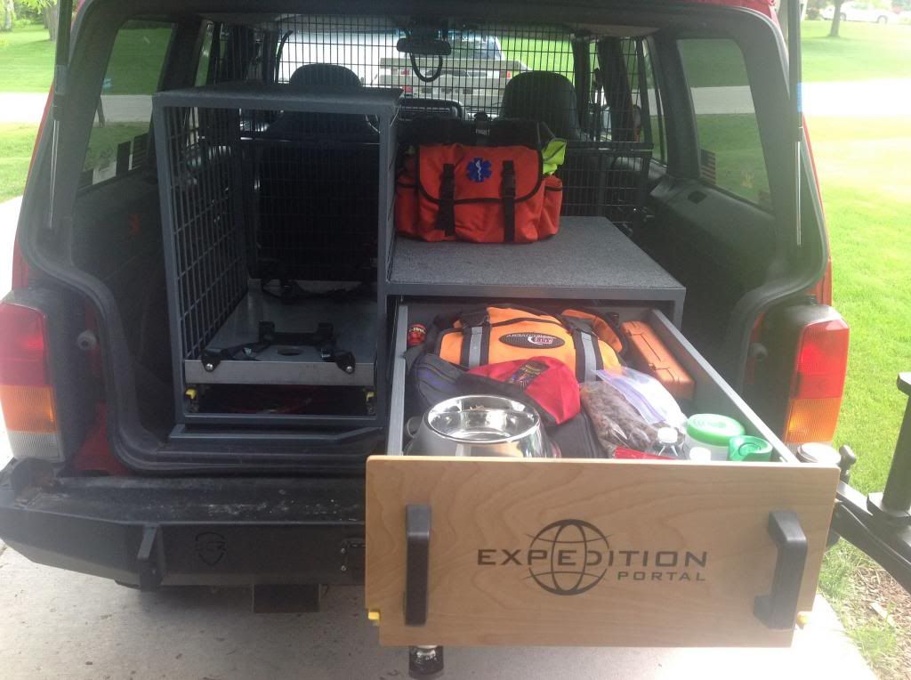

Finally got tired of my camping gear and other items being so disorganized in the back of the XJ that I decided to build a fridge slide / storage drawer. Slides lock-in / lock-out and are a bit overkill at being rated at 500lbs. Turned out pretty well, just wish I knew how to weld aluminum as this weighs more than I'd like. Thinking of adding a hinged lid to the drawer for preparing food or spreading maps out on.

Decided on a sliding lid rather than hinged. Both the top of the drawer sides and the bottom of the aluminum angle have UHMW tape on them to make things slide nicely.
