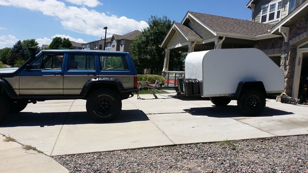

Moving day. Didn't completely finish it before I had to move to the new house. I had the air bags a bit too inflated and between the jeep and the front of the trailer, I had about 1500 pounds of tools and crap. Even at that, it pulled nice.

I love finding progress pics on this trailer.
Congrats on getting it roadworthy in time to help you move.
