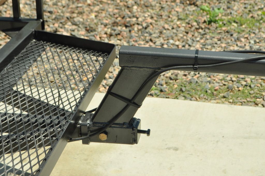

What's the purpose of that one bolt that's sticking out at the 3 o'clock position?

Lateral tension to prevent a rattle in the hitch receiver? Idk, it was a guess.
Bingo.
If you have ever pulled trailers, they always seem to have slop in the receiver and you get bumps and bangs. That isn't the bolt that is going to stay there. I have a shorter one and a lock nut for it.
You can also pull that assy appart and flip it so the tongue hangs down instead of being in the up position. That allows me to pull it behind my other vehicles if I want.
It also lets me pull the tongue to save storage space.
