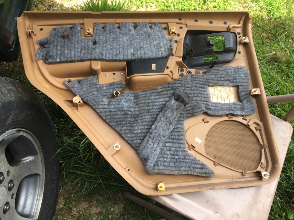

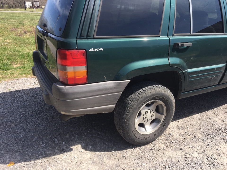

I did some cosmetic work to Verde a few weeks ago to try to cover the unsightly rear end. I went to Express one day for lunch a scored a bumper cover and steel bumper along with a replacement door panel.
Getting ready.
The old steel shell before replacement. I guess I did take a picture of the new one.
And the finished bumper cover. I went to OíReillyís and bought some of the plastic push pins to get everything locked back together. Lots of push pins on Grands.
I also replaced the passenger rear door panel and several of the pins that keep it in place. It is a charcoal gray and the interior is tan. Form over function is the key here.
I also changed out a front signal bulb. It should be a 3157A amber bulb but I didnít have one handy so it got a 3157. It will do.
