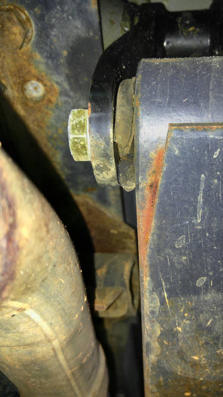

One year old factory bushings on OME leafs. I'm trying to figure out how this happened.

Very important. Mine was torqued on the ground, so I'm still trying to figure out it's issues. I'm going with factory again so we'll see if I was just a fluke.
