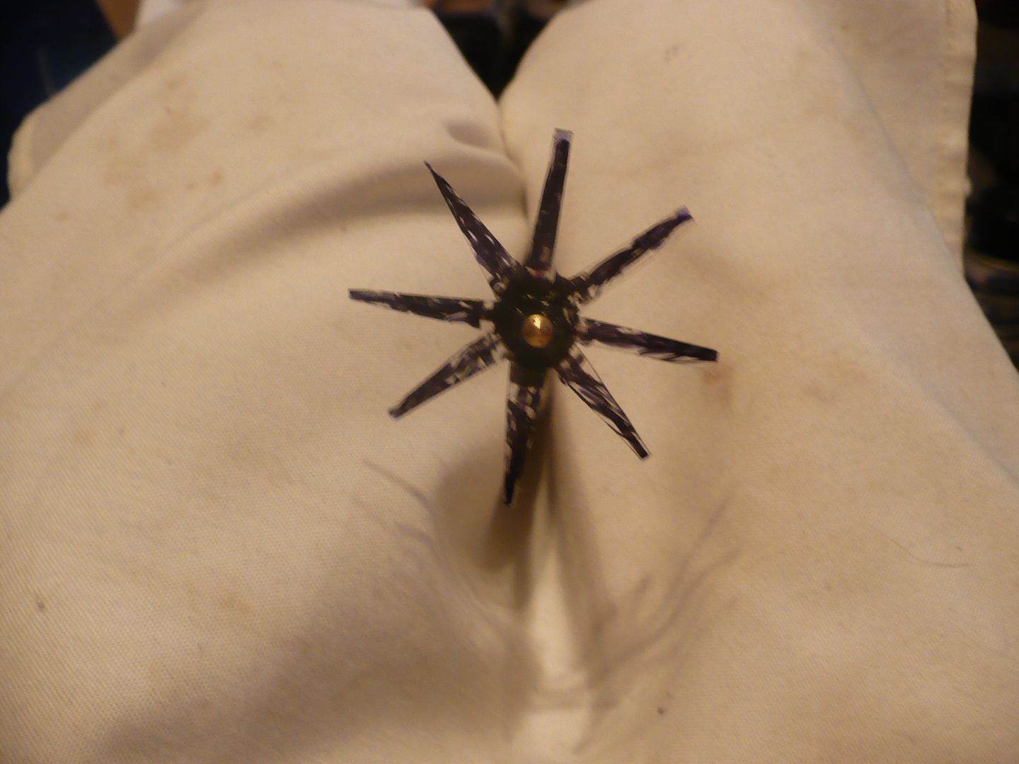

I've cut a small piece of acetate to attach to the nozzle and act as a stand-off and have gotten the tube to be straight. I will either attach a 2' piece of Nichrome or Nyrod to be able to control/turn it.
