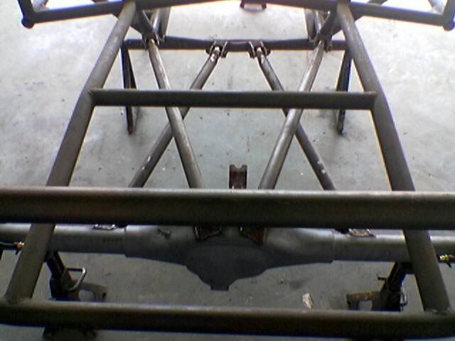

  • REAR STEER, when the one side of the axle pulls forward and the other goes back during articulation, CAUSED by lower pararel link and diagonal upper.
  • On small articulations, (side to side), you wont notice any REAR STEER at all.
  • if you want to get RID of Rear Steer, you have to have DOUBLE TRIANGULATED Arms on lower and upper.
  • Rubber bushing would work fine for street, but NOT GOOD for articulations.... (side loading, etc)
Picture of EQUAL DOUBLE TRIANGULATED Rear 4-Link arms (for rock crawling with 18" of travel)
