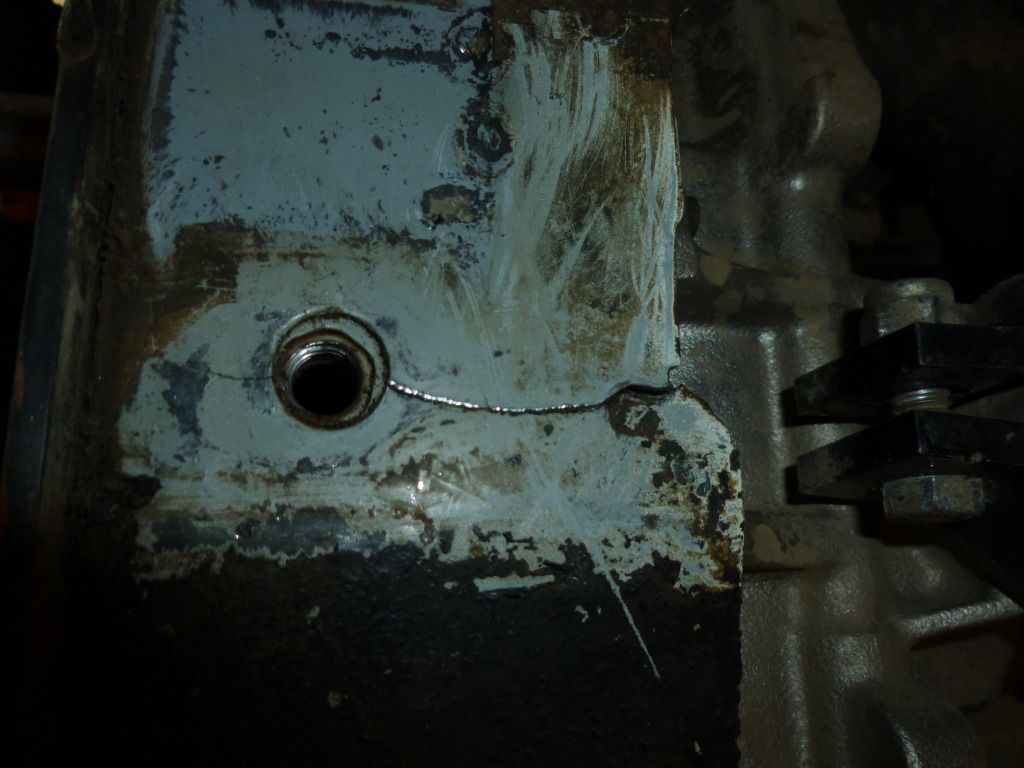

looks like I waited a bit too long for my stiffeners....
found this today.
gonna weld it, plate it, and then put the stiffeners on... hopefully I can get it all done today.

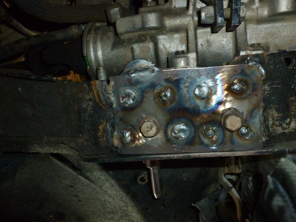

crisis averted...for now.
started prepping for the stiffeners. I won't have time to do them today, but I can get all the undercoating off now, and I think I have wednesday off so I'll get them done then.

before you plate over that crack drill a hole in the end of the smaller one where it comes away from the bolt hole (left side of the pic) this will help keep it from spreading further without you being able to see it. The rule of thumb for welding up cracks is to drill a small (1/8" or so) hole in the very end of each end of the crack then weld it up and grind it smooth.
I did that. I've seen you post about it before. I just didn't snap any pics.

Re: looks like I waited a bit too long for my stiffeners....
What a pain in the ass it is to plate the whole side of the jeep... not fun!
yep... after this crack, I want to plate the bottom of it as well...not looking forward to all that overhead welding...
Overhead welding isn't too bad but if i were to do it all again, I would wear full leathers...lol
I hate the bits that fall and burn you in places you least expect.
