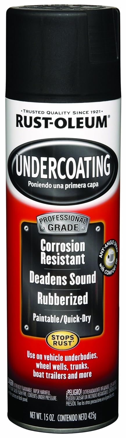

Hey guys,
Re-coated the inside of my rear fenders using the professional grade Rusto stuff.
It went on super thin, so now I am thinking about doing another coat of something over top.
What is the best undercoating these days?
Is there anything that goes on thick and stays black?

If you have already applied one coat your pretty much stuck with whatever based the first coat is. What exactly did you apply?

Yeah I might end up striping it. Used this stuff.
