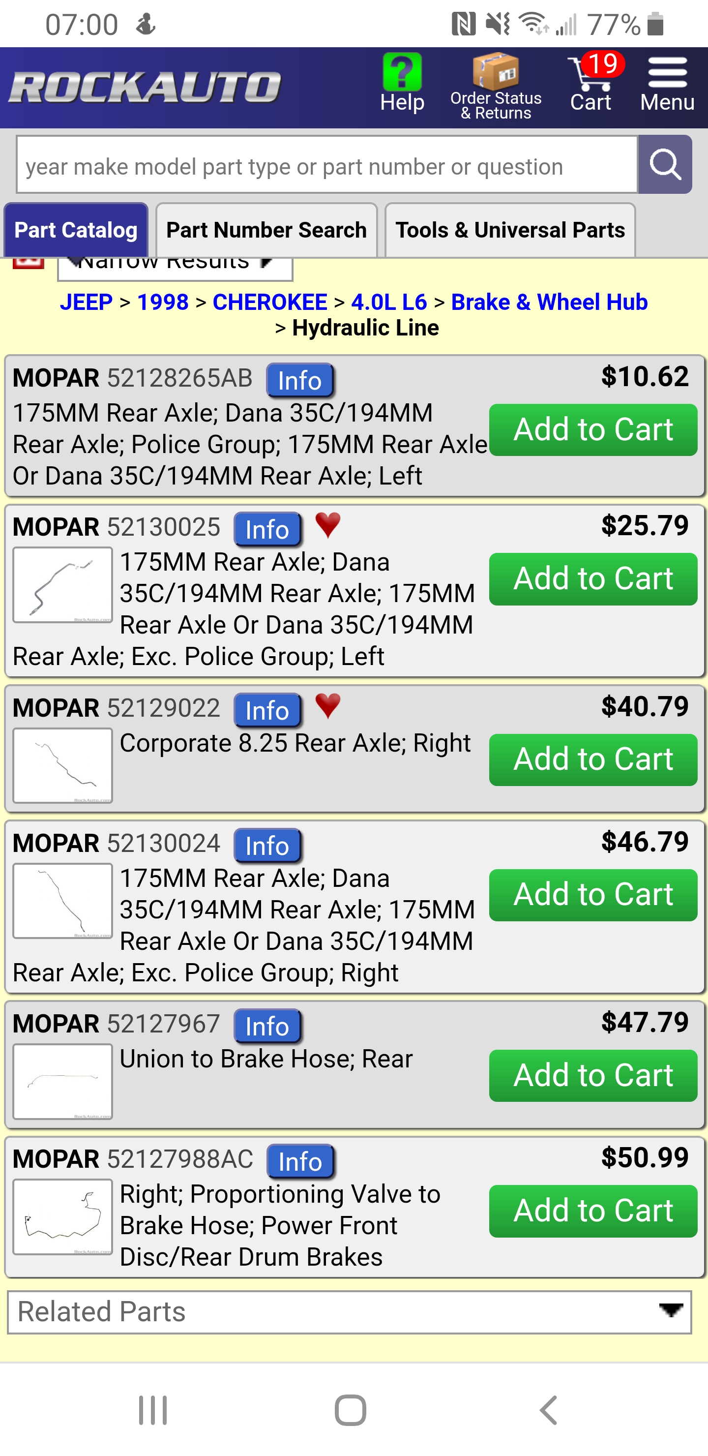

Looking for a pre bent brake line kit for a 98 classic Cherokee
Looks like Rock Auto still has some OEM mopar lines leftover in stock. Not sure if those PNs will work with ABS though.

Re: Looking for a pre bent brake line kit for a 98 classic Cherokee
thanks for the link. I got a 25 foot roll of break line off Amazon. to make myself spend little time and save some money.
