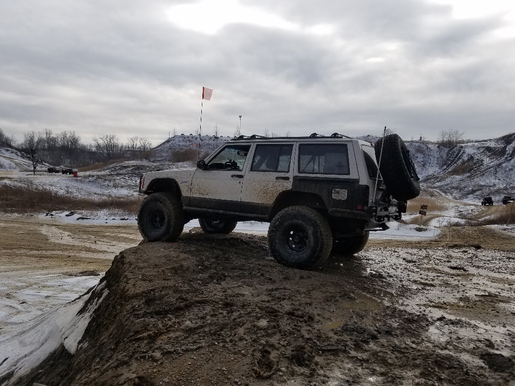

Well I figured I would document some of this for the next person doing a swap... This will be a years with of work.. It will jump around a bit because I'm going to post in my photo order. Picture quality will also increase as I eventually got a new phone...
It all started with a decent built Jeep on 35s..

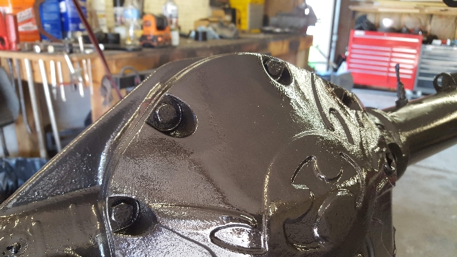

2 of the completed pics for the rear end look like it has a bronze tint or something I can’t find the color for lol... is it just the flash on some Por-15 or did you rattle can it?

It's rattle can Rust-Oleum Hammered Black, it does have a bit of a bronze finish. I like it.
