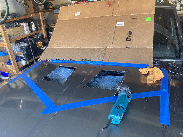

Some parts showed up this past week!
Skid Row TC skid
(dont mind the busted crossmember.. lol)
THOR cowl intake.
Great kit. You'll definitely notice it from the cab though as far as noise. Kinda wondering about heat soak with all that surface area above the valve cover with the hot temps of our motors?

Originally Posted by upsidedownxj View Post
THOR cowl intake.
I just bought one of those used for $115. Not sure if I want to use it for the very reason that you stated about the noise. My Jeep is just a DD but would not mind uncluttering the engine bay some.
Also the cutting part. I have no problem with the cutting but if it is just noisier then I would like and I take it out now I have that hole there.
Part of my commitment issues. LOL.

Noise is awful IMO, I ran the THOR kit for maybe 1 week before taking it back off. Now I have a hole in the cowl to remind me...
That was my thinking yo but used in good shape for $115 shipped I figured I would grab it.
And then overthink it like I do everything else. LOL.
Skid Row TC skid
THOR cowl intake.
I have the thor kit as well. If you live monitor, on the highway your temps will be about 20-25 degrees more than ambient. It does very with keeping intake air temps cooler. Imo the best cold air intake on the market for xjs

I have run a cowl intake, for 11 years, utilizing the stock airbox.
It is quiet except under full throttle and,in the summer, the intake air is 20-30 degree cooler when cruising. I cut a hole in the driverside firewall.
The box has a second opening, near the stock location for a cap, used when fording deep water. I leave it off in the winter when hot air isn't an issue, replacing it in the summer when cooler intake air is desired.

THOR cowl intake has a CARB EO#.
Sweet deal man, thanks for the info. I can deal with the noise; got a loud enough stereo. And this is not my daily driver.

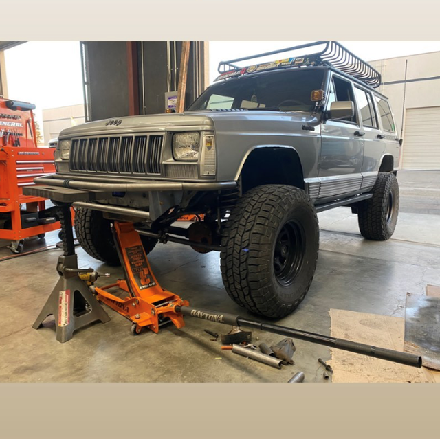

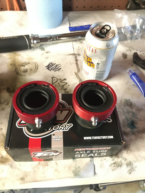

Works been real busy lately, but I've been squeezing in some wrench time on the ol' girl where I can. Was really hoping to make Sierra Fest with the local chapter here, but I dont wanna jump the gun and be ill-fit for the trip. Im currently saving for sliders and a new rear axle. Waiting for an XJ d44 to pop up in a local JY... (might be a little too hopeful on that one) or im gonna just go with the 8.8 exploder setup.
Aussie lunchbox in

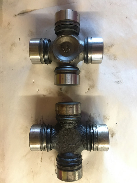

Bye 260s! Hellooo 760xs
Not sure if these are necessary, but they look cool

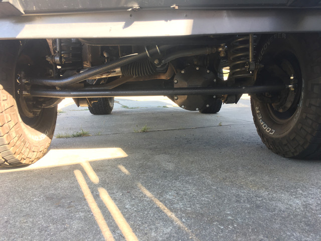

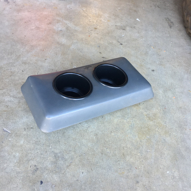

Sold my CavFab kit and went with the Trail Forged setup. The powder coating alone was worth swapping for, and it clears my trackbar hardware!!

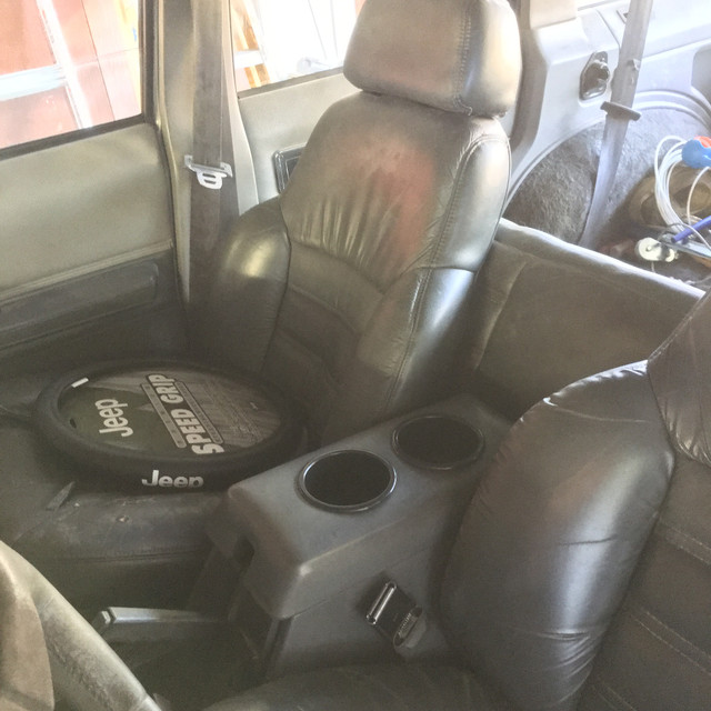

Also made a cup holder, very happy with it. Cost me 15 bucks in parts

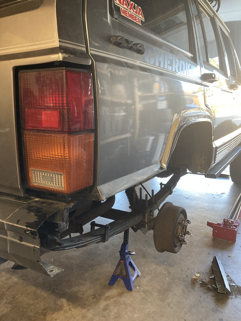

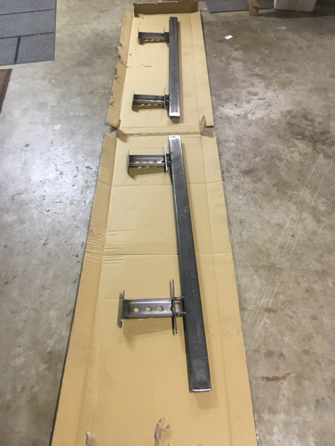

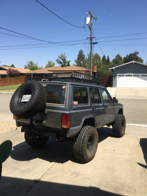

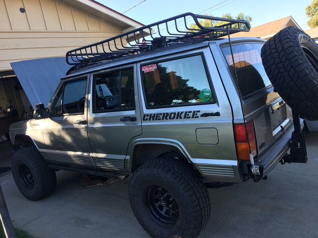

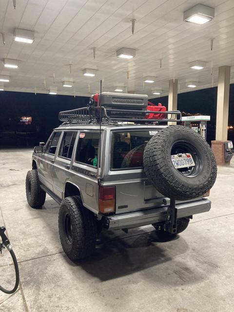

Also scored a spare tire carrier on the cheap off FB. Pretty happy with it, but it does hang down a little lower than id like.
Even made it out to hollister to witness some classic JK action
Sweet, I did the same cup holder mod.

Cup holder mod is brilliant
