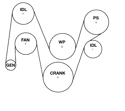

K so I have swapped a 99 intake onto my 92 4.0 along with 99 power steering pump what lenghts of serpentine belt should I be running and if anyone has a pic of the routing that would help as well thanks guys
DAYCO 5060950
Color: Black
Effective Length (mm): 2415.04
Effective Length (in): 95.08

I took out the upper idler pulley and used the new idler pulley under the p/s pump
^^^ Yup, just did this same manifold swap on my 95 XJ. The belt is soooooo much easier to adjust with this newer setup but the belt needs to be very tight or it will squeal when you use the a/c (as I found out).
Thanks for the info just picked up the new belt not too worried since my rig doesn't have AC but thanks for the heads up
