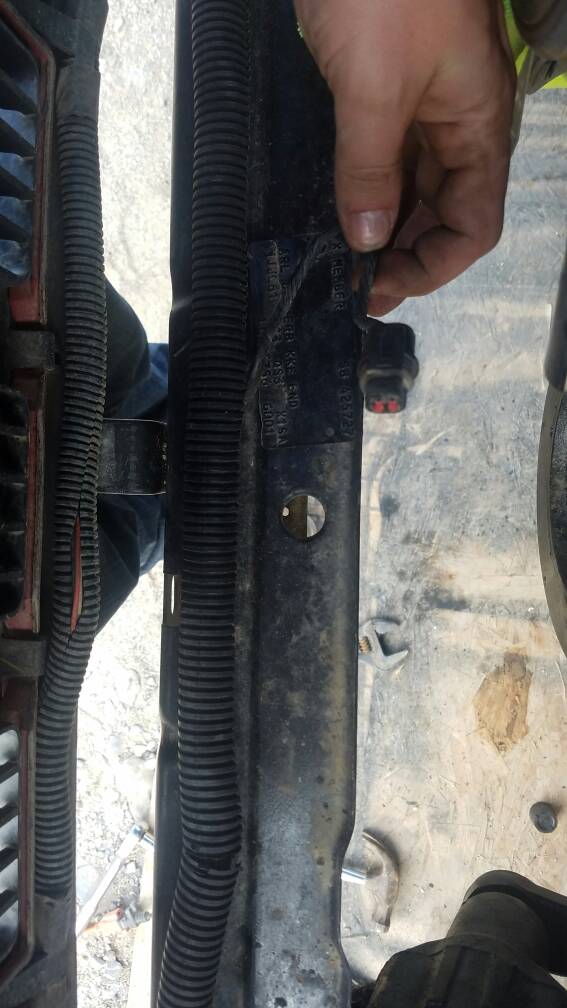

Anyone know what this plug goes to on a 1990 mj? It's in the dead center of the harness loom in the grill/radiator cross member.

Ambient temp sensor?
Hmmmm...yea I'm not sure. Cus my 89 parts truck doesn't have one..... and as far as I'm aware I never had an ambient temp

Outside Temp sensor. Factory just wires it in most vehicles, cheaper than doing a different harness for temp equipped vehicle.
Sweet. Ur telling me the ohc I'm putting in my mj I don't have to bother wiring haha. Score. Now I just have to find the other end. Anyone know where it is?

Nono. No wiring got cut inside the truck lol. I'll have to go looking for it. Anyone got a picture of what the plug should look like?
