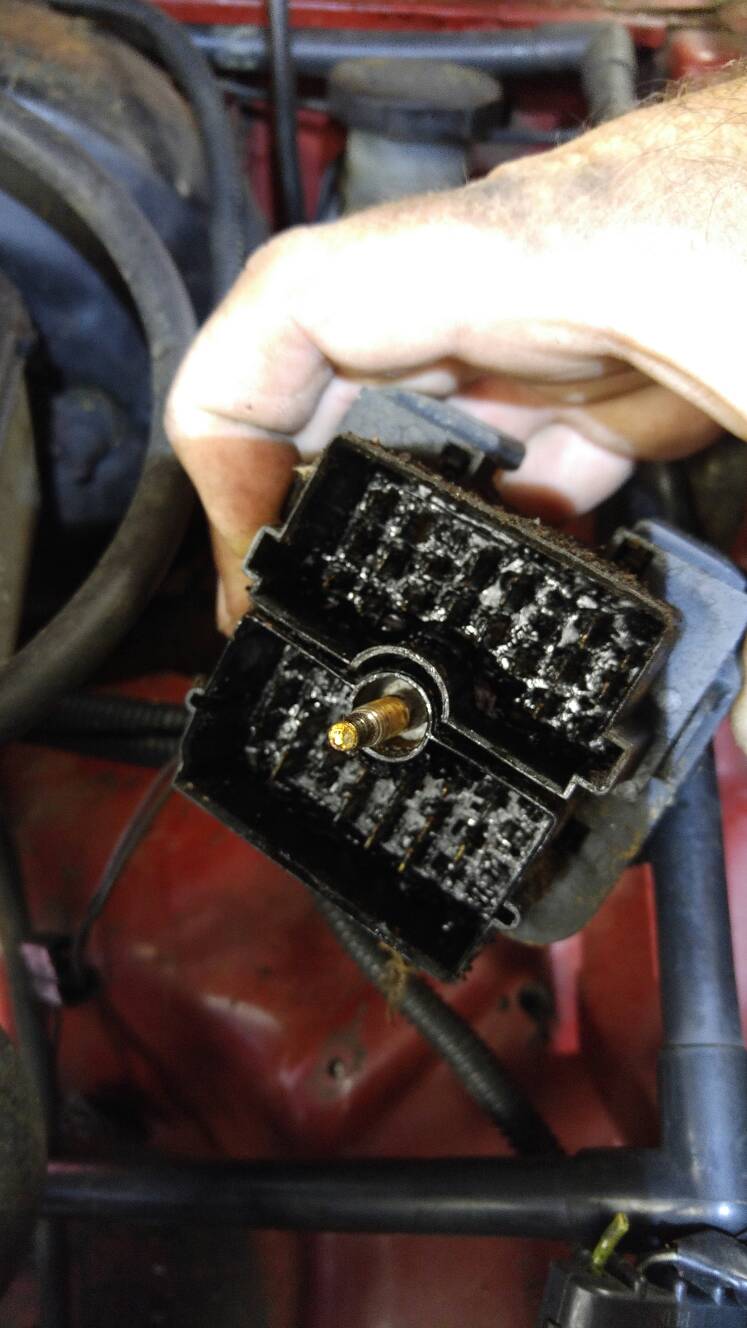

Eliminate the c101:
http://cruiser54.com/?p=140
Thanks Cruiser. I just went to a friend's house on Sunday and he came to the same conclusion about the steering column. I did pull apart the c101 connector and cleaned it as well. I'm about to stop by my lunch break at the junkyard and look for steering columns. Any 87 through 90 should work as long as it's remix right?

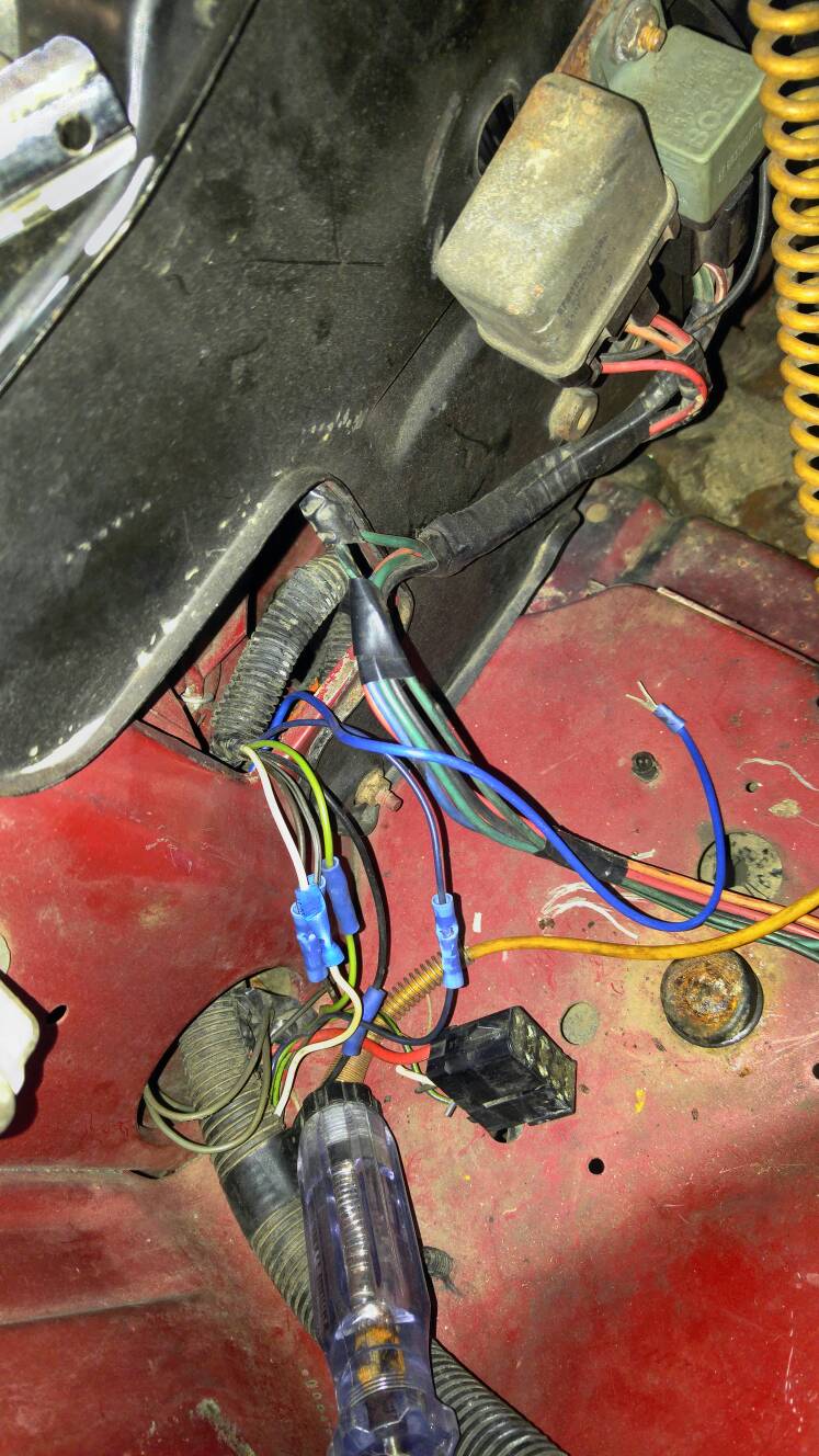

And cleaned up the brake light switch. Found the brake light fuse had once side not making a connection. Fixed it. Brake light work. Also found a 97 4 cyl xj in the salvage yard...has the fan shroud w/ elec fan mounted in it. Not sure that I need this but it was pretty cool.
Pulled column down to check ignition switch. Everything is getting power in run position. No melted wire or corrosion. All I have is a test light to check with. I'm on the hunt for steering column wiring diagrams tonight. And I'll be checking wiring connections under the dash tomorrow, pulling the fuse block loose from the fire wall if I can, and cleaning any grounds I find under there. Looks like the brake or clutch MC's have leaked in the past. What a pain in the butt.
check the grounds in the front turn signal sockets.
it's an open faced socket and they get super nasty. Will cause no signals in the front, and somehow the parking lamps will ground through the dash indicators.
If the clutch master has leaked you probably need to pull the fuseblock. BTDT, sucks. You'll find some jumper wires back there that relate to all of those circuits. Pink wire IIRC, it's been a while.
gas gauge is probably a failed ground at the tank. Check it. Then see if you have proper ohms from the sender with it disconnected from the harness.
Bulkhead connector looked "good". Worked on some of PO's wiring. The butt connectors were already there. Front turn signals have power to sockets but not making it through to the bulbs.
On the way to parts store now for something that'll work as turn signals/running lights.
Sent from my VS986 using Tapatalk
looks about right.
power to the sockets but no lights is almost certainly failed grounds in the sockets. pull the rubber/foam gasket off and you'll see the exposed, and likely rusted, ground tab.
Got front hazard lights now but no turn signals. Stalk on column is real hard to twist but wipers do work. I'm going to compare steering column wiring with my 91 xj tomorrow to see if I can make sure power is getting to the turn signal switch and back out of the column.
Alright I'm down to the flasher for the turn signals is not getting power. Until I got the all data wiring sheets I thought power but from the switch to the flasher relay but now I realize the relay is before the switch. That's why there's only one flasher relay for both sides of the Jeep. Kind of feel dumb now that I think about it.
