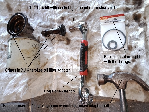

What I thought was going to be a simple job got a little complicated. When I built my stroker, I had a T60 adapter and everything went good but I probably installed it before installing the motor. Fast forward 2yrs, now I'm working on Lil'Sis and my T60 tool is nowhere to be found, no problem I'll just grab another one. I got a 1/2" drive one and thought great ready to go, wrong it won't fit in the engine bay. Solution cut the socket off and just use the tip with a crow-foot wrench and breaker bar. A lot of work for such a small project.

I made a permanent tool for this, pulled the t60 bit, welded it into a 12mm wrench and "formed" an old jack handle for a cheater. Lives in my "extra special jeep tool" drawer.

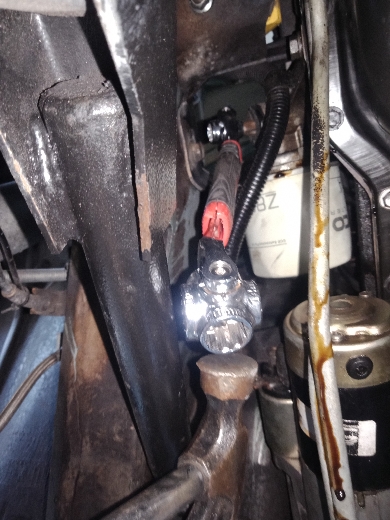

I get mine on and off using these tools..

That is the first time I have seen a good use for one of those dog-bone wrenches. Looks like just the tool for this job.
