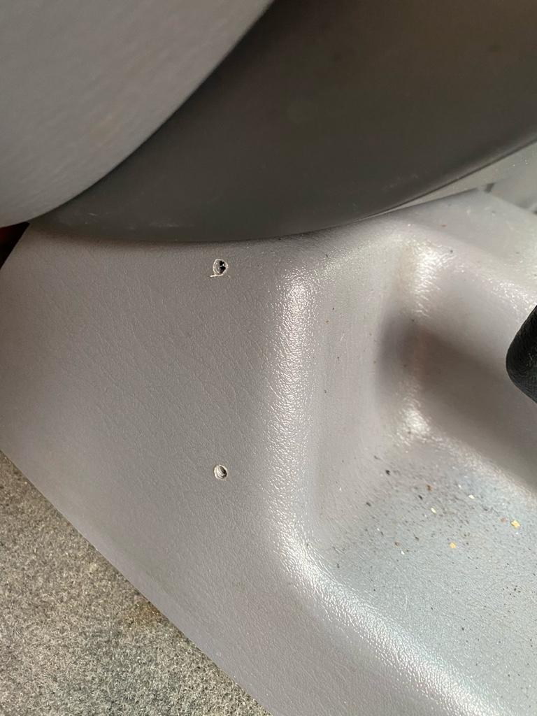

Almost positive now that this was a police vehicle before, it has those holes that look like things that were mounted on there
