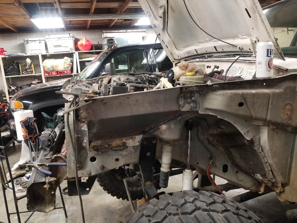

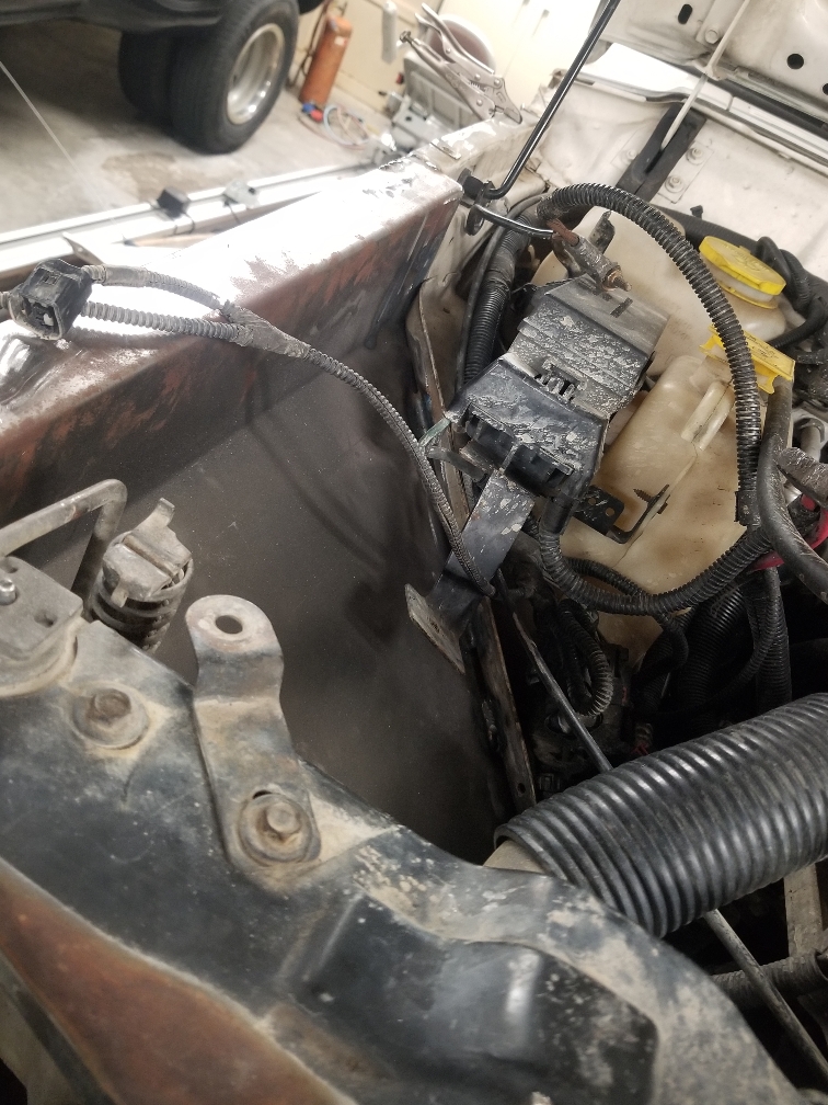

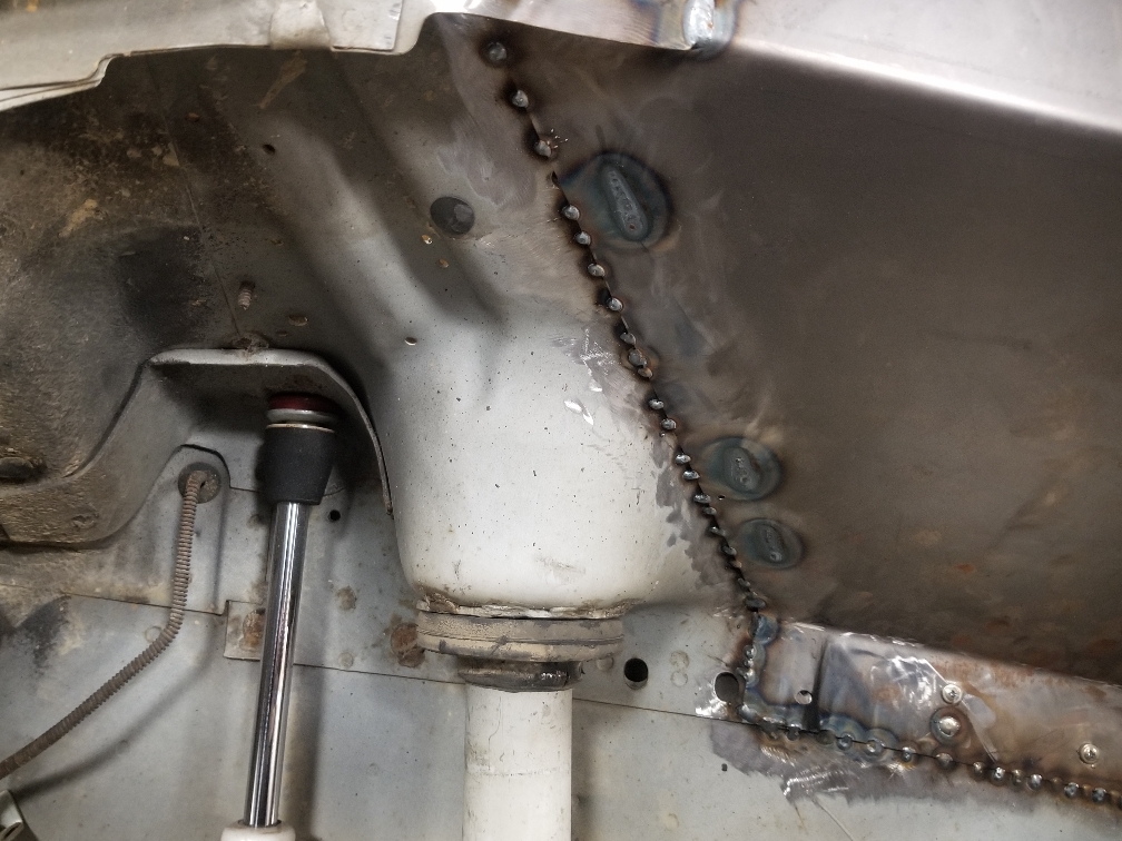

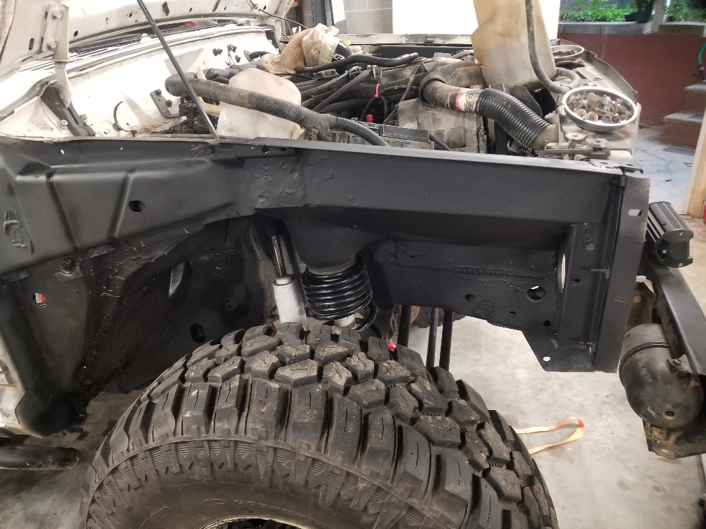

Hey y'all I'm sure this has been covered, but it seems most xj on 35s and factory front 30 don't trim much inner fender out. This is an old beater so it's getting the death wheel so I can maintain the stuff I had with 31s... Anyone see major issues in doing this? You can see the cut line in the second photo.

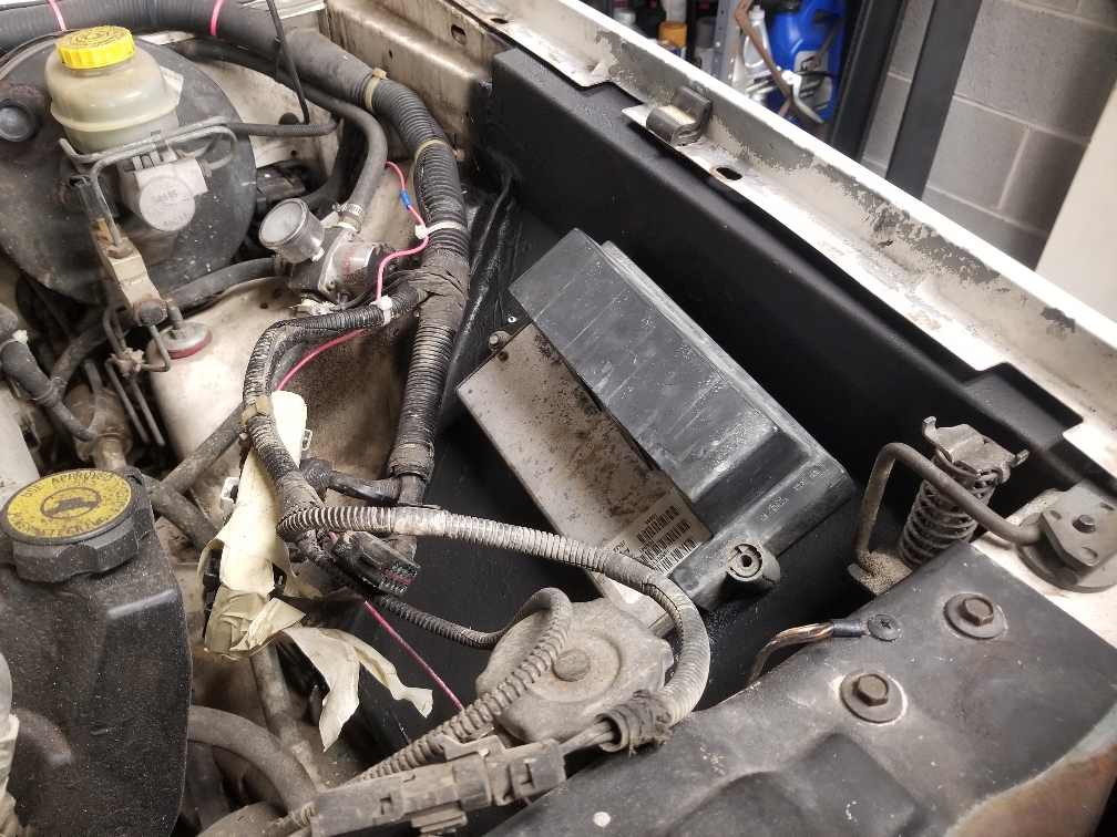

Battery will be relocated to the hatch, and a thor intake will fix that aspect.

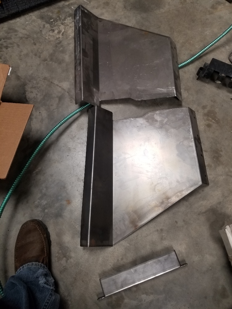

When I got to this point is when I started thinking of the tnt inners... I'm not a metal whisper, so I would be time and money ahead if they fit cleanly.

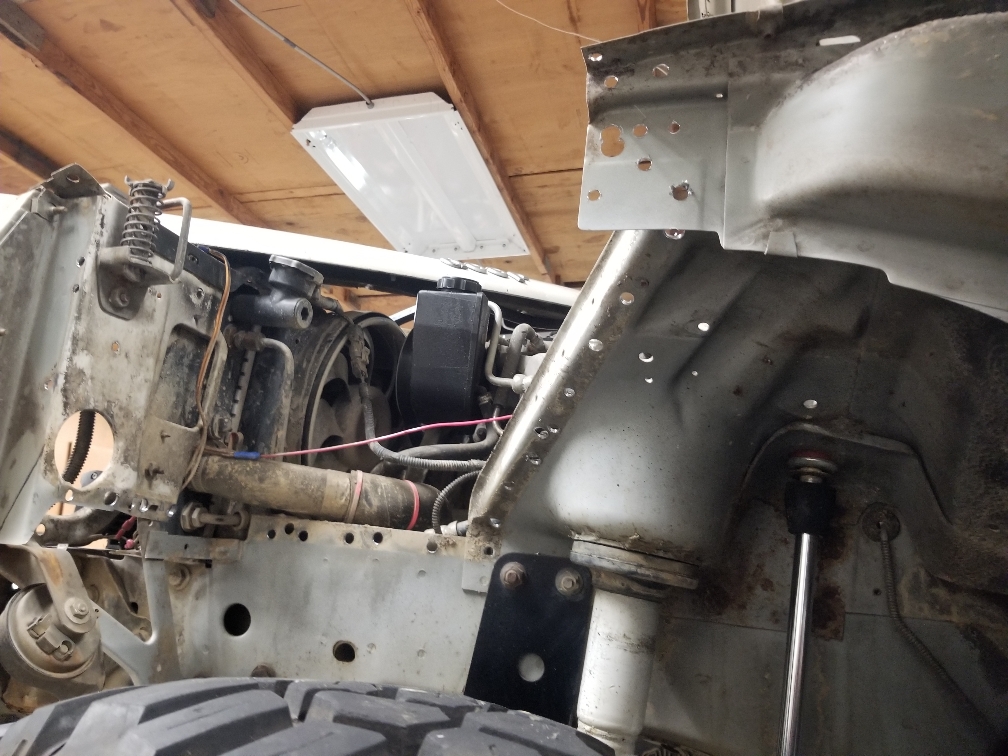

What size lift are you on? With 31s that seems like over kill IMO. Can your tire even go up much further? Like, when does your track bar get into the oil pan? Or the opposite side unseat a coil? Or the shocks bottom out.. I get low cog with low lift, but usually that entails bigger tires before you need to get into the inner fender. Maybe add an inch or 2 spacer to your lift? There is a lot of structural integrity in that inner fender... do a good job plating it with that stock bumper and no unibody stiffeners/ plated uni up front.

Um... ya the tnt inners are sweet... i can't remember the other brand I've seen but I REALLY liked it. I'll do some bookmark digging.

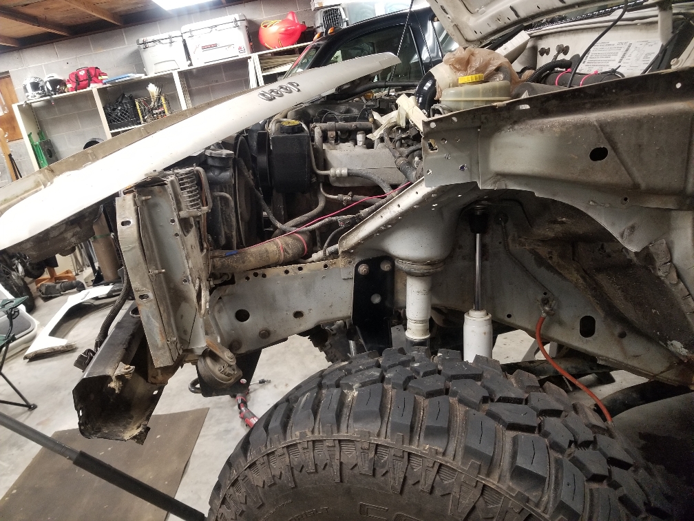

And since this would be more sucky without pics here's one at full droop.
Front frame stiffys and some kind of steering are next on the list.
undo your shock, i bet droops more.
There aren't many inner fender makers, can't recall other than TNT but I'll wait to see others.

and going up in tire size. structurally, the shock/coil mounts aren't far from where you're cutting although that rib from frame rail to inner fended should be good enough without reinforcement. so your're just trying to keep mud out of the engine bay.

Of course it drops more. With that said after new shocks I'll be right at my springs unseating, so I don't see myself needing much more.

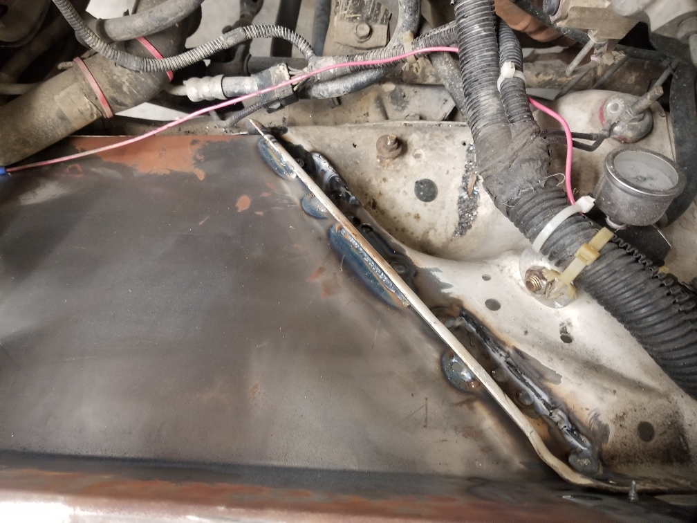

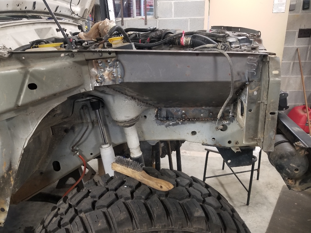

I have done both ways. Tnt inner fenders and just cut on the fold and bent it up and rewelded it with a small filler piece. Tnt turned out cleaner but cut and weld gave more room
How much space difference was it?

That is one clean build! Tnt has no info on the battery box so I planned to move it to the hatch, but yours looks like it works well enough. I'll probably shoot for something similar.
