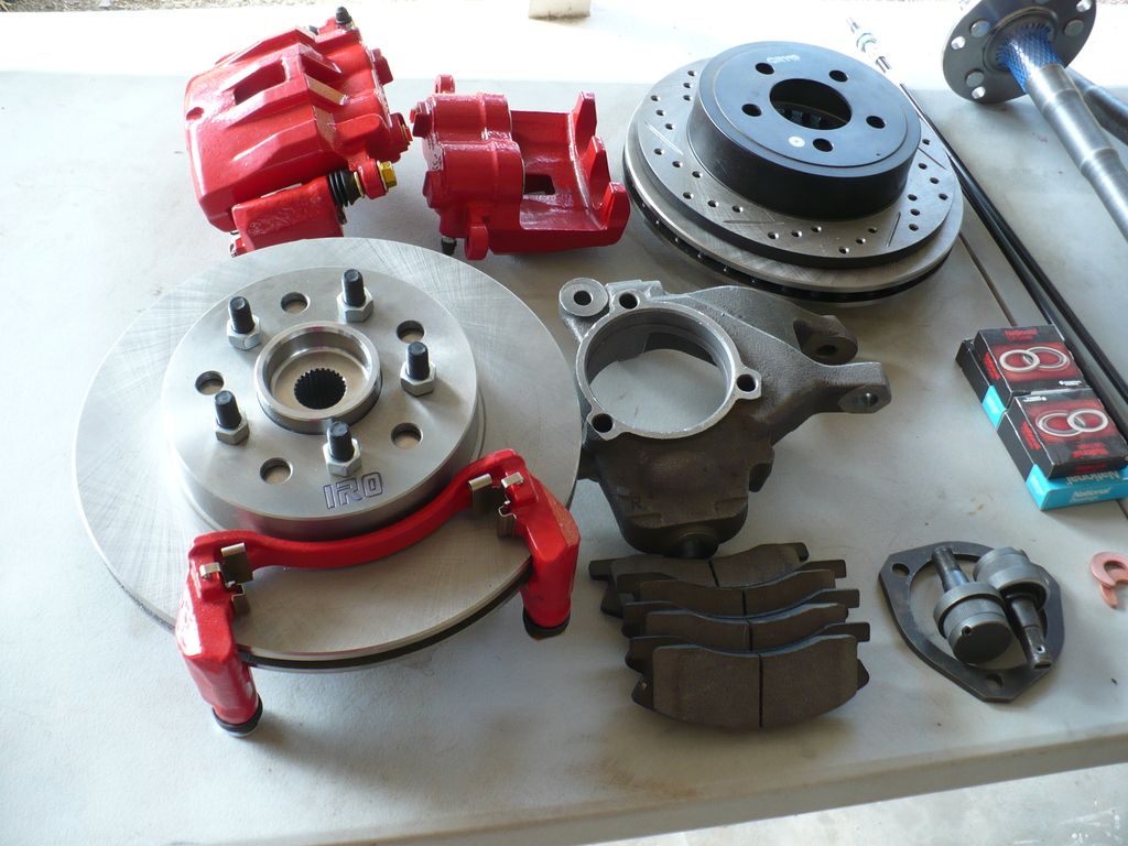

When I did the WJ swap I got the knuckles from a junk yard, -the calipers, rotors, brackets and ball joints, from Rock Auto,( I wanted to go with new stuff) and the knuckle spacers from JKS. I then got my steering setup from Ironman4x4 - https://www.ironman4x4fab.com/product-page/wj-knuckle-swap-kit.

I originally purchased new WJ knuckles from Crown but 1 was defective so I sent them back and got some from the local pick/n/pull.
