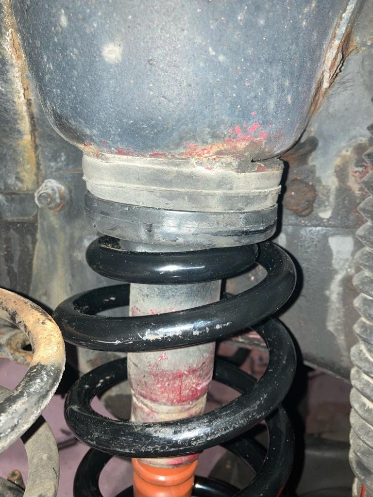

Think i figured out my rear end issue, the banging and the sagging.
Stock shocks have an extra 0.81” of length when extended vs kyb (20.61” vs 19.8”), but less compressed length (12.73” vs 12.95”). Travel length of stock shock is just over 1” more than the KYB (7.88” stroke vs 6.85”). Bad design on their part 😏 i’ll be calling KYB to complain lol. I suspect that paired with these leafs that have more free arch than the originals, the lack of travel is causing the bump stops to hit and possibly blew the shocks prematurely (<5k miles)
gabriel hijacker shocks i have on hand should fix the problem. They have a 7.73” stroke length, 20.77” extended and 13.04” compressed length up to 200psi max. I’ll have to get bar pin eliminators to use them or press the bar pins into the top eyelet
Oddly enough, the rancho monotube shocks listed for up to 1.5” lift have the same measurements as the KYB 🤨
JK wrangler oem shocks are an option according to a thread i found here circa 2009, good for up to 4”-5” lift if i press the bar pins into the top eyelet from the xj shock and press out the small sleeve in the lower eyelet. Tenneco monotubes rated up to 4300lb curb weight vs xj’s 3100lb curb weight. Should be able to find cheap takeoffs on craigslist or marketplace

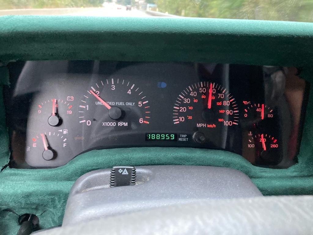

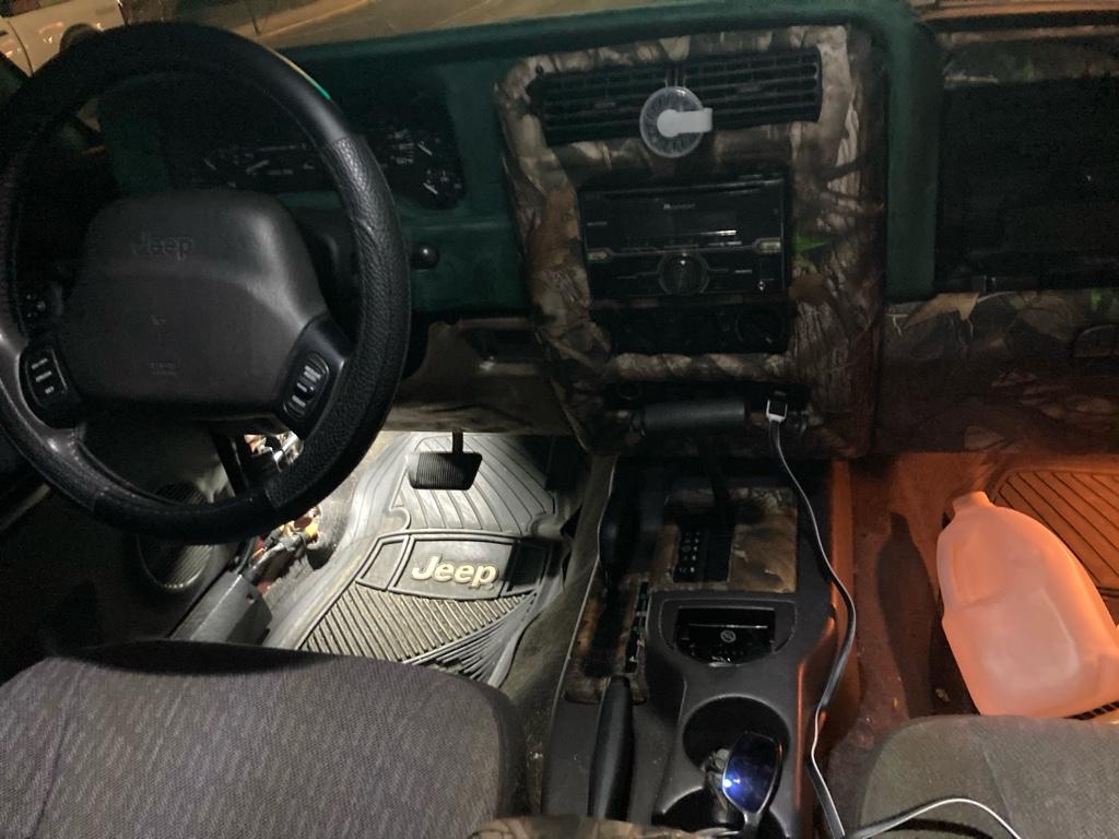

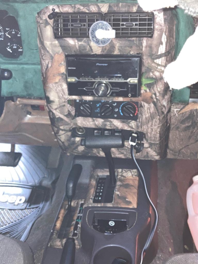

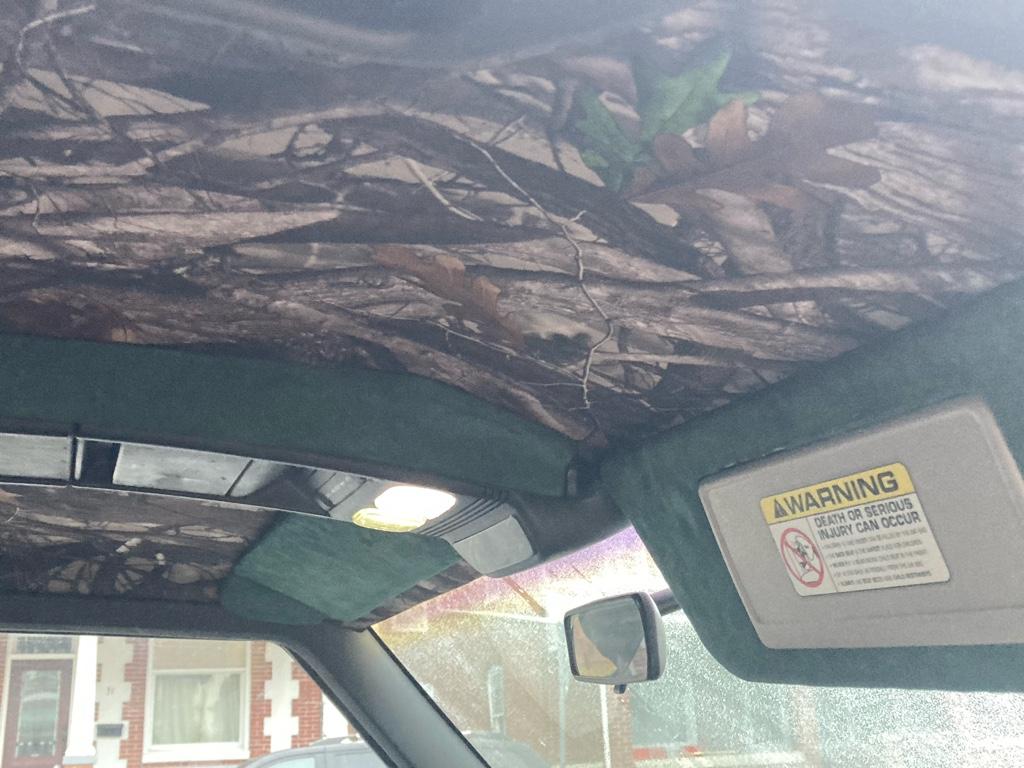

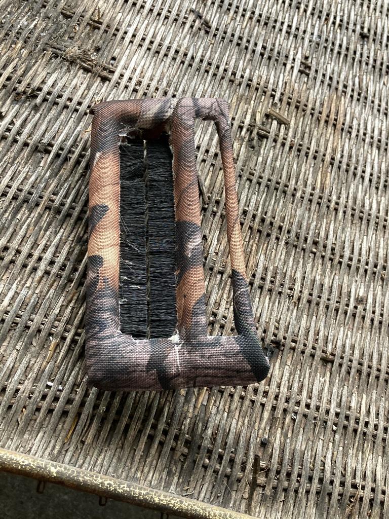

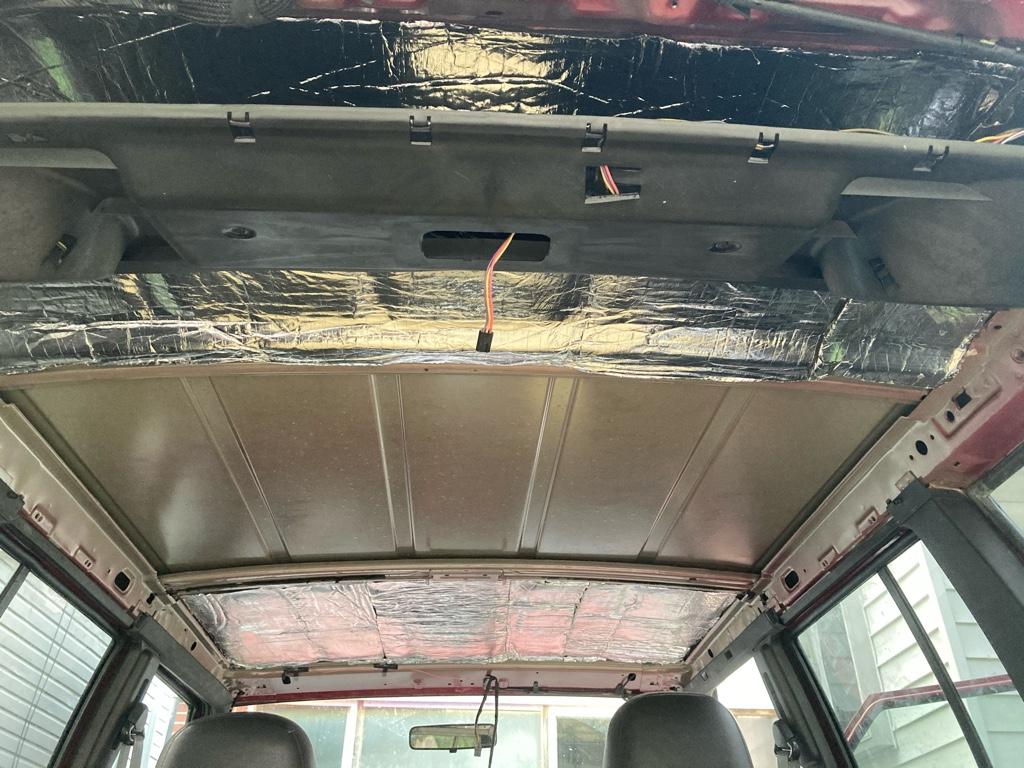

Thought i posted these pics but heres what i did on the dash/overhead console/visor upholstery. Visors got LED replacement bulbs. Cluster surround panel and dash top will get redone, not happy with the results (note to self; dont use gorilla spray glue dumbass). With the complex curves and cutouts, its a pain in the ass to wrap and relief cut the fabric properly once laid (mainly for IC opening and the hump over top the cluster)
Probably wrap the gauge pod in green to match visors and pillar trim once i get around to the pillars.

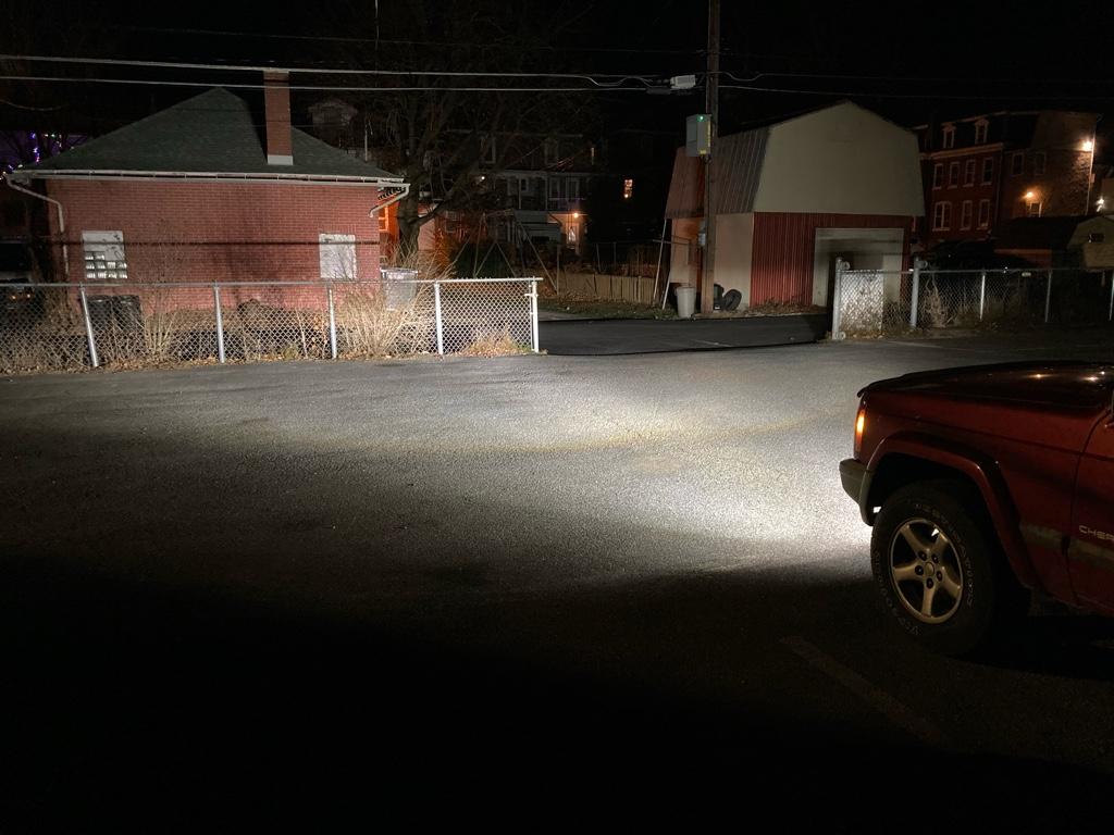

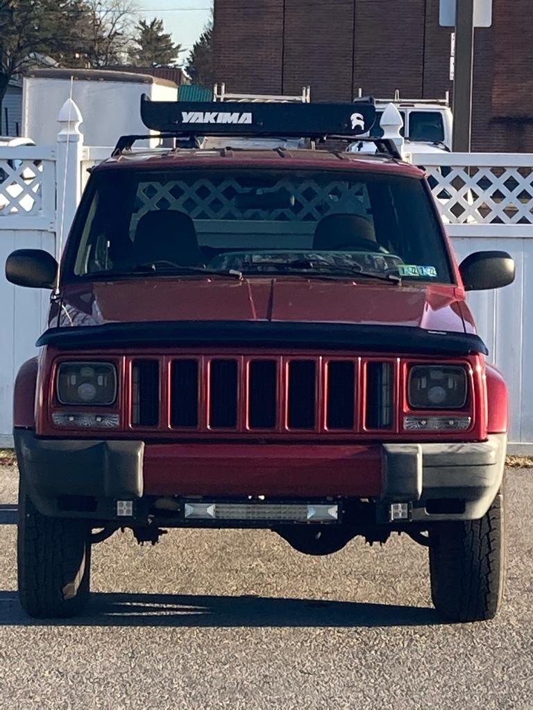

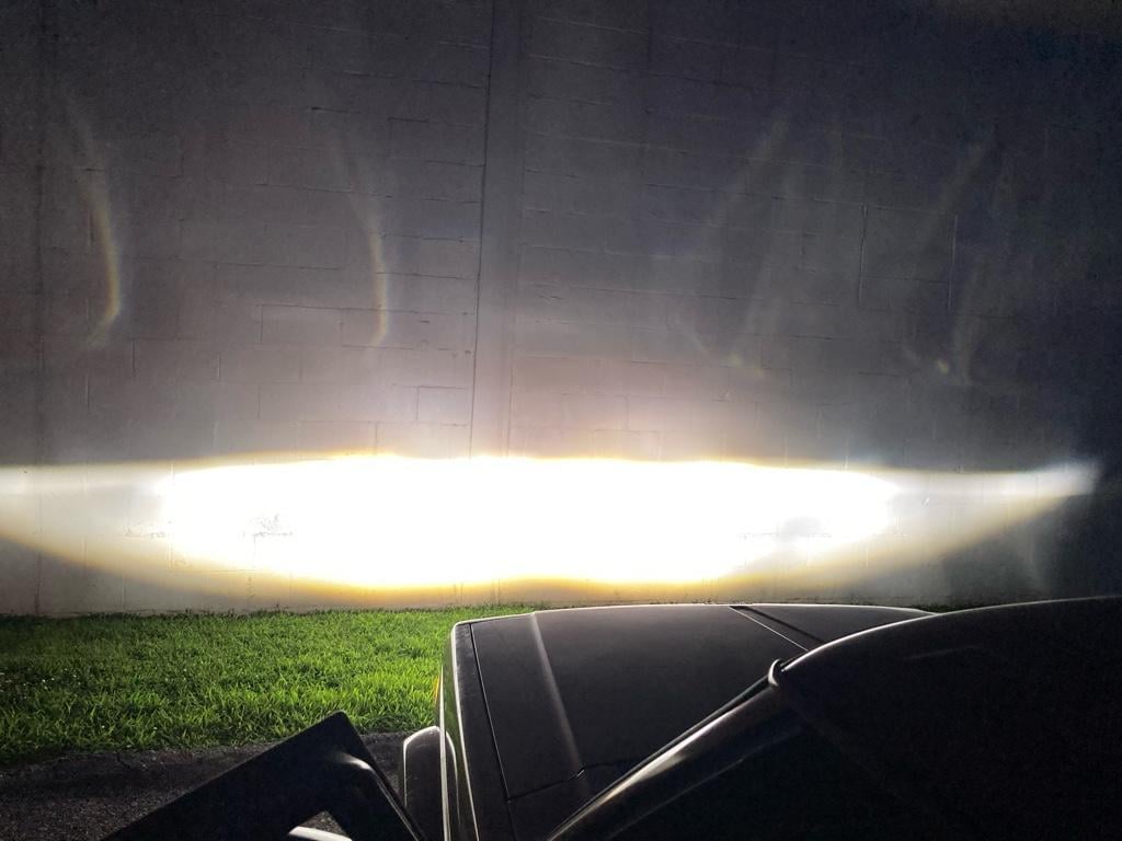

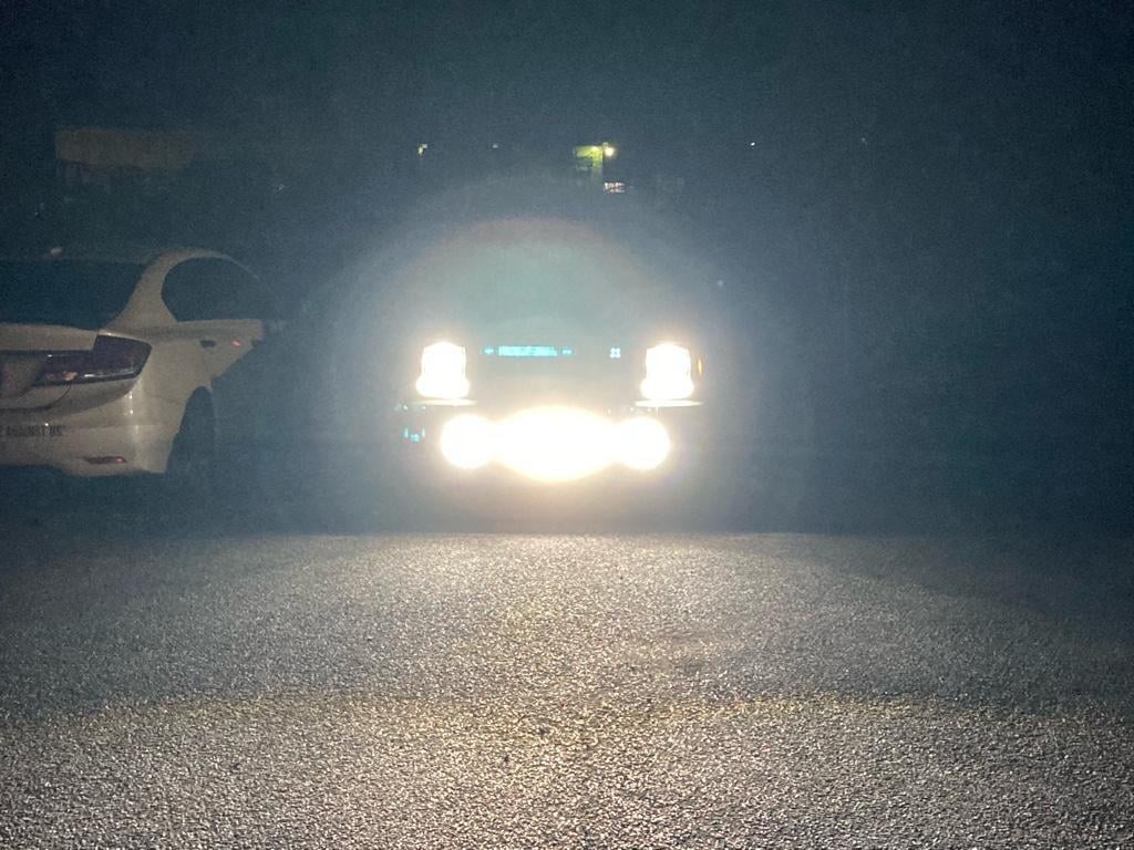

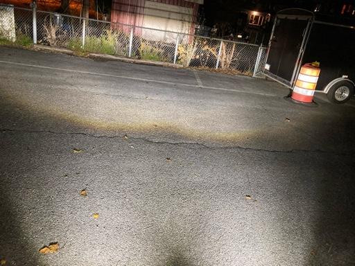

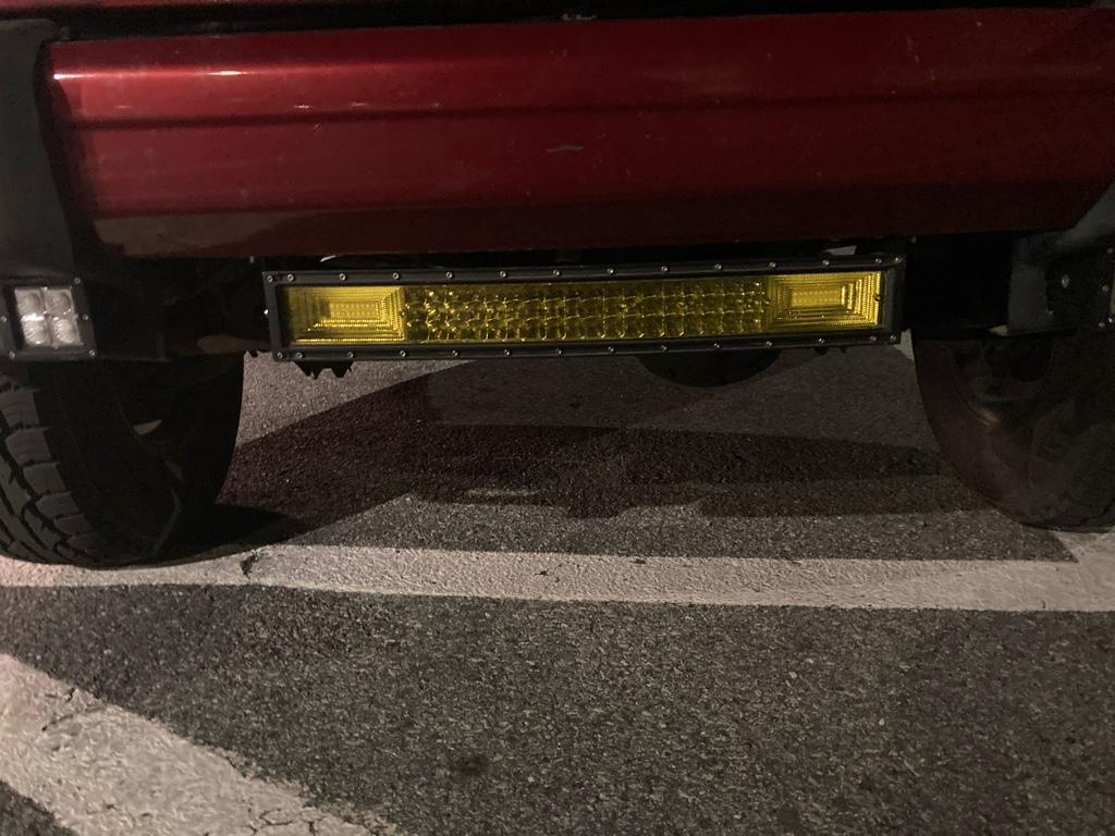

Night time lighting shots from in cab (led headlights and cubes, prior to clear markers and light bar). On road performance isnt quite as good coming off the cubes, they are really only good for throwing light upwards onto signs and for use as city lights with clear markers/switchback LEDs on
And after the light bar/clear markers. Also shots/vid of the rear led lighting conversion.

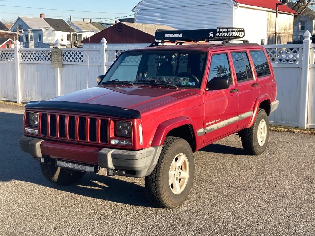

Last pic dump for the evening...
