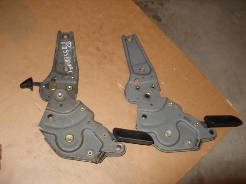

I had read somewhere that the interior dimensions are the same between a 97 + 2 & 4 door. So they must be the same. I was thinking of installing the seats I have for now since my little one is nowhere near of age ( 20 days old) to be in the jeep yet (No AC or heat). I’ll keep an eye out for the time being for the fold down seats/brackets off a 2 door. Goose’s link explains how easy it would be to convert the seats down the line.

I've read that the folding brackets will swap to four door seats, so I'm about to try it myself pretty soon. Otherwise, yeah. The back seat becomes a catch all for crap. Small children can climb the console.

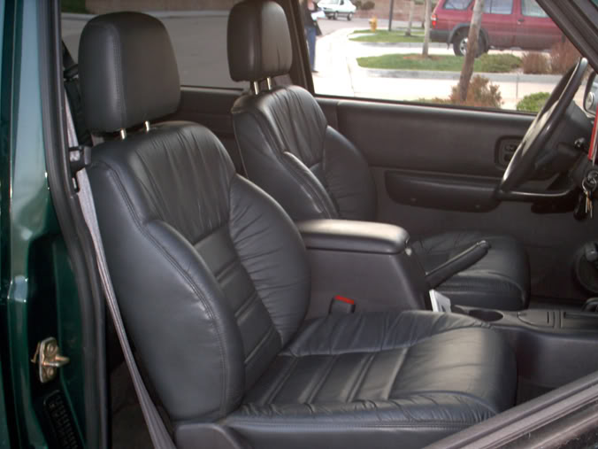

I've done this, kind of in reverse.
All 97+ carpet is the same, no difference. Seats just require the side bracket from the '97+ 2 door. I put '96 country leather in my '99 2 door.
Perfect Kittrell, that answers my questions.
