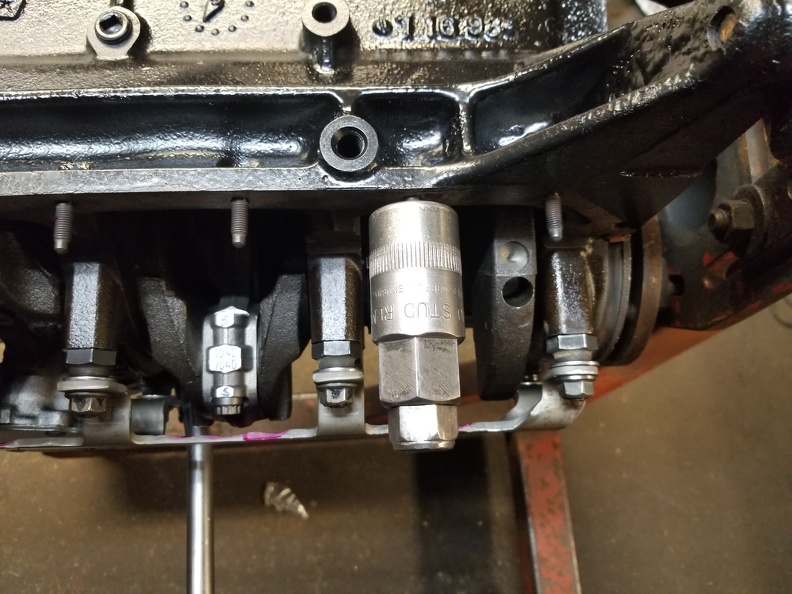

On Renix blocks, the Russ Rods get really close to a boss cast in the block for the knock sensor. On some blocks you do have to grind the back of that boss.
This isn't a renix block, and we have miles of clearance, but you can see it here.
We did have to clearance it on the stroker for Dallas's MJ that we built last month.
