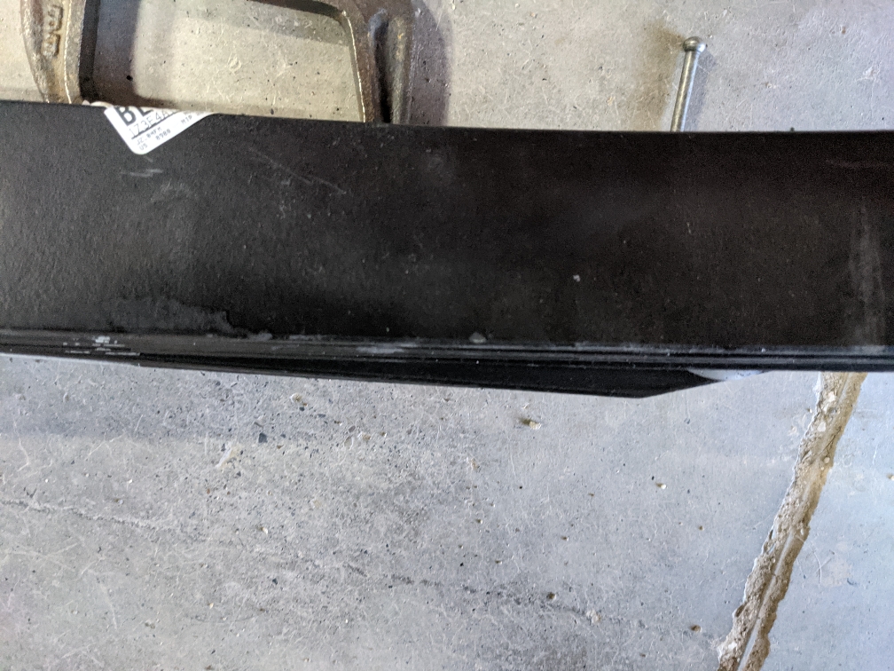

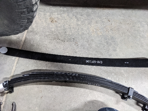

Got new 4.5" leaf springs from IRO and the add a leaf to go with (total 8). Having not done this (AAL) before...
Might it be easiest to install the spring pack on the XJ then add the leaf in it's appropriate position? Thinking mounted up would give a more solid 'platform' to do the work. I might or not have another pair of hands.

These AAL are from IRO and an option with the leaf pack that fit between 3rd and 4th leaf making it 8 instead of 7. Not just a stub added to the bottom of the pack or such.
That seems like a full/complete pack with an extra leaf rather than piecemeal AAL, no?
https://www.ironrockoffroad.com/product/iro-spring-add-a-leaf.html

From IRO ........
Specifically designed to work optimally with the IRO 3.5" packs to acheive a slightly taller stance and even better load capacity. Expect 1-1.5" lift when adding these to your IRO leaf packs. Included with the new leaf packs are new center pins for easy reassembly!
That means the spring rate will increase thus making the spring less "flexy".

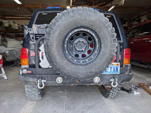

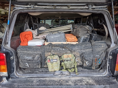

Yeah, I spoke with IRO before making this decision and gave them a list of the junk I have on/in the rear of the XJ. He suggested the AAL might be the ticket.
JCR bumper - spare tire, high lift, 2 RotoPacs.
ARB compressor
Gas tank skid.
Recovery gear - lots. We do quite a few recoveries with our group, and on a moment's notice.
Tools: Sawzall, bottle jack, chainsaw sometimes, impact, hand tools.
Tire chains some of the time.
Fluids
Cooler
All this stuff is back there whenever I hit the trail. I'd estimate at least 100#, maybe closer to 200, just for cargo. And I prefer it all in the back, behind a net, to keep it off my head. My current OME springs seems a bit squishy, possibly due to over doing it with a missing bumpstop.
Then, if things go well, I'll be loading at least half an elk or a muley back there now and then, and we're allowed off-road to recover game. Add a couple passengers - in front of the axle, tho'.

Lotta load.

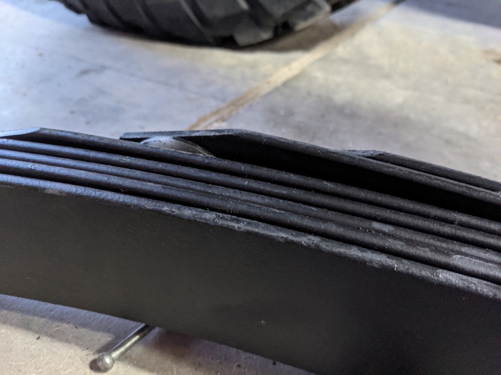

I would install the leaf packs first without the AAL. If you decide its too soft, then the AALs can be added with the leaf pack still on the Jeep.
Whether you do it on or off the Jeep, you'll want to get a pair of wood working clamps with at least 4 inches of opening range.
Put the clamps on the leaf pack, remove the joining pin, and then loosen and remove the wood working clamps. Some leave may want to fall down. Don't loose track of ordering or orientation. You could add a zip tie or string loosely around the leaves before loosening the clamps.
I've done this with the leaf pack on and off my XJ, and it was easy either way. If you do it on the XJ, you'll just need to be sure to be able to drop the axle far enough out of the way to be able to remove the pin.

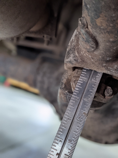

Wedges: No, I don't have any in hand. But, I'm going from 3.5" (actual, unloaded) to 4.5" lift and will measure lift after new springs to verify actual. Currently there are wedges in there, 3 or 4* if I remember (which I don't), and hoping the 1" added lift will not matter as far as pinion angle. Have never had any vibration or other issues at any speed. I guess I should measure that before and after as well.
I've done that on my muscle car, not the XJ, and the only way I remember is to get the measurement off the face of pinion seal.. correct? If there's a way to get it without dropping the driveline I'm all for it.. call me lazy. Another reference point maybe? I don't suppose measuring the driveshaft angle is accurate? Wouldn't kill me to check my u-joints closely, I suppose.

There are some attachment points on the C8.25 diff housing that create a flat surface parallel to the pinion shaft. Do you have a magnetic angle finder? Those are handy for this kind of measurement.
For a pint of reference, I believe that mine have 2.5 deg wedges, and I have about 3 deg between the pinion and drive shaft which is a very reasonable value.
Magnetic angle finder: Yes
Will have a look see for a flat spot for pinion equivalent.
Then just stick it to the bottom of the driveshaft, record and subtract?
Thanks.
Straight edge on u-joint surfaces @ 16*. Driveshaft at 13.5*. 2.5* pinion. Make ANY sense?
