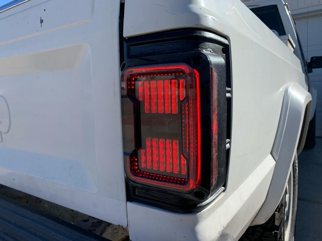

Those of you who would like to replace the hard to find stock taillights may wanna take a look at the boxes I made for the SFR Lab Rat.
Here's the thread from the other forum. I'm planning to make these parts available if there's interest.

I won't say no, because I build a lot of things I never thought I would, but I will say it's very doubtful. The MJ is a pretty small market, and really the only reason I designed these at all was to put them on my own rig.
I don't think you're really gonna find much else that fits. Once you account for the radius at the corner there isn't much flat area on the back.

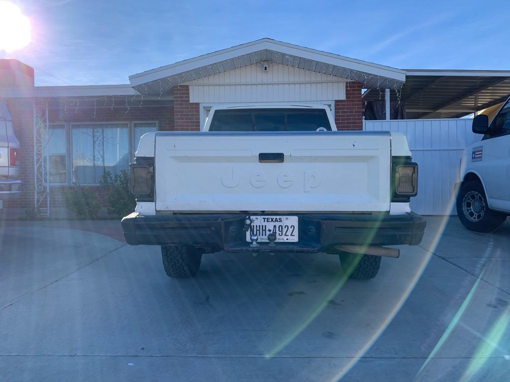

I have a pair of rustys that same setup but there's screws in to factory holes, I prefer the smooth look so I chose to weld then do body work. Here they are installed as suggested with screws
Sent from my SAMSUNG-SM-G890A using Tapatalk
Can you post some better angles of the side contour curve? That is what made me by rustys instead of fabricating them myself, they done a perfect job of following the body line in that regard, just seemed I couldn't ever get it right when I tried
