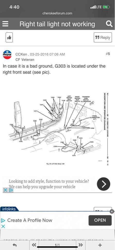

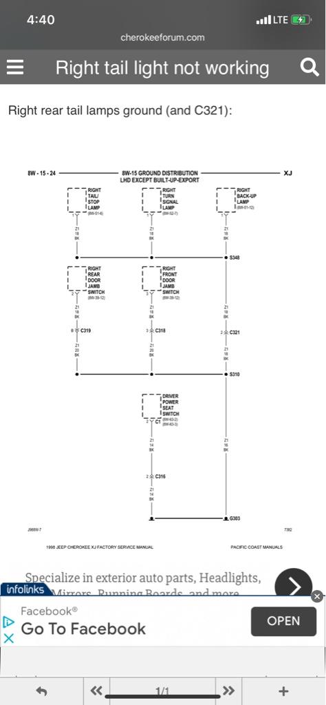

So I am having an issue with my 99 Jeep XJ. I fixed some bad wiring in my rear hatch bend that fixed some issues, but I still have one that I can’t figure out. So my passenger blinker blinks fine until the brakes are applied and then it blinks twice as fast. I was able to find out that it would stop whenever the passenger door was open(whenever the door jamb switch wasn’t pressed). I am sure it is a ground issue but am not sure where else to look. I have the led the connectors and grounds behind spare tire location in the back. I have also checked the connections and bulbs and they are all good. Any help would be appreciated!
