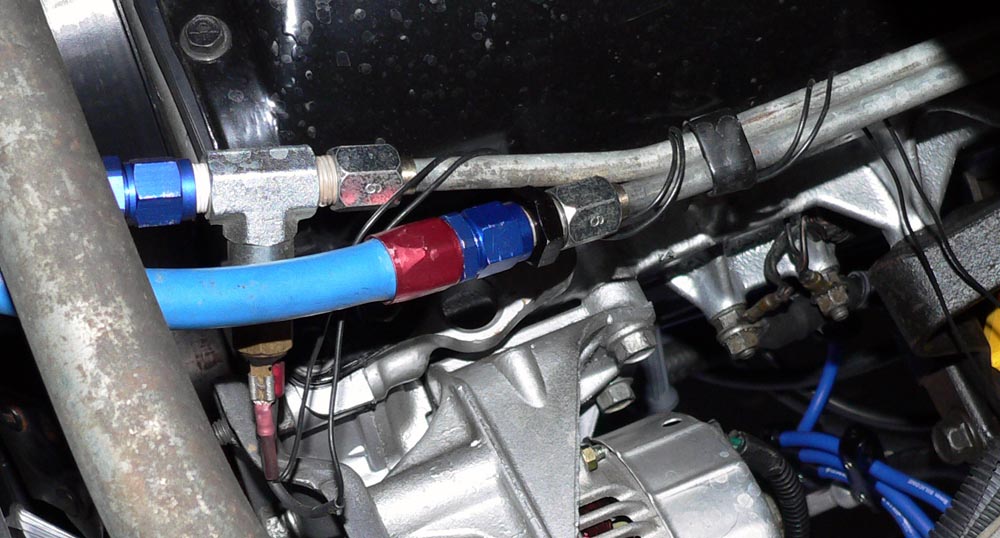

It's goes both ways depending on what your trying to accomplish! The SS lines provide extra physical protection from abuse and nobody complains about their SS brake hoses. If you want to go with cloth you have to make some sacrifices but it's still a good hose. Here's some black cloth hose I used on another project.

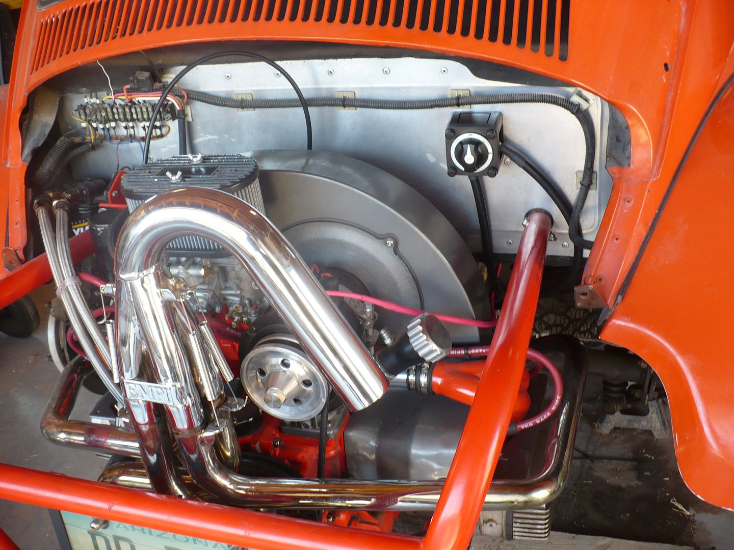

So what size is your VW motor? what does it push around, a Bug?
Serious about reliability with two coil clamps! I like that.
tell us more about this cool motor!
"Dr Dirt" is a 1968 baja bug with a 1955cc stroker!
