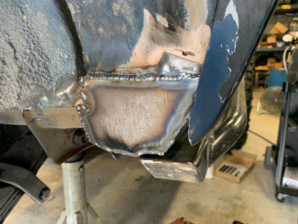

89Mock - It is easily doable - if you bump stop. I have lots of bump stop, and have done a lot of inner fender trimming for more clearance and up travel . I modded my front inner fenders -as well as did some extra trimming to the inner wheel wells of the rear. It is definitely doable. I am running a D44 front with RCV axles and WJ knuckles, and a Ford 8.8 rear with the Yukon C clip eliminator kit. I did run the 37's for awhile without these mods and it just did some rubbing .
Here is what my front inner fender looks like now.
I also did some more trimming on the lower inner fenders, cutting off lower pieces, moving it back and welding in small patch panels where it was actually open to the inner body.
