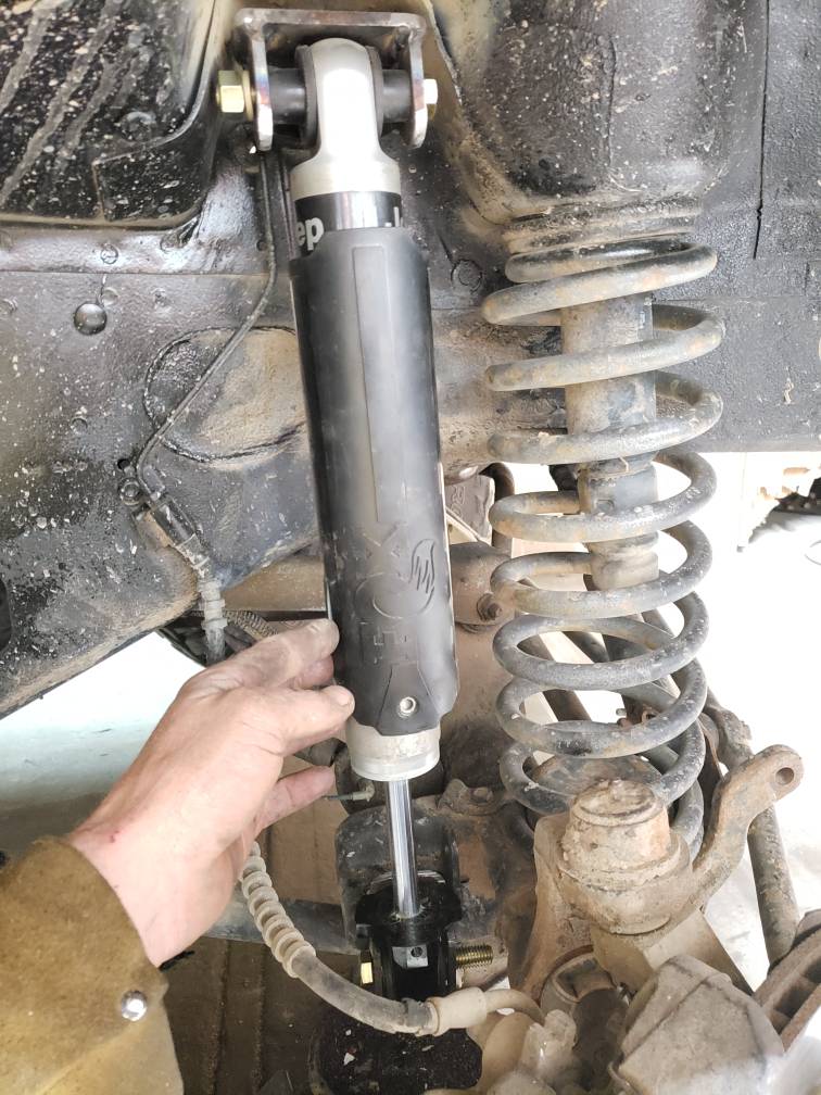

Scored some decent shocks . At least I hope they're decent
  #82
Old April 3rd, 2020, 16:14
Evan03 Evan03 is offline
Join Date: Jun 2017
Location: Idaho
Posts: 576
Suposebly shocks and coils off a Rubicon
Coil on the left is a factory xj coil. These front coils appear to be same length as xj. Though I'm sure different spring rate
I'm trying to pull part numbers off shocks and coils so far with no luck.
The shock in hand seem to get stiffer valveing at about half stroke. Wich I like. I'm also kinda liking the dust covers with holes in bottom for debris to get out of.
Pretty sure these shocks are designed to run body up.
I'm beside myself as these look like will be a good match on my xj

Start with the basics, what are the extended and compressed length's?

23 and 17.5
8" stroke. Roughly 3" longer compressed than what I have on the rear.
Fabbing a bar pin elimanator eats up a couple inches ugh

Poops I was wrong. Rears are 26ext 17.5 compressed
I better just cool it with the shocks already been eyeing the rear fenders thinking about mounting shocks on top of spring pack.

Those are probably to long, even if they had the right stem/bar-pin mounts. You would need the make adapters on both axles which would mean even a shorter shock.

I looked up the specs for what I run. At 5.5" with all factory mounting and the proper bump-stops I run these.....
Front - 15.867"/25.875"
Rear - 15.125"/24.00"

Rcp these fronts are roughly the same measurements as yours. Looks like fudging mounts around will get them in.
Hope these shocks are worth it. I'd never be able to afford 700 dollar shocks that bolt on.
Actually think the rear will be easier once I get up the nerve to bring them through the fenders.
Then 2019 Rubicon shocks will be bolt ons.

Your going to be bottoming those shocks out. Instead of whigger rigging those in, you should focus on doing things right. Right now you have serious safety concerns you should be working on, example I could play a tune on your brake lines!
