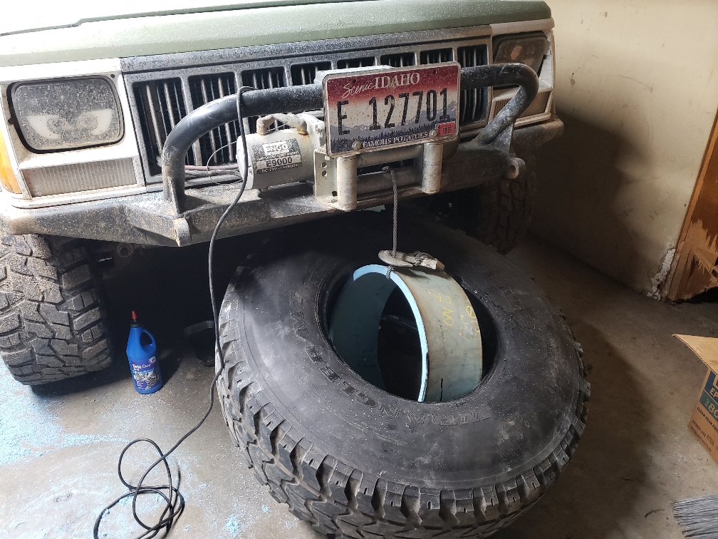

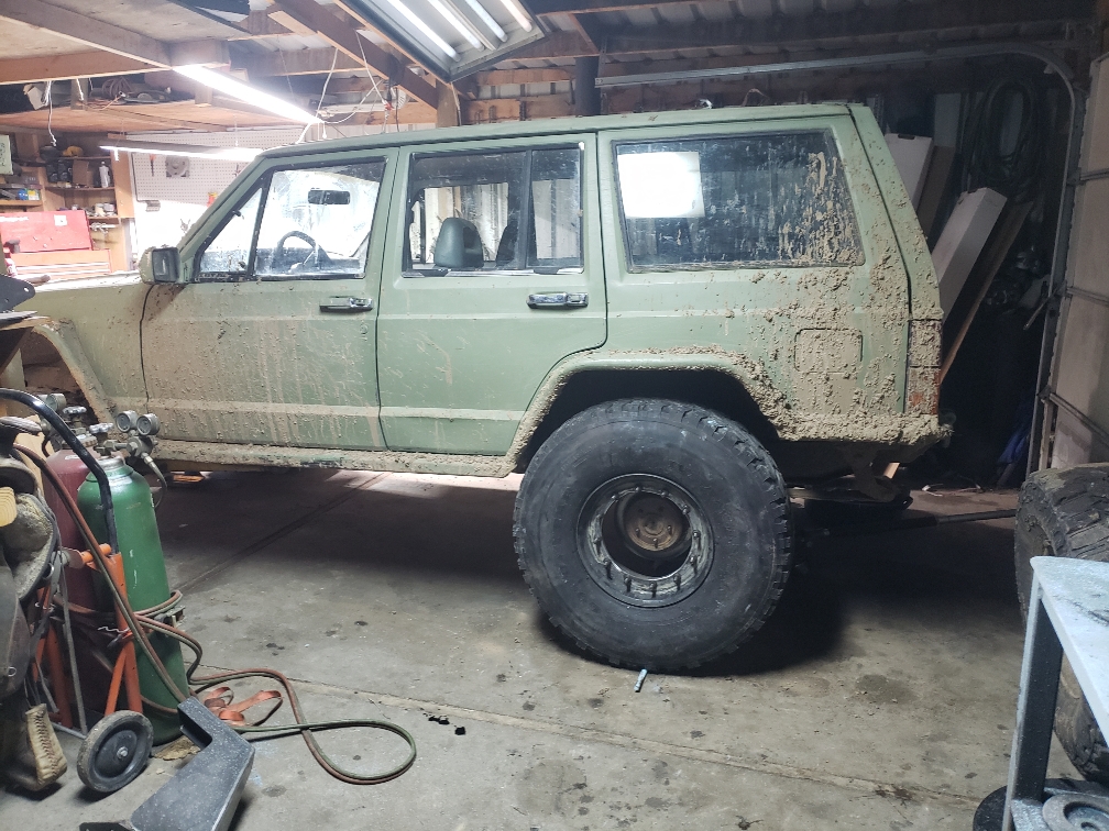

So I was getting a tire wear pattern not necessarily a pattern but noticable wear that i could see.
I thought it looked like to much toe in i thought I had just a fuzz toe in 1/8 minus.

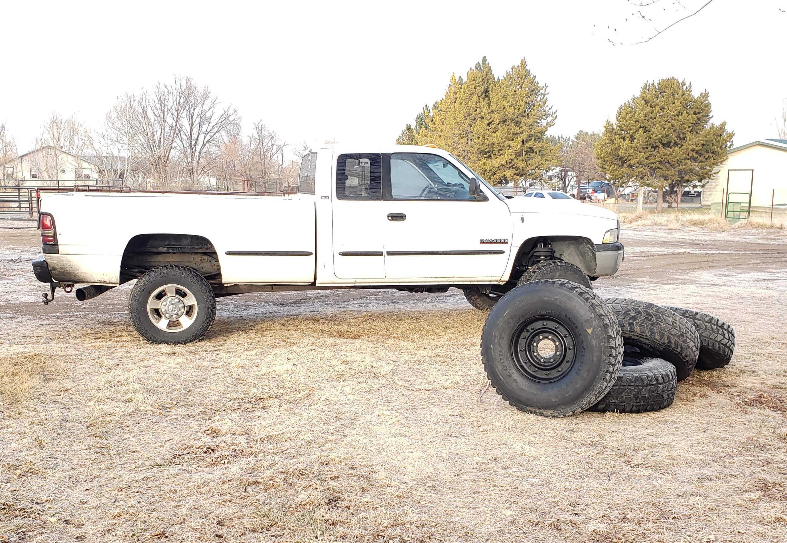

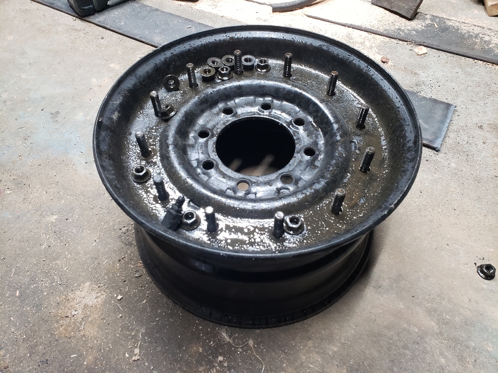

Decided to break done my othere wheels to use to measure toe
I was shocked to find i was toed in just over an inch.
I reset toe triple measured and set it at 1/16
Thats about it.

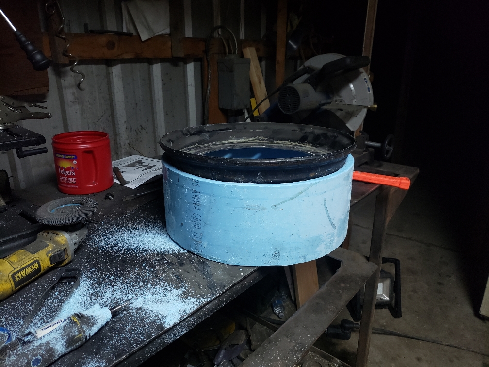

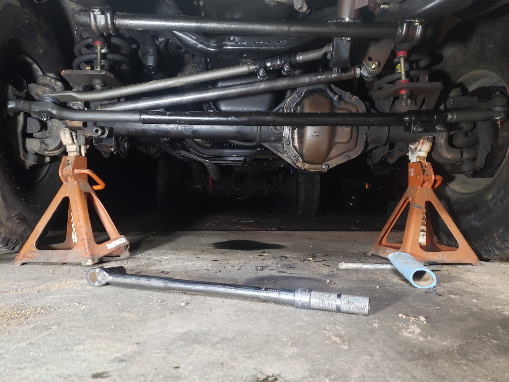

So after a few hundred miles my lower control arms started moving side to side at the axle. Tearing it down now and widing bushing slightly. I was unable to tighten bots nd get rid of it.
Brcket width is 2 5/8" poly bushings I made also 2 5/8" now a slight compressed 2 5/8"
Man it never ends.
Yes i tried to catch them on fire but failed.

I think it was more that I made bushings exactly 2 5/8" wide. You could grab the bar and clunk it side to side had less play then the thickness of a 9/16 washer.
I ran a weld around the end to widen them slightly so they're a snug fit.
I can't clear a Jonny joint or 1.25 heim in my bracket
Might be able to see where I welded to widen it. In the picture. I can clear a heim in the lower hole but I like upper because arms are pretty flat.
These are cheap poly bushings off ebay that may also have something to do with it.

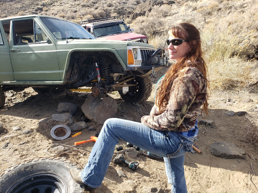

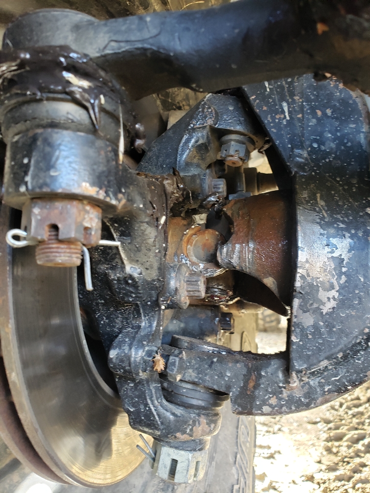

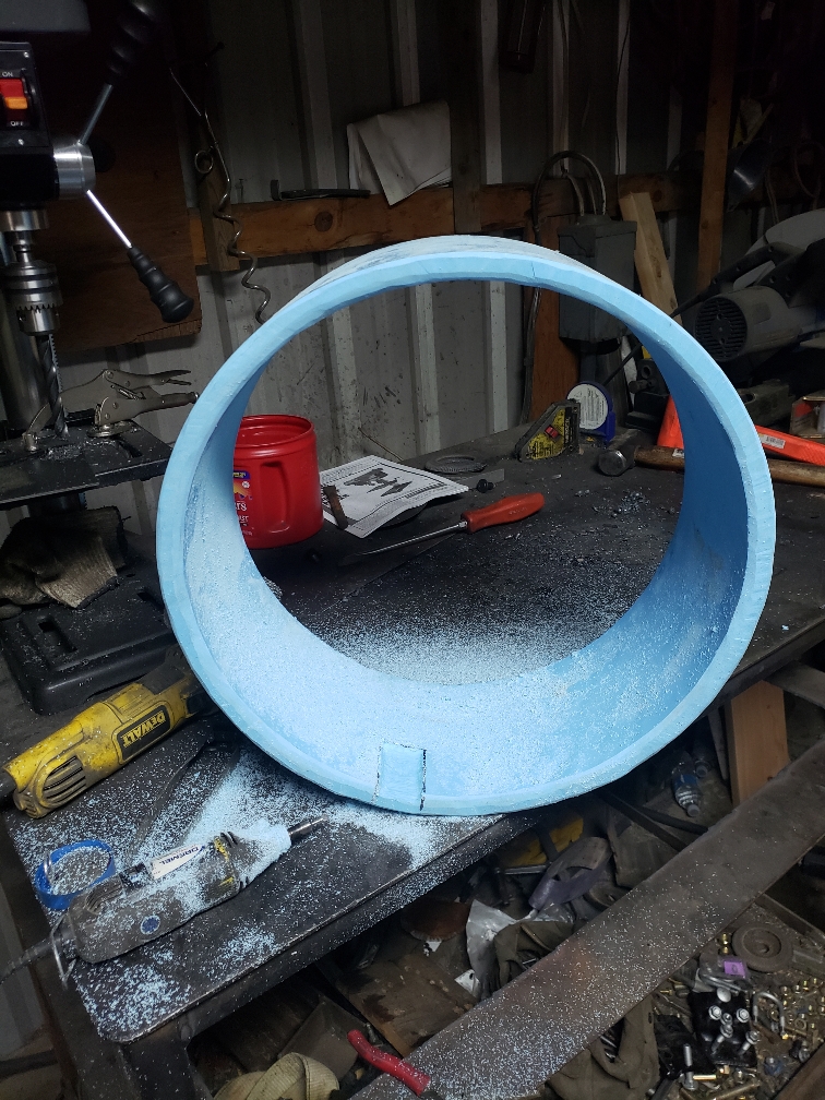

Stage 1 steering reinforcement
And offcourse misc pics definitely not pretty but its glued on.

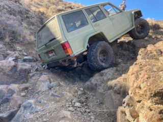

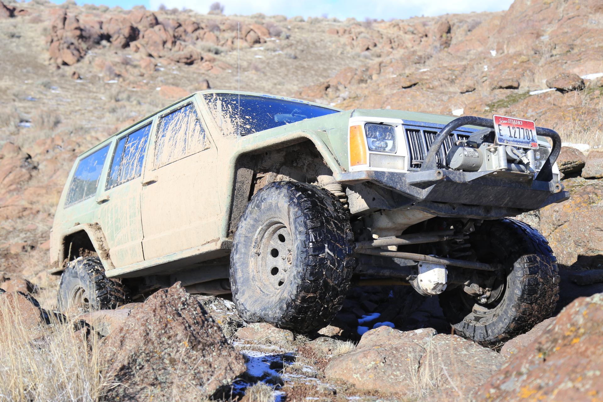

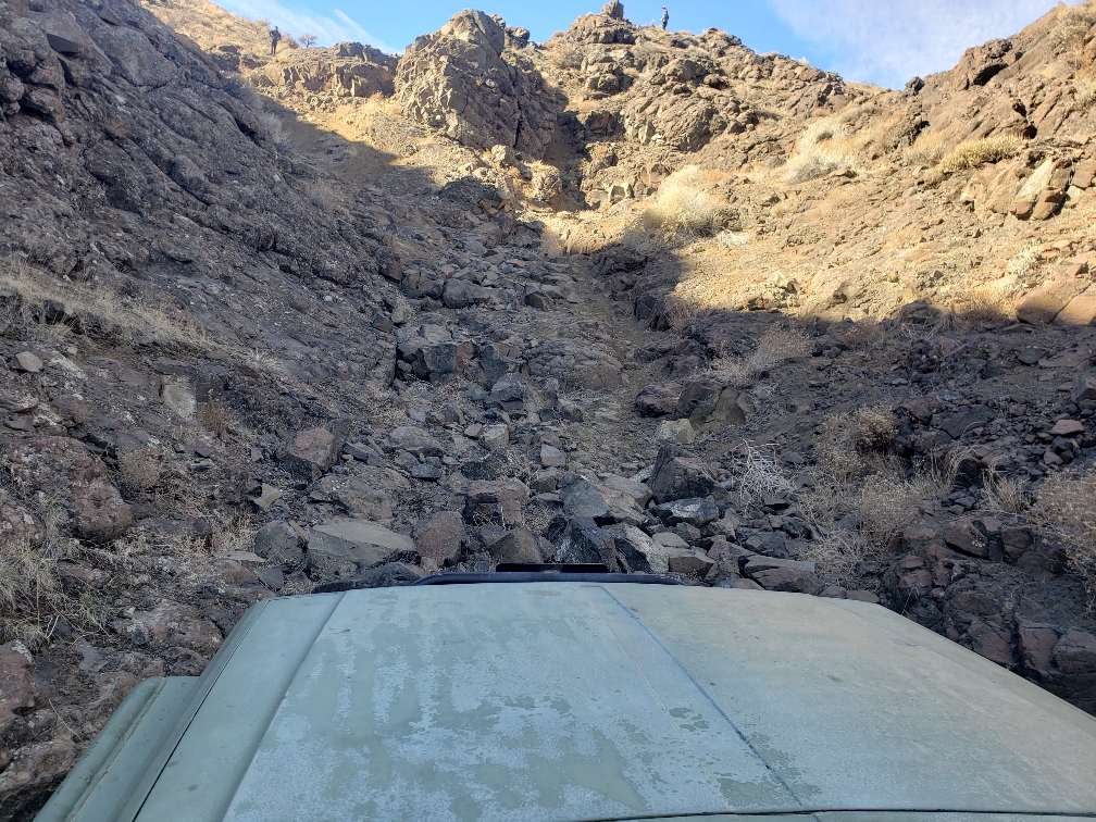

Last pic is a old forgotten trail. tested lower arms sliding over rock's just about drug out the winch then pivoted around on a rocker and crawled out.
Got home and did the inner frame plate.
