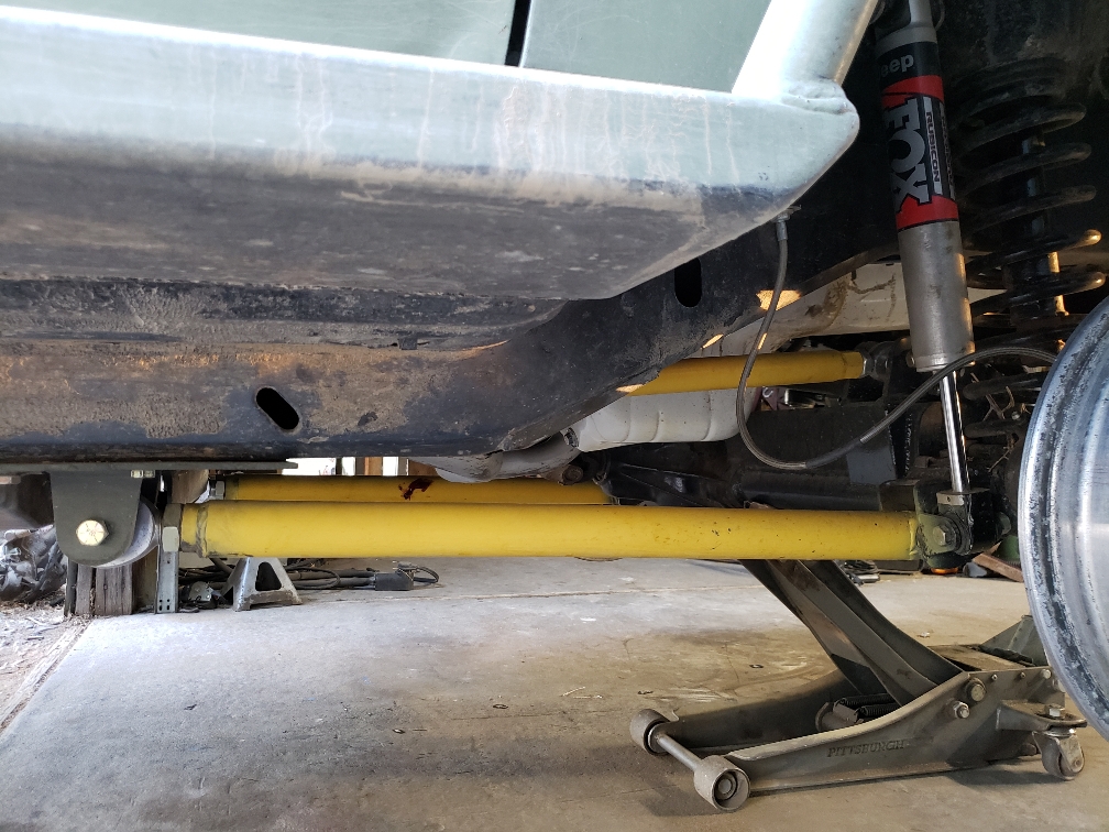

My arms provided a night and day improvement in rude quality on rd and washboard rough stuff.
Sfr arms will look very similar just alittle more angle .
Stuff that used to make me cringe with short arms. Is now fun to hit at speed.
