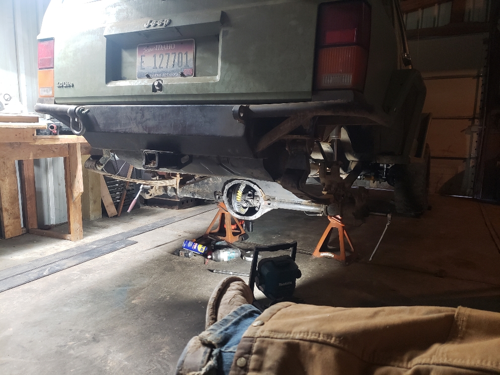

Guys I'll be real with you.
I ****ed up, maybe so bad I can't even pin point wear.
Things I know. She got hot she locked up for a split second at 65 lurched sideways I thought it was clutch transmission. Rodeod her down coasting to a stop
Kinda regrouped still had motor clutch and transmission.
Dana 30 and grizzly then had a tough task minus one inner shaft. Toss it 4wd make the right turn off the freeway welded rear still holding one front squealing rear rumbling. At this point I know I've screwed up. doubtful it let loose for any othere reason than me being at error
Ended up getting a trailer rear was rumbling way to much.
In the garage now recouping seems to much damage to point to anyone thing.
Bad gear (me)set smoked bearing then they loosed up and grenaded letting loose all together of ring gear.
Got so hot the pinion shims are gone.
Anyways getting back on the saddle have a another gear and bearings set will clean shapernel from houseing and see if I can get it right this time.

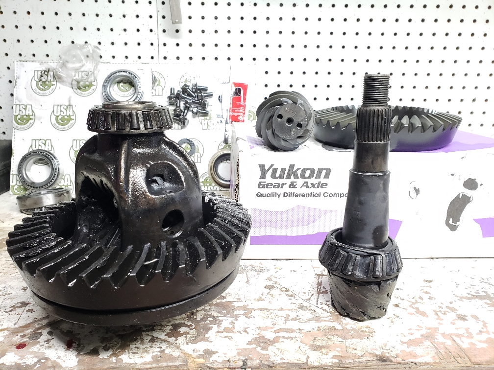

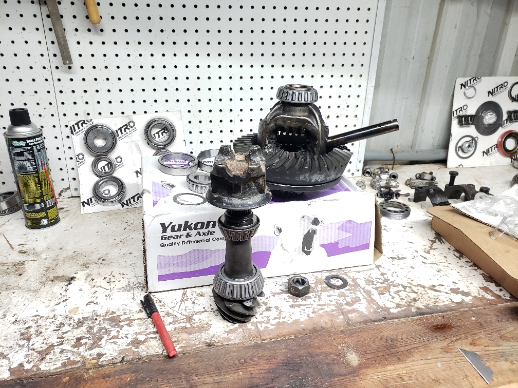

Made good progress.
All races punched out. New bearings on carrier set up bearings on pinion.
Gota make center pin fit then start trial and error
Not sure of I should grind pin or ring gear tooth. Last time I ground two ring gear teeth to fit pin.
You'd have to grind a lot of crosspin to make that work. Failure didn't come from a couple short ring teeth

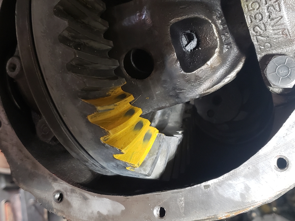

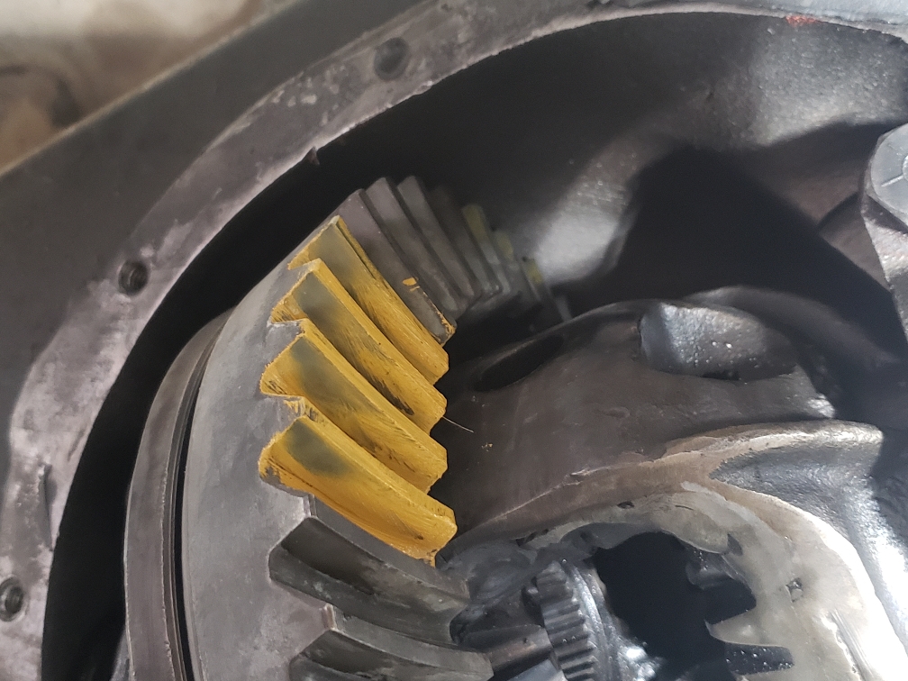

Getting ready to run a pattern backlash is a tight 6.
Decided I don't like the 8.25. Its much easier installing carrier shims than these damn side adjusters
You’re the first person I’ve heard admit this. Side adjusters are much quicker than stacking while I think.
  #10
Old February 24th, 2021, 06:05
RCP Phx RCP Phx is offline
Join Date: Mar 2003
Location: Phoenix,Az
Posts: 14,560
Re: Guys I'll be real with you.
That may be why the gear-set failed!
