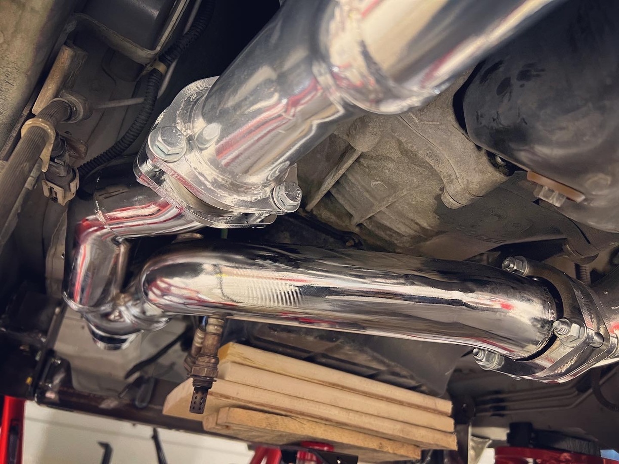

Headers are in.

I guess you can still replace the starter by tilting it and bringing it out at an angle?
For sure no, you actually have to loosen the the header to get the starter out. Not optimal at all but I've never had a starter die and I installed a brand new one with this mod.
