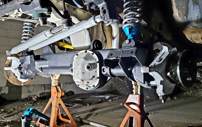

I installed WJ knuckles/brakes with OTK steering about 12yrs ago and this was one of my favorite mods. I opted for weld-in tapered inserts, where you drill the knuckles out, hammer in the tapered insert and then weld them to the knuckle.
You can also see how I positioned the swaybar link axle brackets, which are welded to the inner C gussets.
My build thread has more details ------->https://www.naxja.org/forum/showthread.php?t=913774

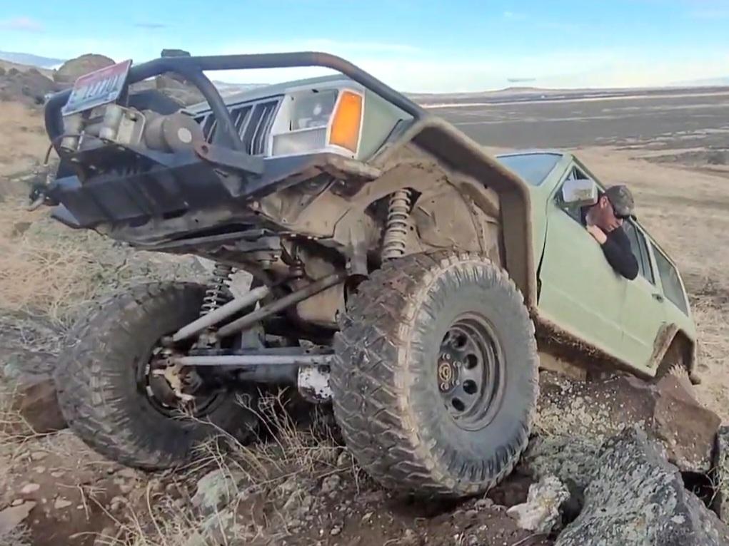

Xjeeper.
I like how you have the sawbar on the c gusset.
I to have found wj steering to be a very worthwhile investment. Been using the inserts but finally bought the reamer.
This jeep steers freaking amazing. Can bash badger holes at 50 while eating a sandwich maintaing control.

Who's trackbar brace is that? Or did you fab it? Does it attach to the Driver's side frame? or the Trackbar bracket? Nice setup. And people do the WJ Big Brakes for the 'Bigger Brakes'. Yet they rave about the crossover steering upgrade. I like mine. Hands off at 55mph or higher and tracks straight.

The steering is awesome angles are much improvement
Steers quicker more responsive doesnt wonder far less flex steer.
The steering realy helps a good suspension work even better.

The trackbar brace is my own design/build and connects the passenger frame to the trackbar frame bracket.
The benefits of the WJ brake/knuckle swap is both improved braking and a much improved steering experience, as it eliminates the stock Inverted Y steering geometry, which is prone to bump steer on lifted rigs. :thumbup:
