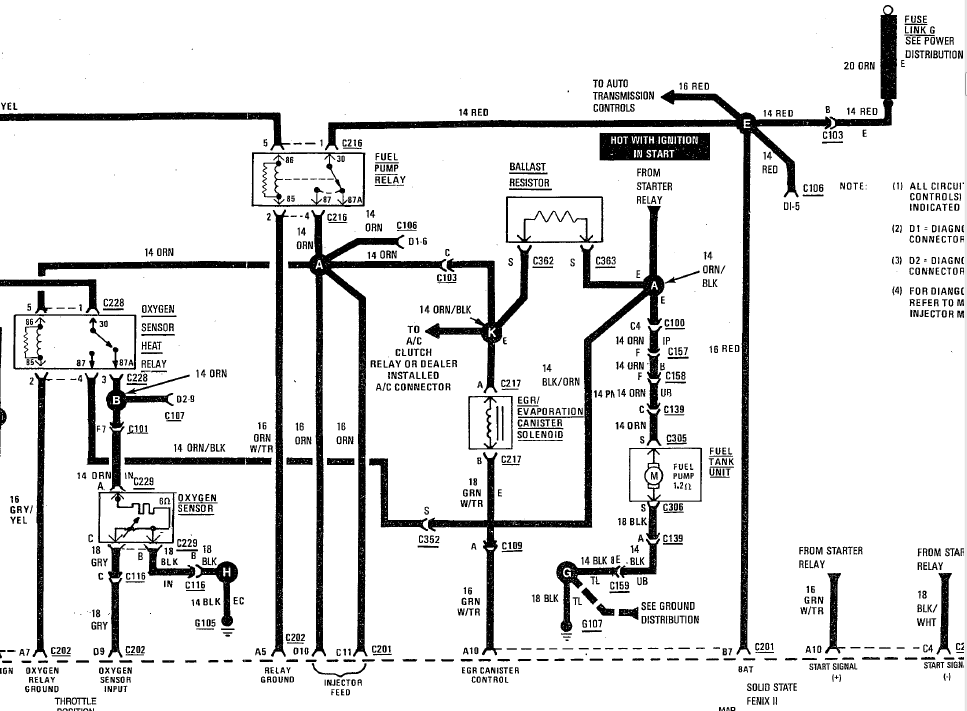

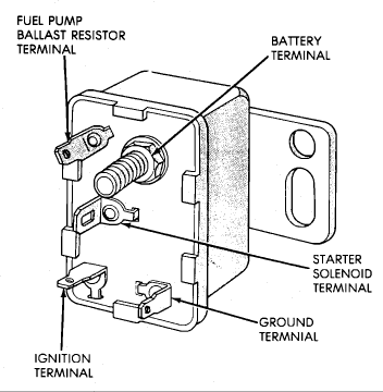

The power for the fuel pump is supplied from the starter relay during cranking and bypasses the other relays. Believe it is an orange wire going to the pin marked BAL (most times) on the starter relay.
If memory serves me correctly the schematic I gave is for an 88, the 87 has a slightly different wire color layout between some of the connectors on the drivers side harness front to rear. You have to pay attention to the wire colors as they change on you between the connectors.
