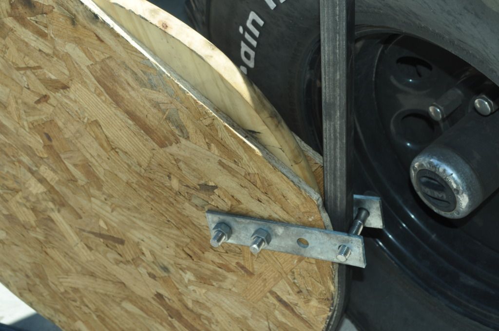

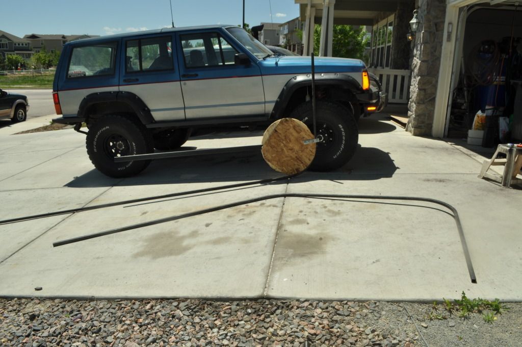

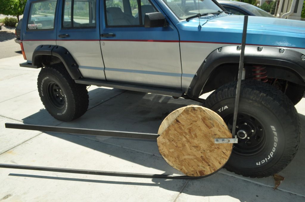

I finally got the time to start bending the upper framework. People ask how you bend square tubing. Well being an engineer I always seem to build my own tools. I took some shortcuts on building the bender. I was at my local home improvement store, Lowes, and ran across something that cut my time way down. It was a round table top blank. It was 2 feet across and had a beveled edge.
The radiused edge causes a slight indentation on the inside of the bend to allow the square tubing to be formed without kinking. The table top was just a tad thicker than the 1 inch tubing. I cut a slot about 60% across the top so a piece of 1x2 thick wall tubing could be inserted for a handle. I used some 1/2" scrap glued and nailed to both sides to strengthen the disc and to provide guides on each side of the tubing. I used some misc bracket material I had to fab the retainer. This thing is really just a knock off of a conduit bender.
I then starte bending the side pieces. The trick is to figure out the bend allowance and exactly where the center of the bend will end up. Trial and error is the rule. Once that is done, you can bend your tubing.

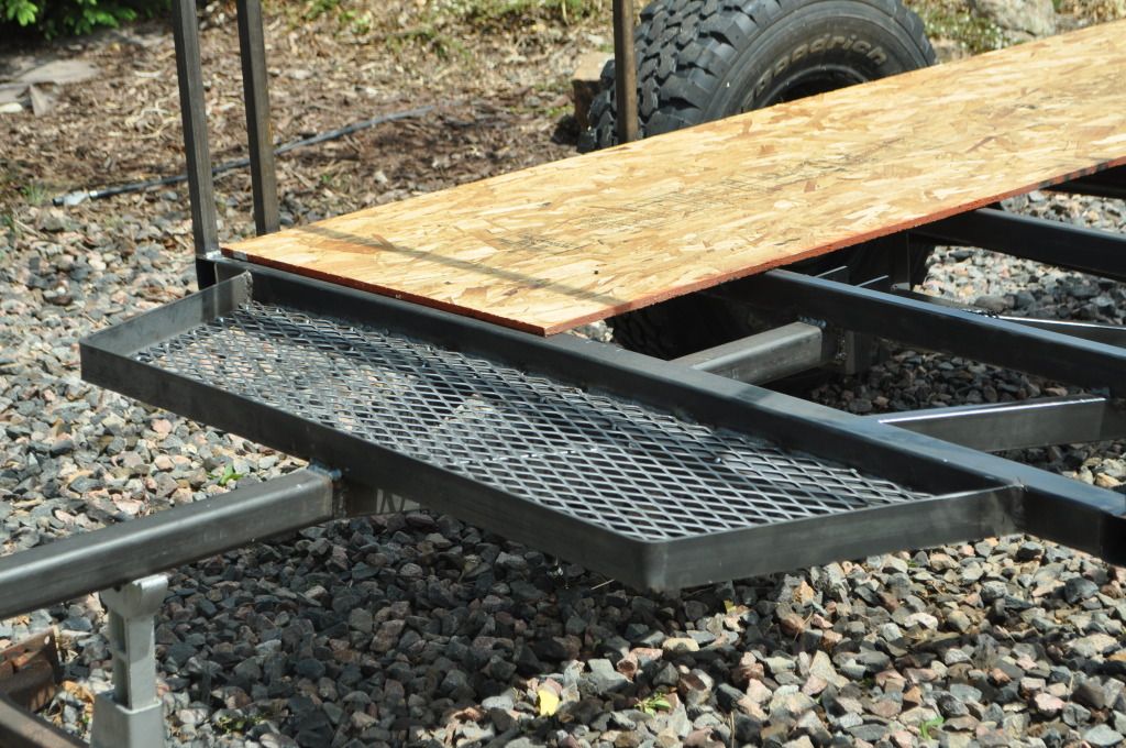

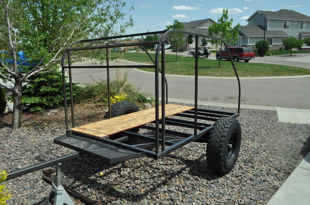

Slowly but surely it is comming together.
I still have quite a few pieces left on the upper frame but I ran out of steel and money until payday.
I have the parts to do the articulated shock isolating offroad hitch, so I will start on that this afternoon.

I have finished mounting the shocks and revising the air bag lines, as well as the offroad articulating hitch and offset tongue. I am starting the pre-wiring before adding the sheathing. I hope to take some more pix this weekend as I start fleshing out the rest.
Oh, by the way, there will be no sheetmetal.
