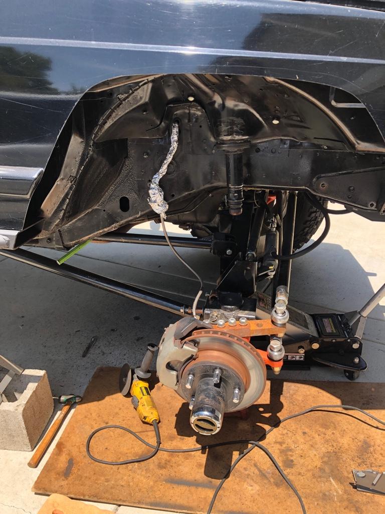

Spent most of the day working on the Jeep. Got the power steering cooler mounted. I didnít get good photos of how I mounted the cooler but i found a spot where itís tucked away and gets decent air flow from the fans.
I welded the provided grade 8 bolts to the top of the steering box brace to basically make studs. Then used the provided washers and nylocks to lock it in place. Spliced the cooler into the factory return line and re-bled the system.

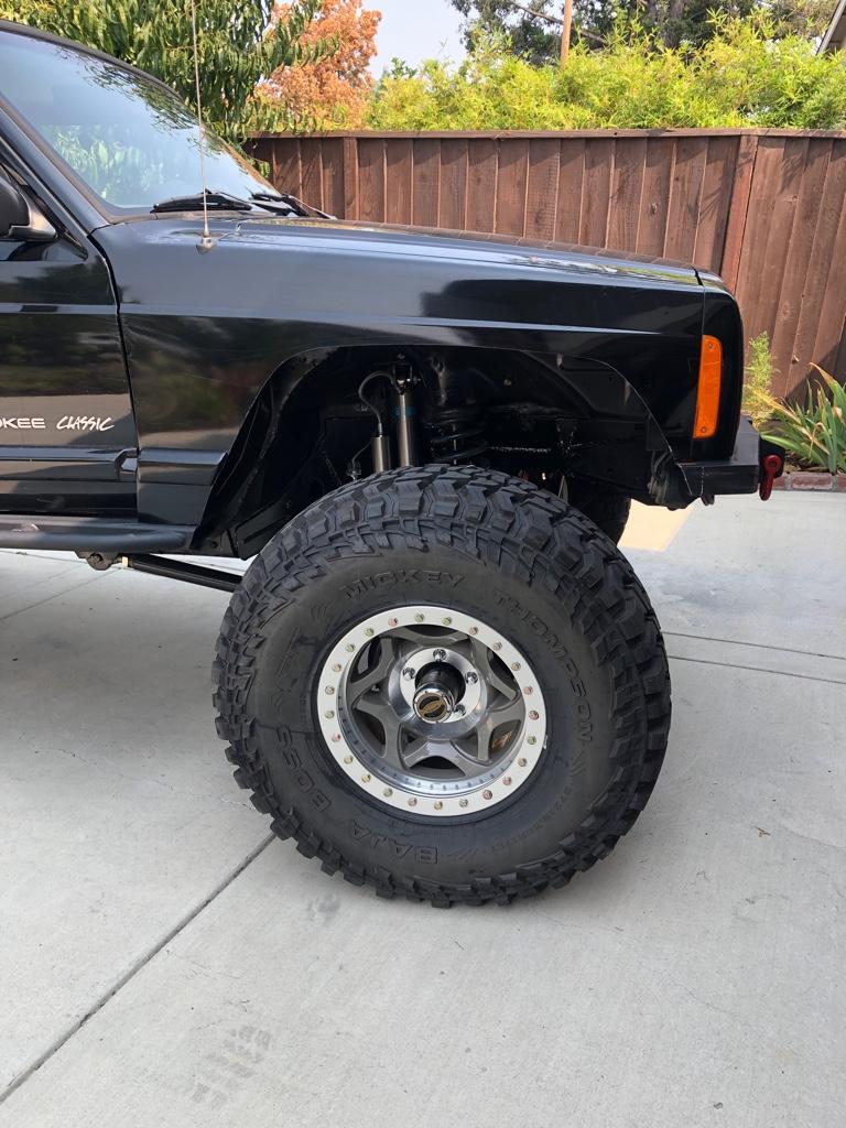

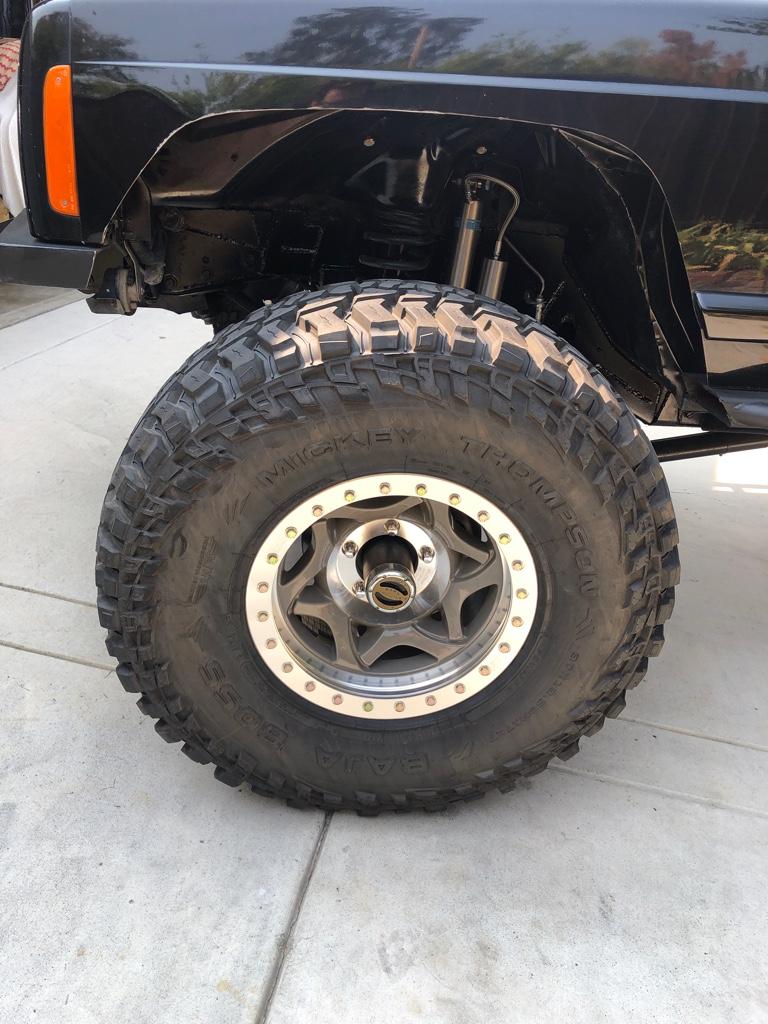

Made some calls earlier this week and spoke with the west coast Bilstein hq. Iím not sure if it was a case of good timing or just what but they had 5 units of the part number I ordered come into inventory from Germany this week. Had the shop I ordered through reach out to Bilstein and they secured two for me.
The billet clamps were from Amazon and I got the shock stem conversion from teraflex. Theyíre about an inch and a half long which was accounted for when I was doing the math to determine size. These are 10Ē body 12Ē shaft with 1/2Ē heim joints at both eyes.
Ordered front frame stiffeners earlier this week as well. Theyíre a bit nicer than most options out there as they wrap under the unibody along the whole wheel well...not just the steering box area or not just between the track bar and the original LCA bracket.

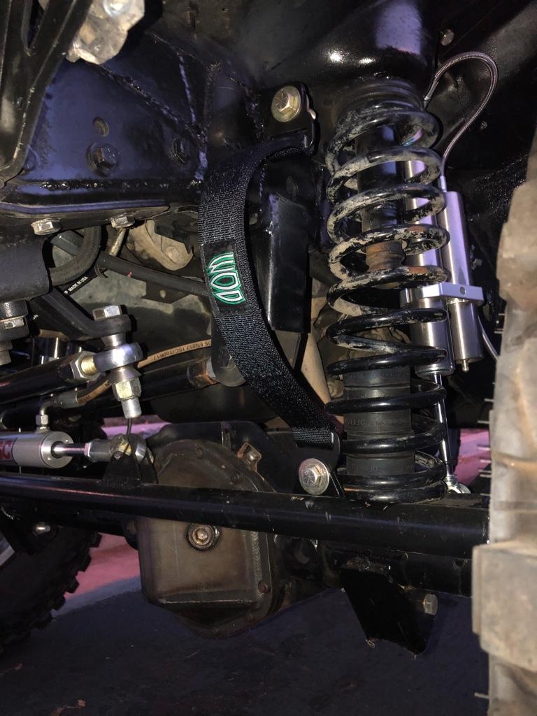

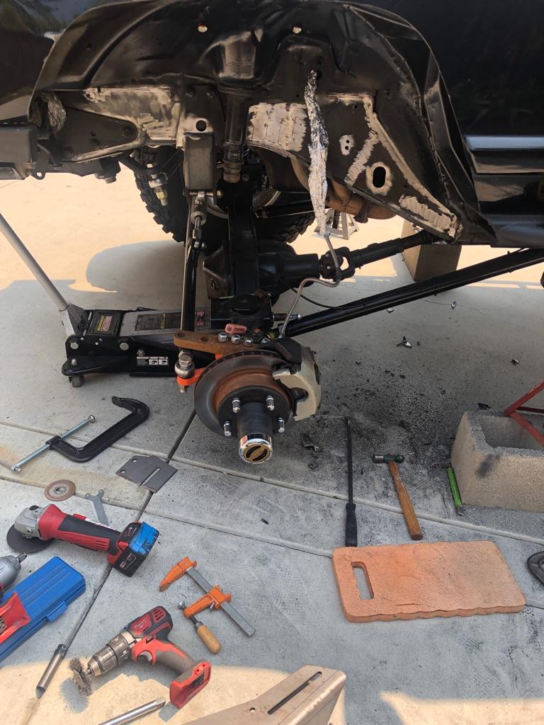

Been on the paper chase at work lately but Iím working towards a deadline. Some RK buddies want to make a rubicon trip in June. After I got the shocks on, I was confident enough to take this thing in the freeway and man it felt like it didnít have enough positive caster. Super touchy steering feel, wanted to dart all over the road, wheel resisted returning to center while moving. My UCA is bottomed out so I lengthened my LCAs. That gave me more positive caster and flattened my coils out. Helped quite a bit but it could use more positive caster adjustment. No front driveline vibes felt yet. I was thinking it may be bump steer but going over larger and more gradual speed bumps doesnít make the Jeep dart/wheel jerk one way or the other.

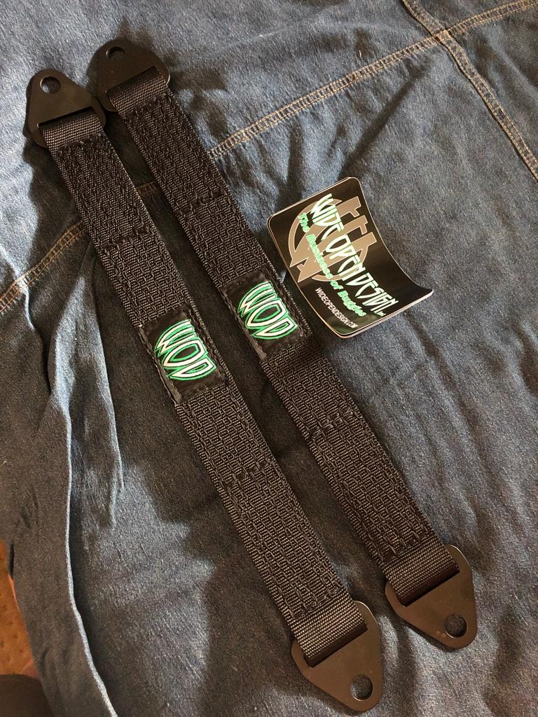

I need to find a big rock or forklift to iron out limit straps. Bump stops should be easy to make just gotta sit down and get the jack stands out.

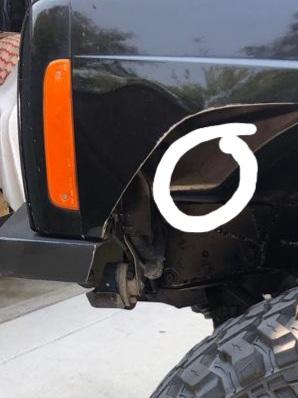

As far as rear shocks, Iím leaning towards outboard shock towers since the boostwerks towers have been out of stock and the dude doesnít reply to emails. That way I can run a bit longer shock and maximize down travel. Been looking at Artec as opposed to bending tube and making hoops. Might even let the towers protrude into the cargo area just a bit and tie the towers into a cage. Still brainstorming.
