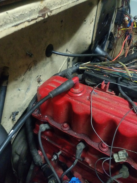

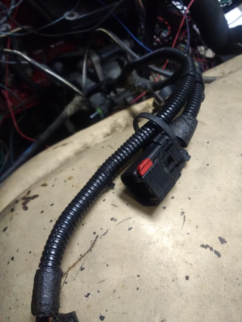

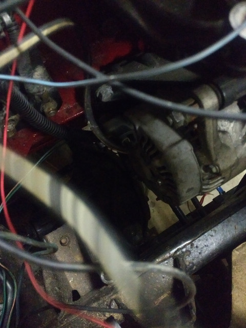

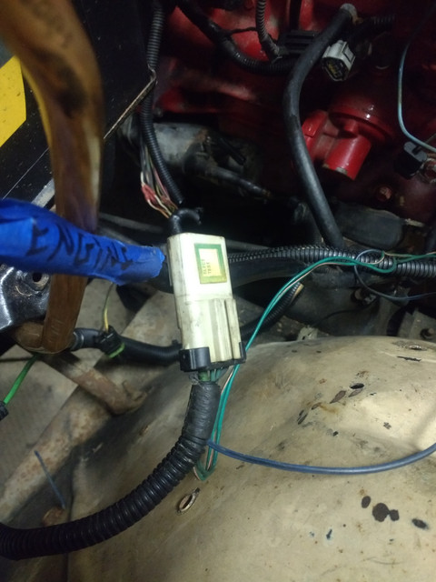

These are all on the passenger side, and are part of the distributor and the alternator. Can someone get pics or trace the wires from these connectors? One of the pics is the large black/white wire off the back of the alternator. Does that connect to the PDC?
Oh, and the vacuum connection at the rear of the valve cover. Can I just put a filter there? Did that connect to the factory air box?
Thanks
You're transplanting the original wiring harness too? Almost all the connectors are keyed, so it's hard to misplug anything. If you have an FSM you can trace out where wires are supposed to go. The breather on the rear of the valve cover went to the intake manifold so it gets vacuum, and the front went to the air box for fresh air.
Yes, I have (fairly certain) the entire wiring harness from the XJ, and between the FSM and the keyed connectors, I have most of it.
I just want/need confirmation of how the PDC is wired (both a wire from the battery and the wire from the alternator on the single stud on the PDC?)

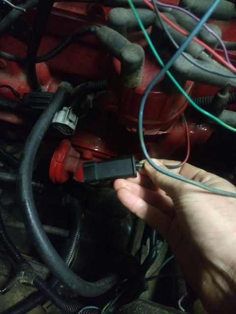

I've located all the connectors but can't seem to find the connector to the distributor. I also didn't see the distributor wiring connection in the FSM. If I knew where it ran and the color of the connector (most likely black), I might could figure out what was going on .
Thanks
Figured it out. The grey connector, right beside the camshaft connector in the first pic.....that's it.
