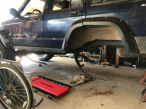

The first step for me was to replace the rear leaf springs with a set up for coils. After some investigating I chose the clayton's off road conversion kit. Super high quality, relatively easy to install. The downside to this kit or any like it is that it makes routing your exhaust very very difficult. Compound this with a suspension that flexes like nobodie's business and it ultimately become impossible with my setup (engine swap)to run a muffler or to reach the very rear of the vehicle. Not ideal, but acceptable.

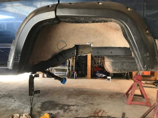

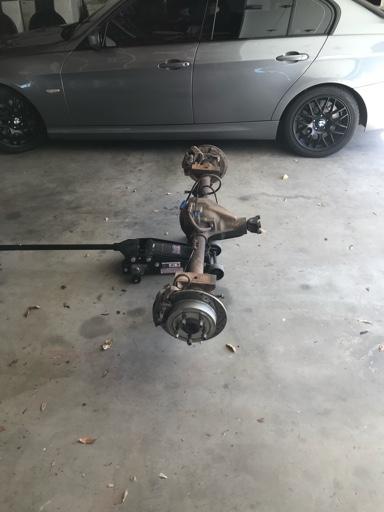

Rear axle pulled
The crossmember section welded in
Rear axle. This is from a TJ rubicon. Been on the XJ for 8 or so years.

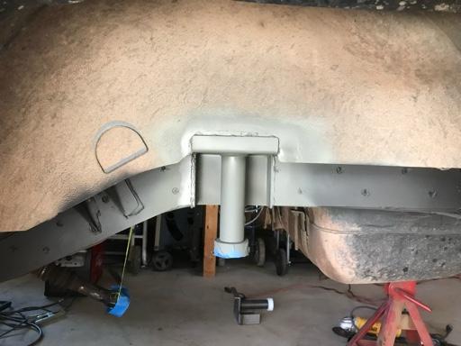

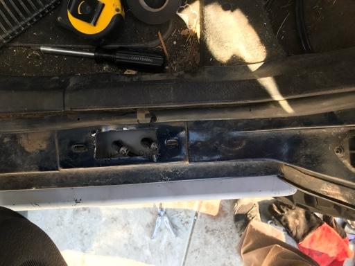

Cut the holes for the Clayton’s upper spring mounts.

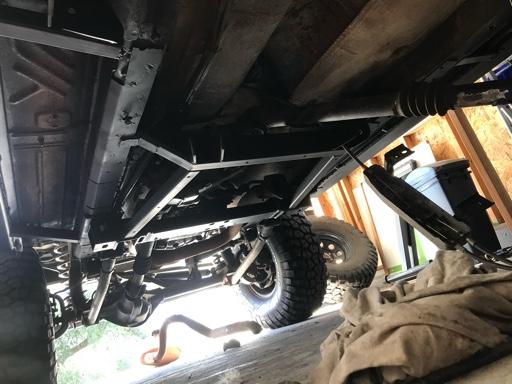

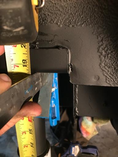

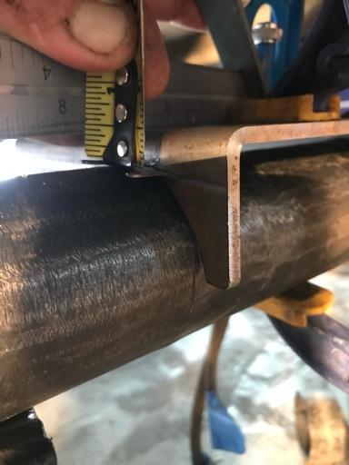

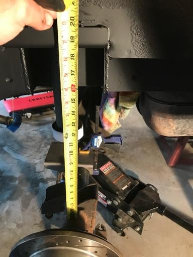

Making a bunch of measurements to ensure the correct ride height
Tacking in the spring perches and getting the driveline angle correct.
Because the vehicle can now go from somewhere around 3” of lift from factory to about 11” I had to be smart about the drive shaft angle. The air springs that I got from off-road only have a ride hight setting that I based everything off of. While I wanted to have the Jeep sit as low as possible during highway driving it can only go so low before things start to hit. The first was the rear shocks so they got completely remounted actually had to bring the upper mounts into the cargo area (sorry no pics of that). My next limit was the track bar hitting the front differential. A mod there gained me another couple inches of compression. Lastly was the front shocks hitting the bump stops. I lowered the front shock mounts and now at full compression the bumps are slammed just before the tire contacts the fender well. Perfect.

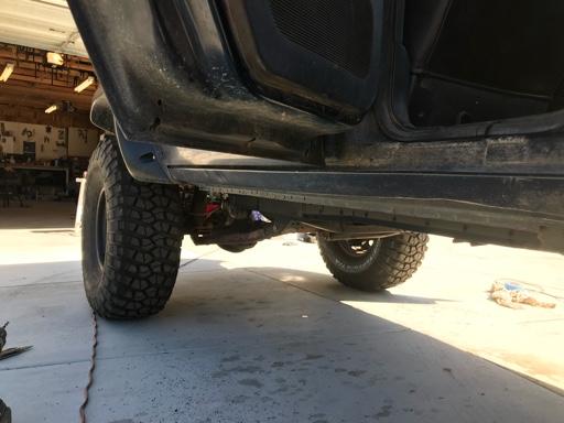

I am using radflo 10” shocks that are made for air springs. The shocks themselves are meant to be limiting for down travel which is needed to prevent the air spring from being pulled apart.
Other than the shock mounts being in a different location this setup would be the same as any other XJ with front and rear coil springs. Air springs are pretty easy to install since when they are empty the are flexible. Just jack up the vehicle and put them in like any other spring, only easier. I had to do a little trimming to ensure the rubber cant contact anything. Ripping a hole in one on a trail wouldn't be catastrophic but riding home on a bump stop isn't fun either.

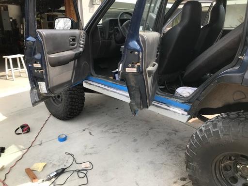

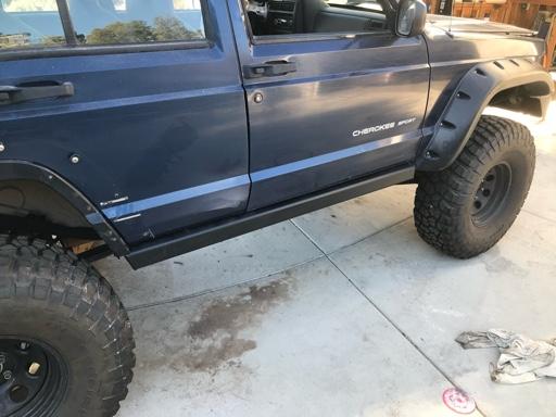

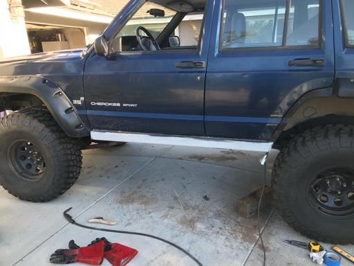

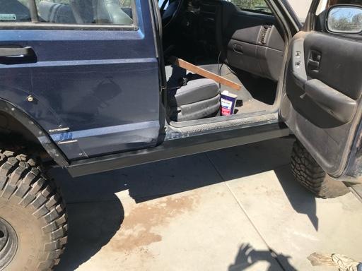

I needed rockers and I needed air tanks so....

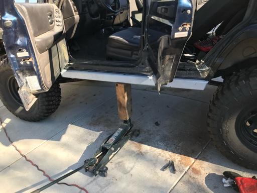

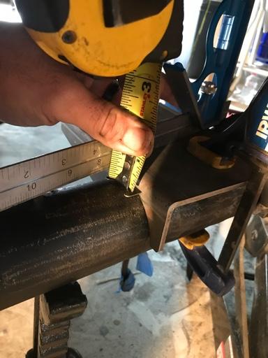

I used 3x5 steel tubing and made some rockers
Then sealed them up. Tapped 1/4”NPT hole for threading in my lines. Pressure tested and welded any holes. This took a bunch of tries.

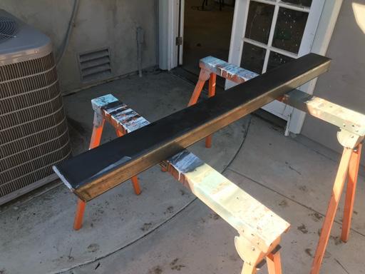

My original paper thin rockers
Welded up and ready for primer
Getting ready to weld the rocker in place

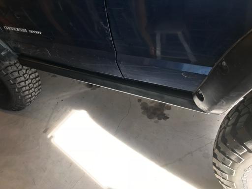

Passenger side installed. I used some bondo to smooth over all the welds and then put a little black paint on
Welded and bondo'd (?) ready for paint
This is a view looking down from the driver side rear seat. I needed a safe way to get the air in and out of the tanks (where it wouldn't get smashed). I removed this little plastic thing and put my holes here, then with 90 degree fittings it made the plumbing work out well.
All in all this little bit worked out great. Now I have two giant air tanks and rockers.

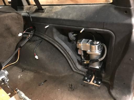

Here is my air compressor solution. This thing is acceptable but not great for high demand. It has a 15 minute per hour duty cycle which cause me the amateur computer programer a great deal of trouble, more on that later. What is good about this is that it fits very nicely in this otherwise useless space in the back. Much later down the road during an engine swap I relocated my battery to the rear cargo area and having a nice short run of wire really made a huge difference in performance for this compressor. From 0 psi to 147psi takes about 11 minutes, used to take about 15. If I dump all the air out of my springs and have a full air tank I can completely raise the jeep about 3 times before the pressure is too low to lift it any more. Of course the compressor would come on at some point but just running off the compressor with no tanks would take several minutes to raise the vehicle.

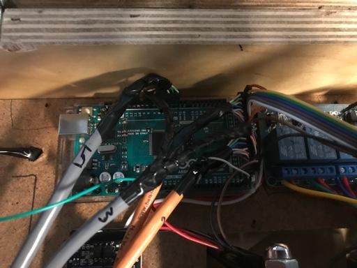

This is where the madness really starts! Time to build the brains of the operation.

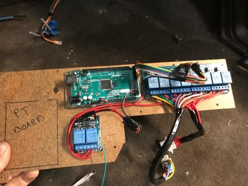

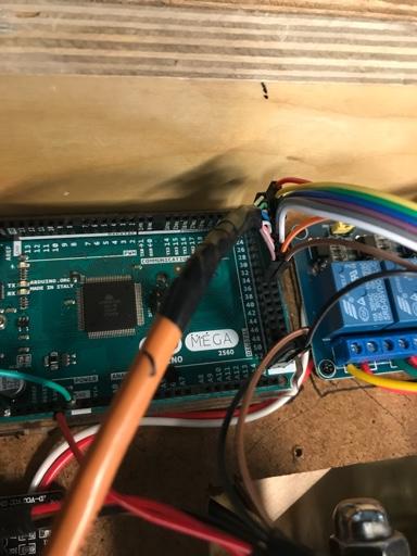

Here is the basic board that I used. An arduino MEGA big green thing on the top left. Next to that is a series of 8 relays. Each air spring needs two solenoids; one for air in and one for air out. At a very basic level the arduino sends 5V to the relays to close them, this in turn allows current to flow to the solenoid and opens or closes them as needed.
The little board with the two relays on it is for the air compressor. Because of the limited duty cycle I needed to control the run time with my arduino. I am not kidding when I tell you that I spent more time trying to "invent" the code to handle this duty cycle than I did installing the long arm kit. I had something that sort of worked but was very cumbersome as far as software is concerned. One of my buddies who has a Phd in computer sciences was in town and I had him take a look at my code, he chuckled, pecked away at the keyboard for a few minutes rewriting the duty cycle portion that I had. Much more elegant solution, much more stable, uses a fraction of the processing power that my code used I really should have asked him about it weeks before! Not much of a hardware problem but for a guy like me the software was a real head scratcher. If folks are interested in the software side of this project let me know. It is some real nerd stuff that will be painful for people that are not familiar with coding.

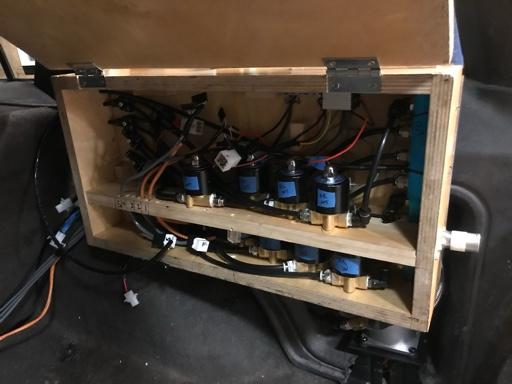

Here are all of the solenoids mounted to an unused drawer I made for my kitchen a few years back. The blue strip on the right side is the high pressure manifold. No need for a low pressure one since everything vents to atmosphere.

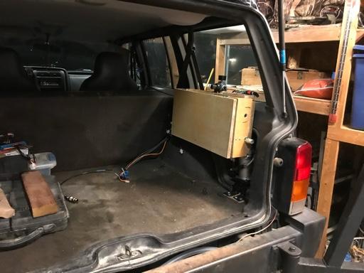

After about a month of nights and weekends here is the final mounted product. Came out pretty slick IMHO. I have never been too terribly interested in making things look super nice. Of course I put a quick release air fitting on here too (silver pipe) because as we all know compressed air is super handy dandy.
Here is the basic board that I used. An arduino MEGA big green thing on the top left. Next to that is a series of 8 relays. Each air spring needs two solenoids; one for air in and one for air out. At a very basic level the arduino send 5V to the relays to close them, this in turn allows current to flow to the solenoid and opens or closes them as needed.
The little board with the two relays on it is for the air compressor. Because of the limited duty cycle I needed to control the run time with my arduino. Not much of a hardware problem but for a guy like me the software was a real head scratcher. If folks are interested in the software side of this project let me know. It is some real nerd stuff that will be painful for people that are not familiar with coding.
