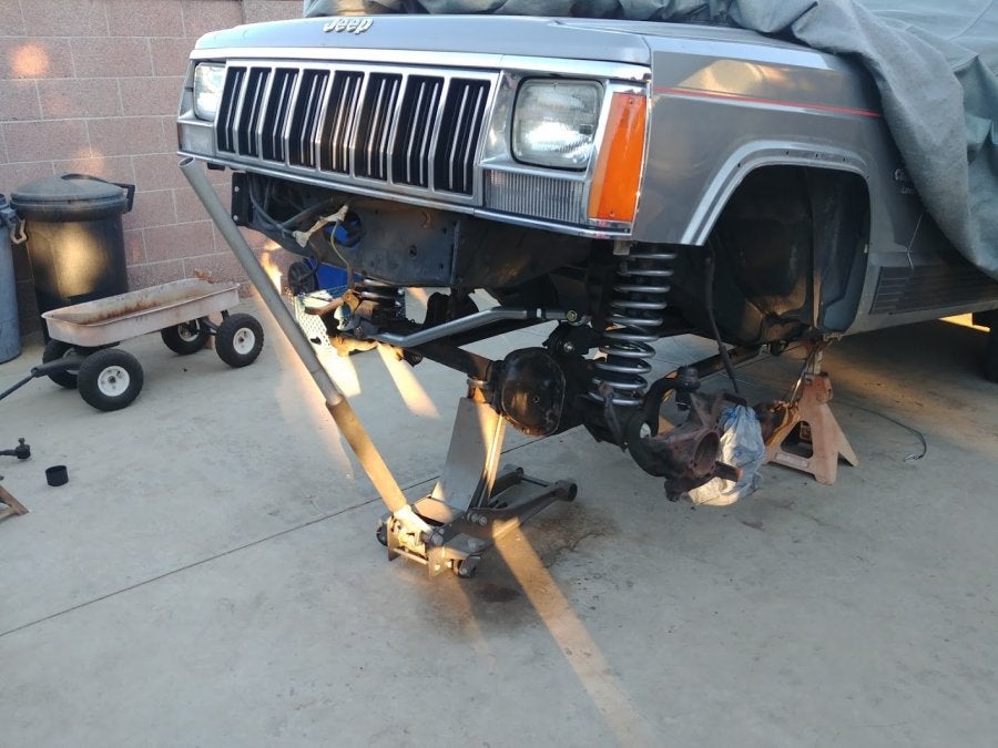

Landed this puppy a year ago, salvage, 92,4.0, 144K, auto, NP231, non-disco, I'm the third owner. AC/heater work. Previous owner had to dump a bunch of money into the intake system to get it to pass smog and I got it for a good price.
Black Friday 2017 lit the fire, ordered stiffeners, Cavfab long arms, 5.5" REs 4.5" rear leafs, tires at 4WP killer deal.

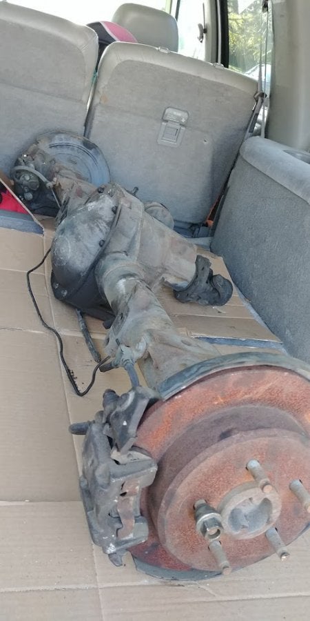

Weird hole in the wall auto dismantler up the street had an 2000 8.8

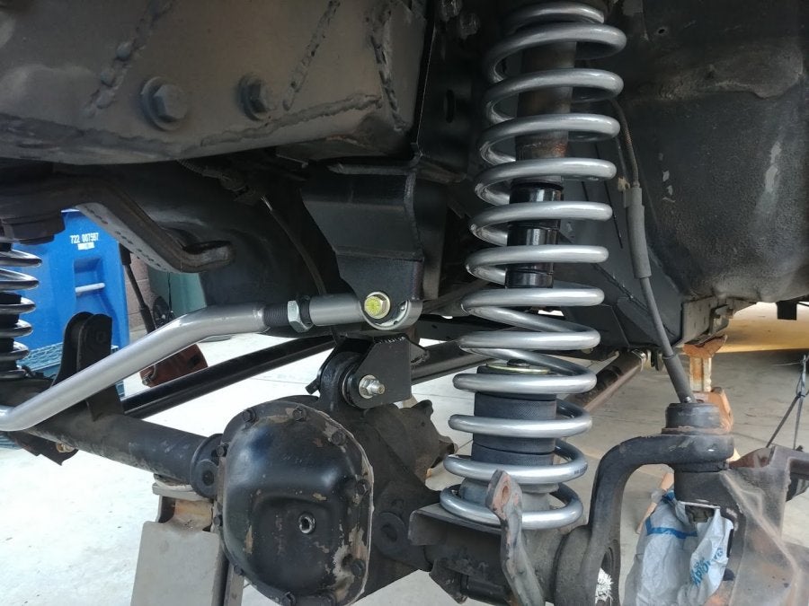

RE1660 Track Bar and mount and brace
HD and Ruffstuff frame stiffeners
(8.8) Grizzly locker and Yukon shafts, geared to 4.88,
Spartan for the D30, chromos for it too
, SYE , Adams drive shaft,

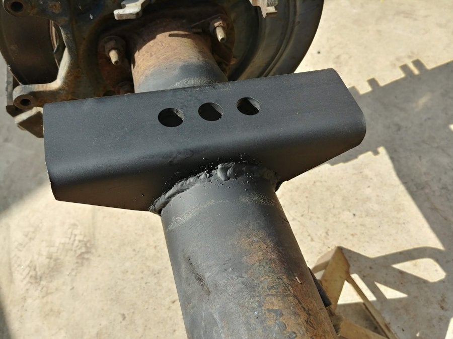

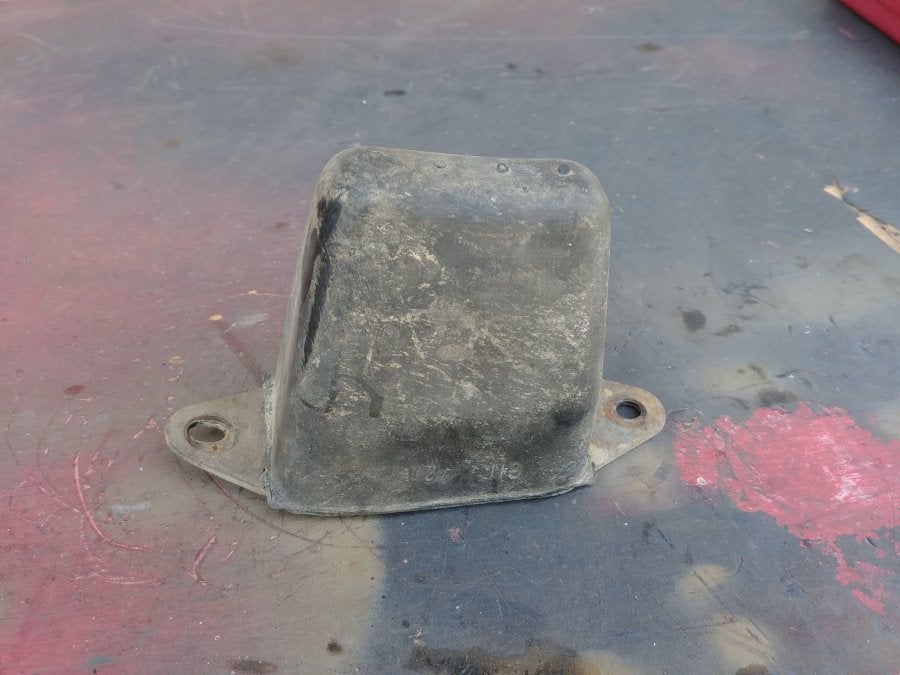

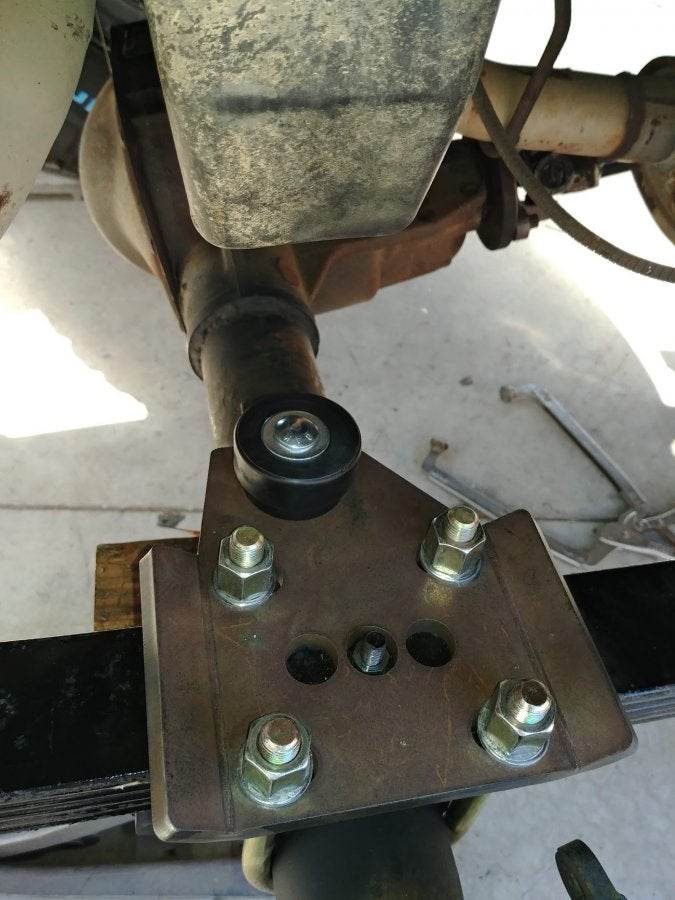

Turns out stock YJ front bump stops are ~ 4" like the aftermarket rear ones for XJ's (am I late? common knowledge?) and had some rubber bushings laying around that I mounted on top some Dirt bound spring plates. Finally set my pinion angle and welded the perches on the 8.8. Not the prettiest welds but they'll hold.
