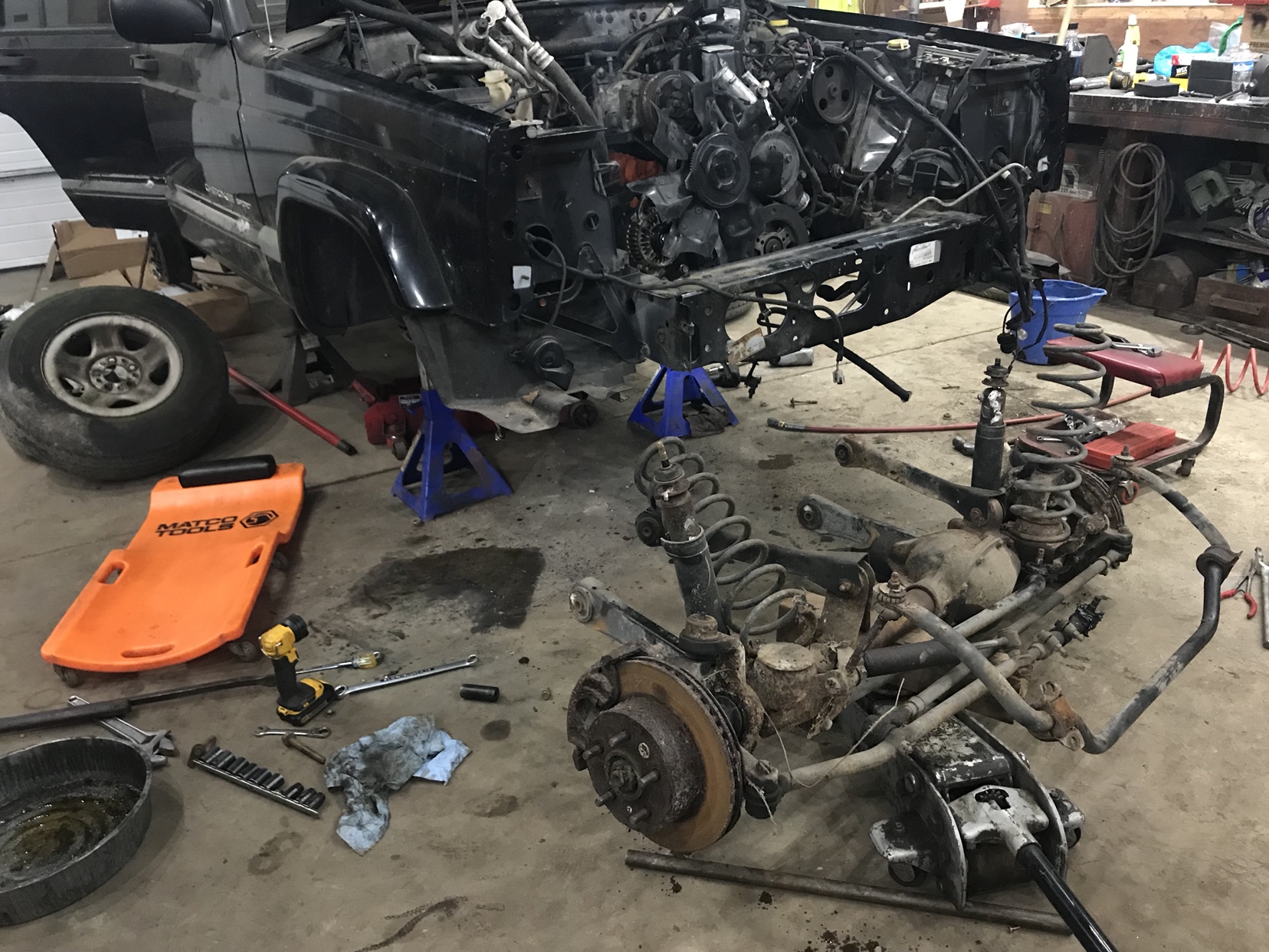

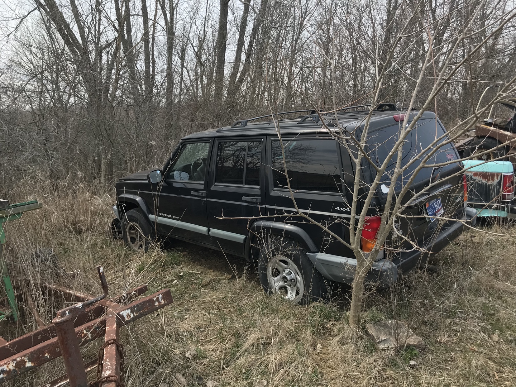

So I finally got my project jeep finished! It took about 4 months from pulling it out of the field from where it had been sitting for 8 years to running it at Redbird State Park. It started out as Project Stuart Little and is now officially deemed Project Mighty Mouse. This was an extremely huge project especially regarding the fact it was completely stripped, engine rebuilt, axles rebuilt, hours upon hour of welding, and all the countless trial and errors.

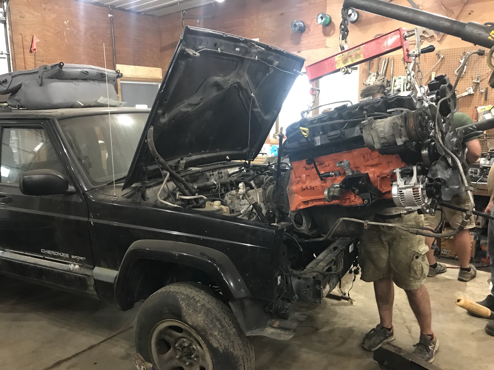

Engine

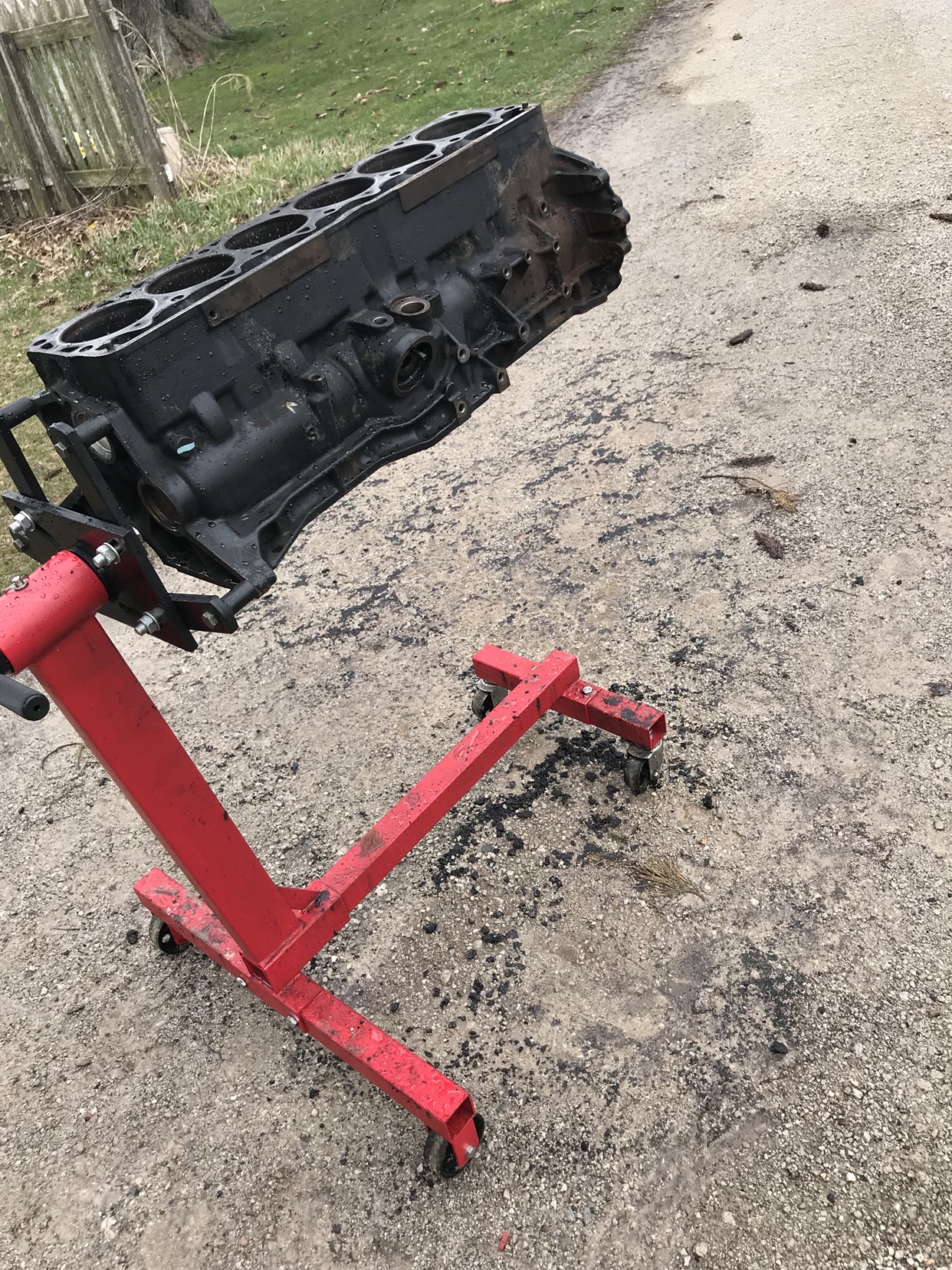

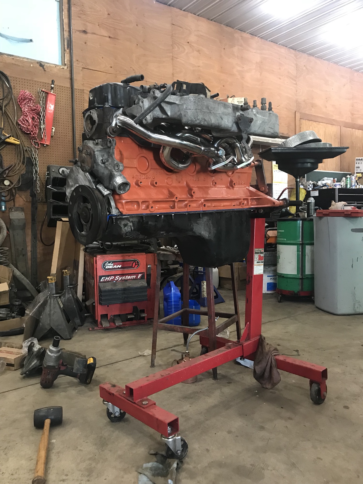

- OE rebuilt block from a 1997 painted Chrysler hemi orange just for fun
- stock head from a 98(?)
- 4 hole dodge stratus injectors
- wiring from a 2001
- camshaft synchro and coil pack from a 2000
- JEGS 6-2 headers
- stock “downpipe” and cat to thrush muffler (cheap and quick)
- custom intake
- daystar motor mounts

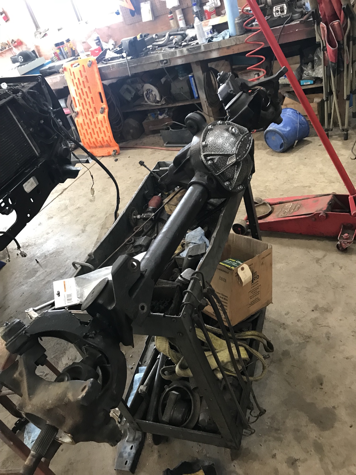

- High Pinion D30 with welded inner sleeves and upper c-gussets. I have lowers and have a truss, just didn’t have time

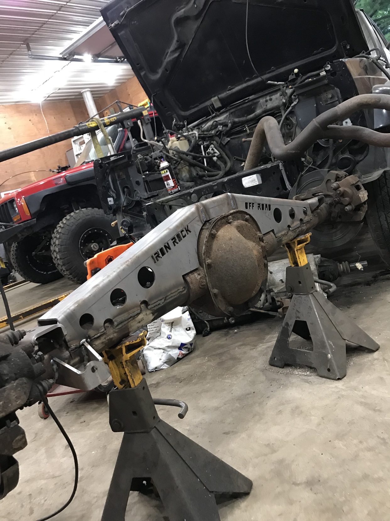

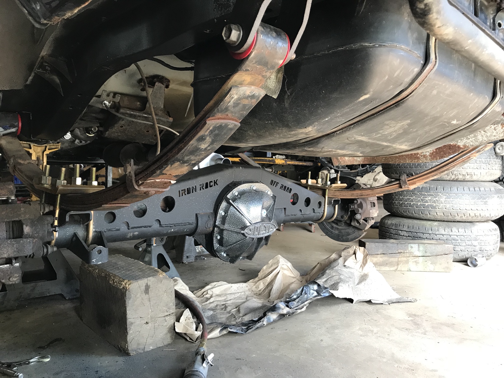

- Ford 8.8
- trussed
- solid industries diff cover
- Yukon F88 ultimate kit (chromo c-clip eliminator axles)

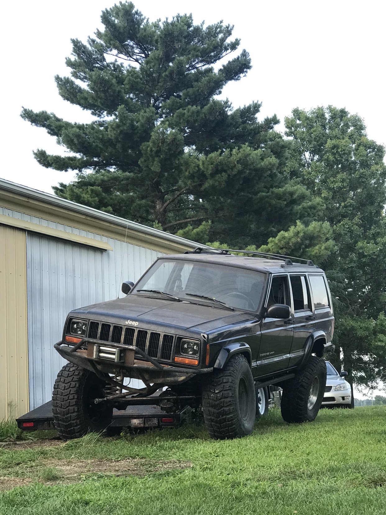

- front winch bumper (we should have used the bumper plates to tie it in but ran out of time, you’ll see why in the pictures)

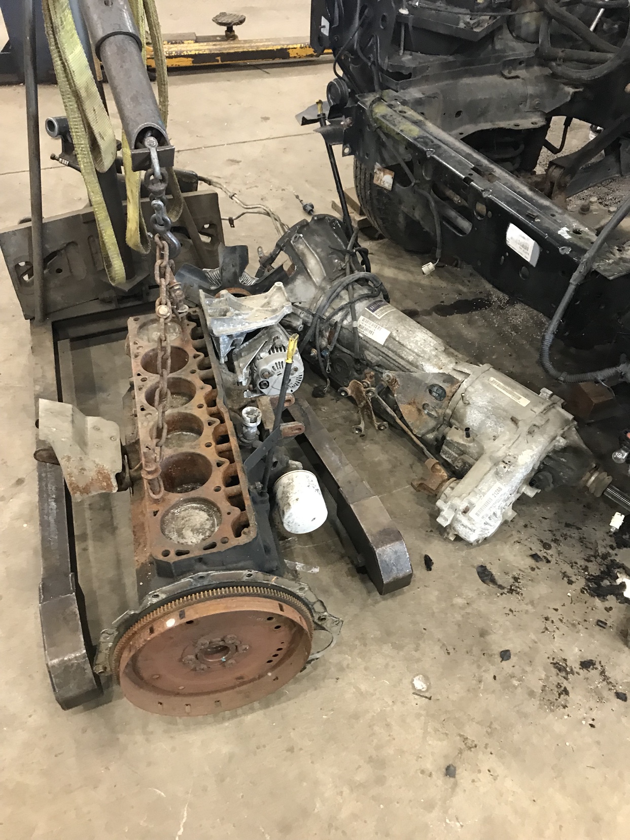

Old engine.

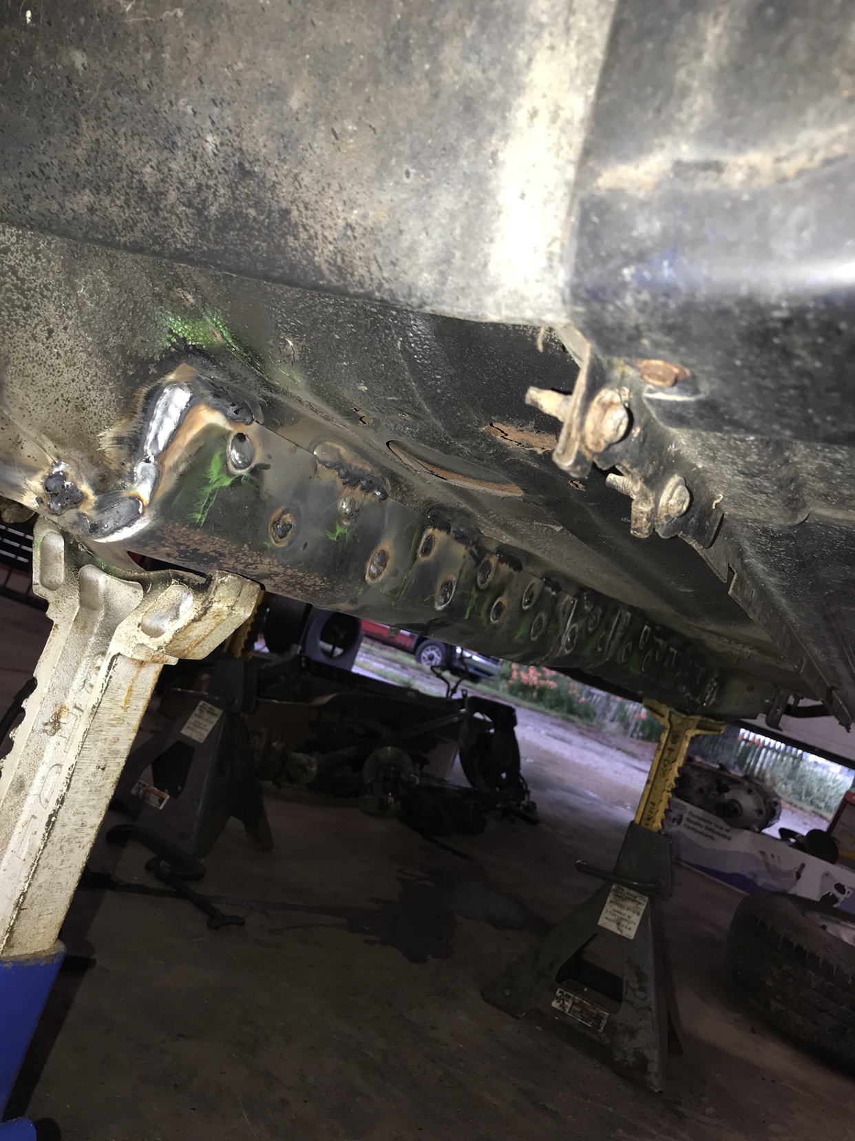

Welding laying down and upside is difficult.

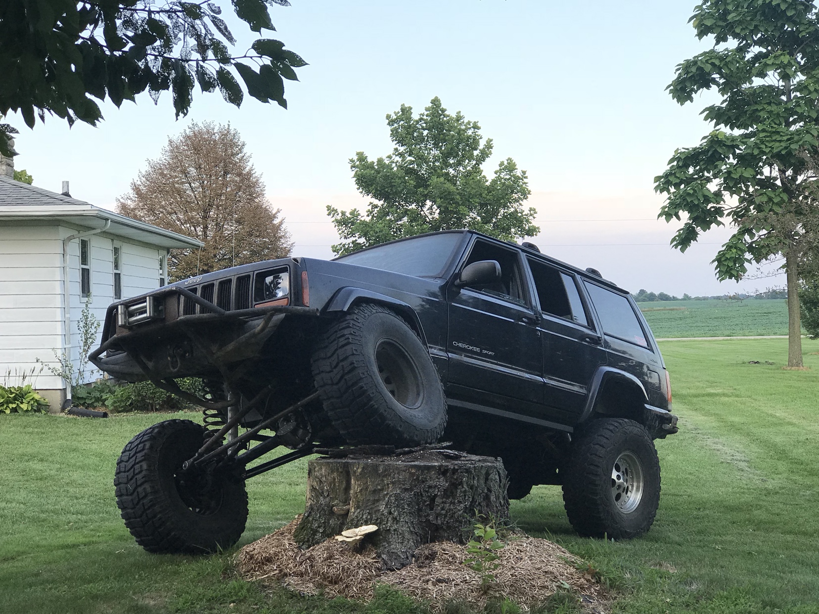

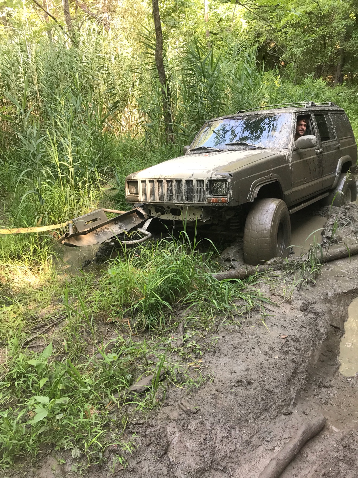

Remember when I said I needed the upgraded bumper brackets?
My buddy Nick admiring his work.

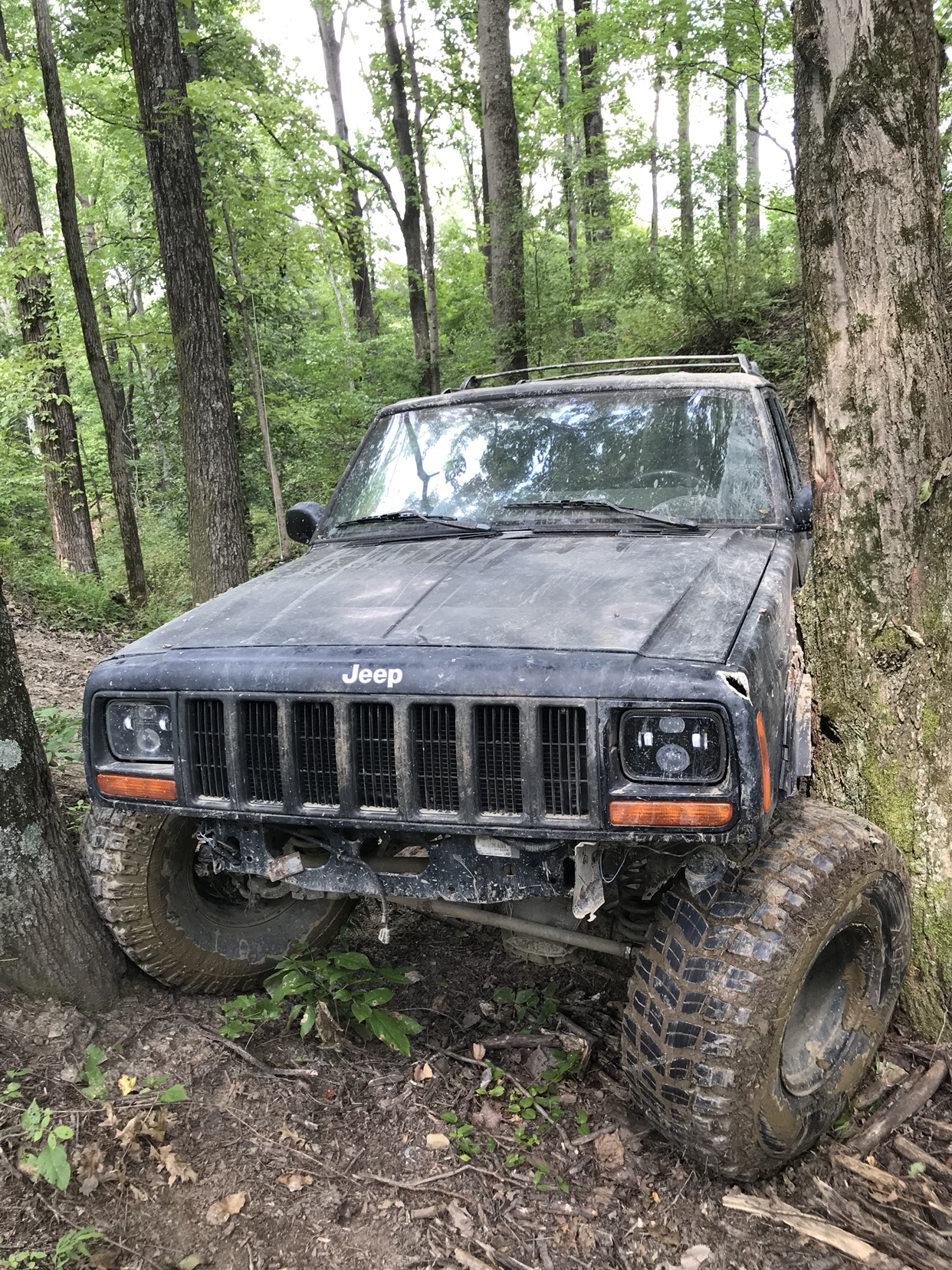

Wedged. This is when I broke my steering gearbox. No more left turn. S10 box here I come!

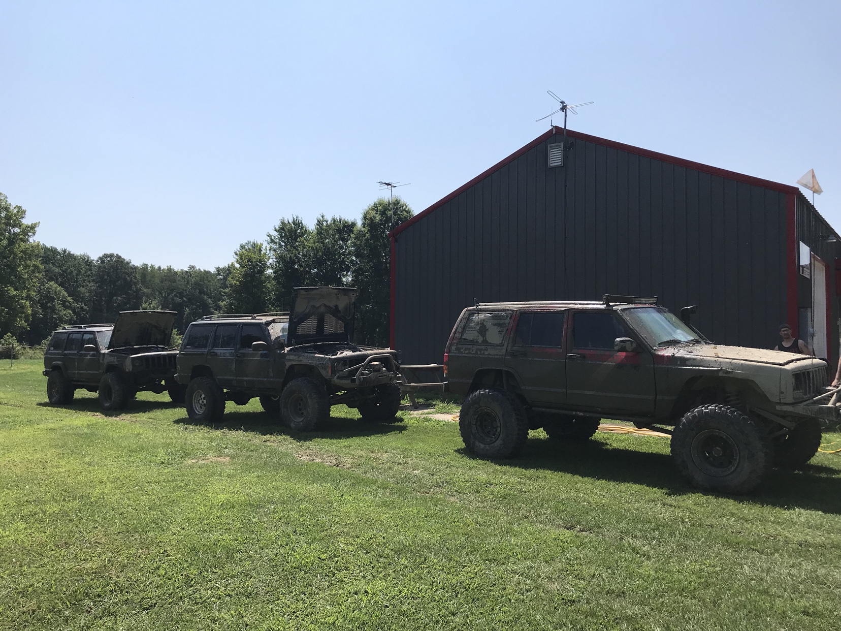

Such a great trip! I cannot wait to make more trips and more memories!
