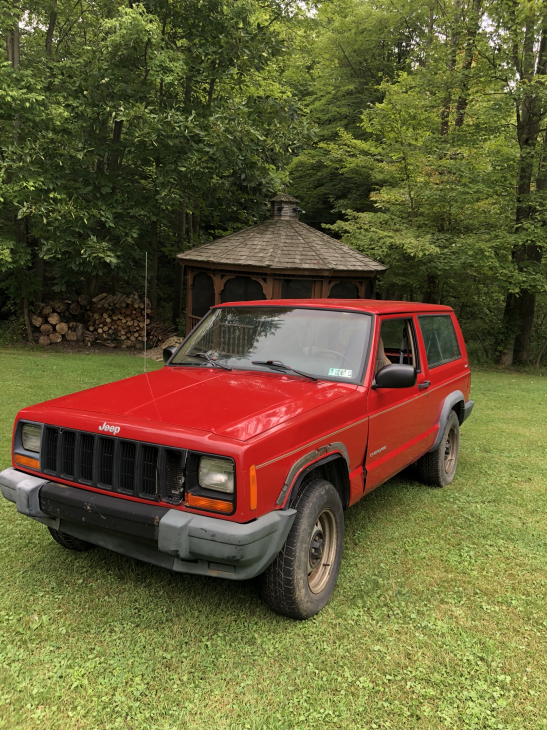

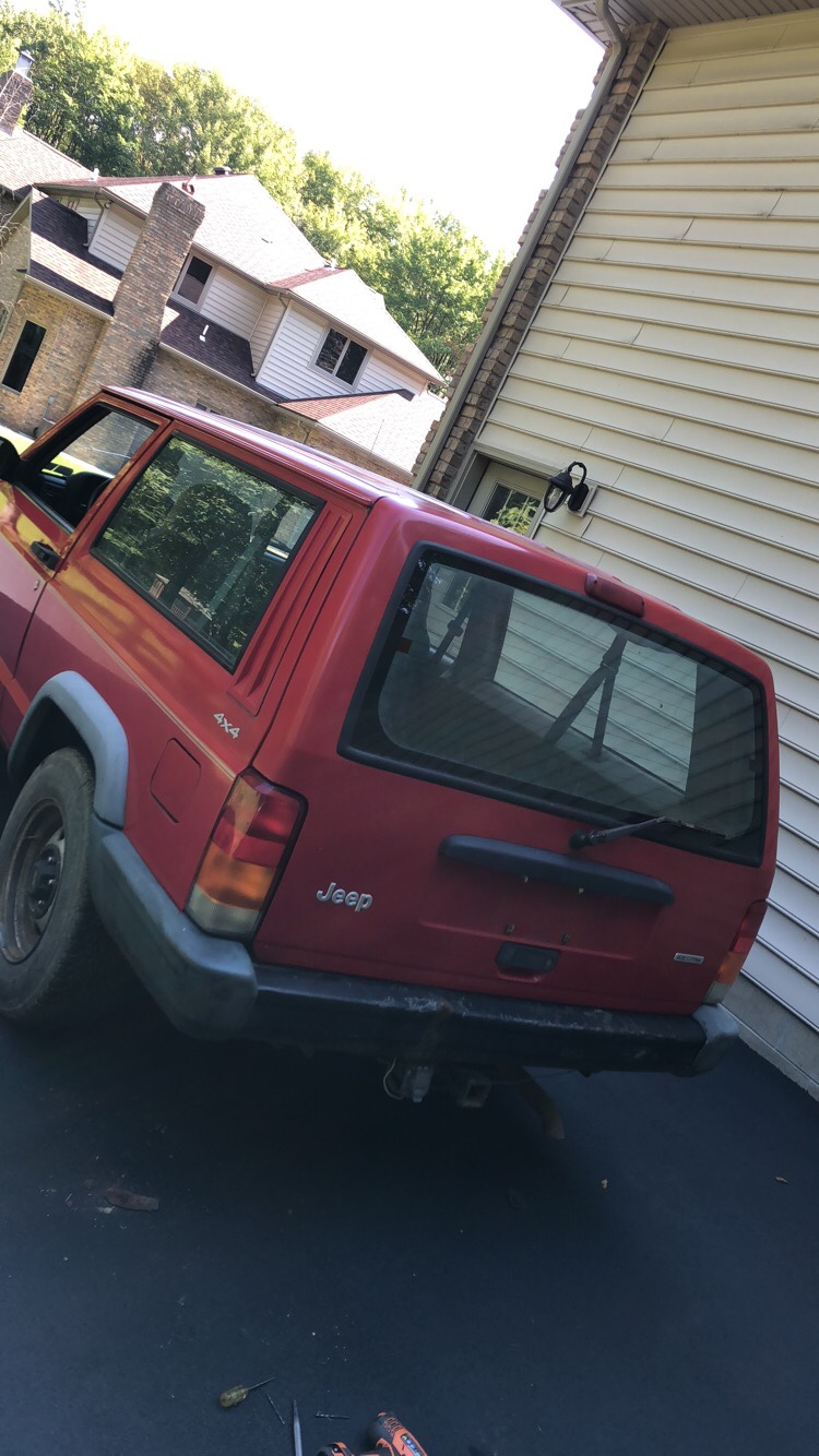

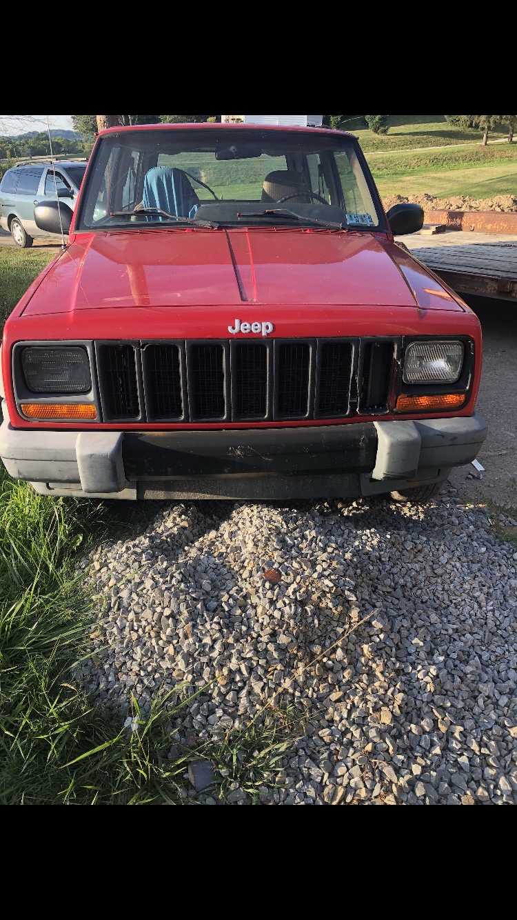

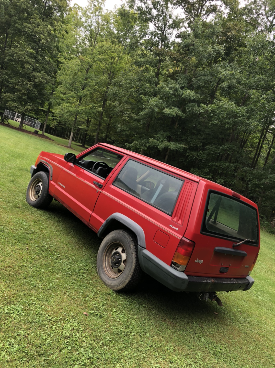

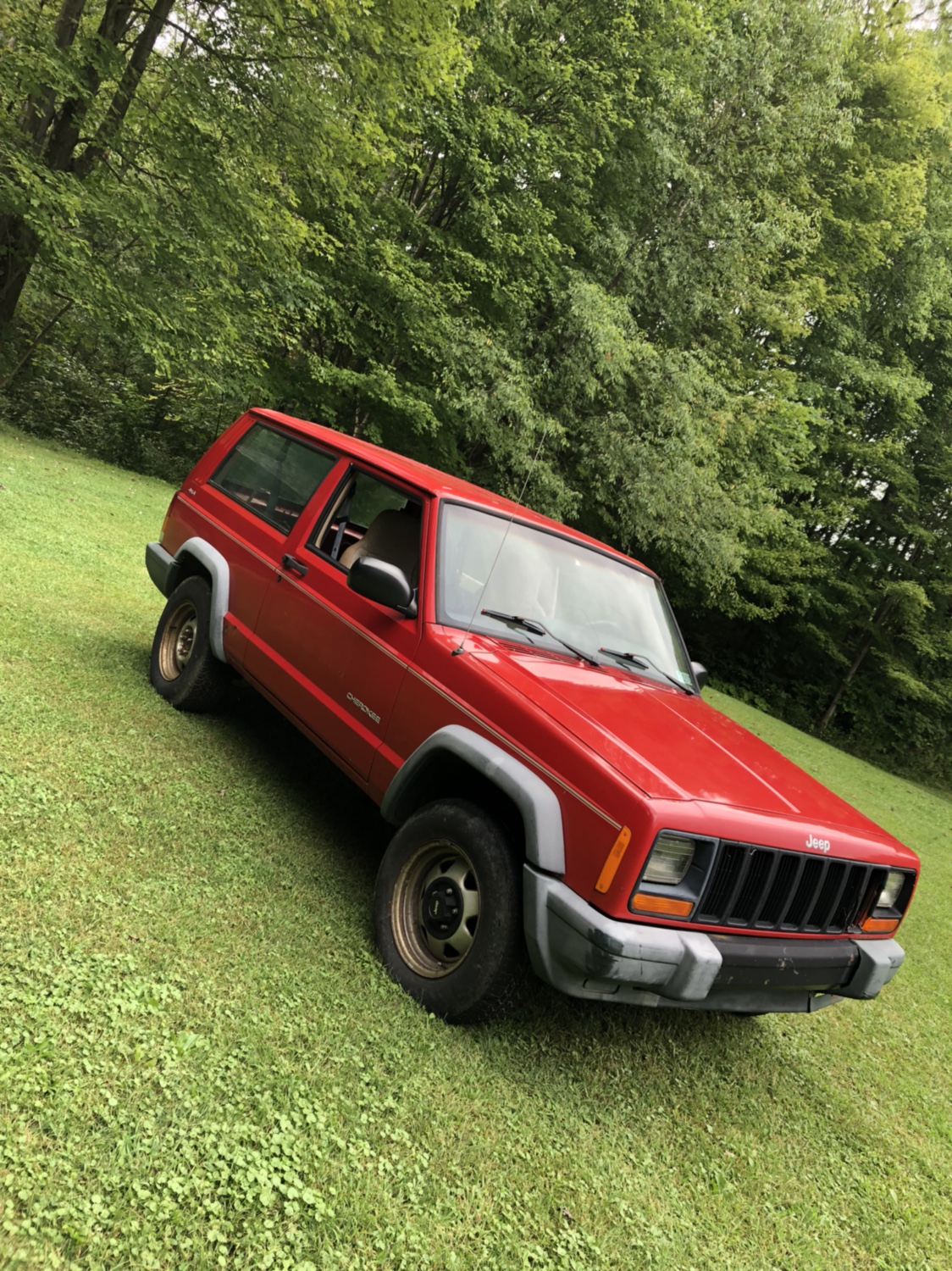

Back story: at the beginning of summer me and my best friend decided to take a bone stock 01 Silverado that sat behind my building for years and turn it into a mud bogger for Yankee lake . After many trips there and seeing so many cherokees I decided I needed one . Next time I went my buddy brang his 01 4 door . That sealed the deal. So I began looking around , and I wanted a 4 door but no one would respond to my messages . But this 2 door popped up and I had a feeling this guy was going to get back to me since it was a 2 door not a 4 door like I wanted . Sure enough he did . Next thing I knew I was driving to the south hills of Pittsburgh to look at it . He was asking 1,000, and I talked him down to 800. Next weekend I went and picked it up, and now it sits . Here is the original pictures I was sent .

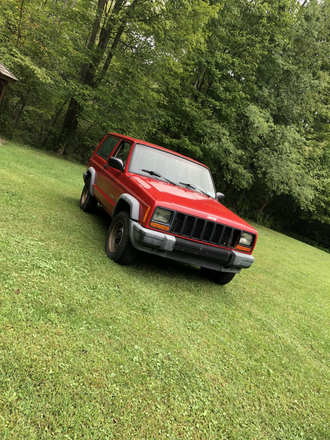

And now that I’ve had time to clean it up a little bit

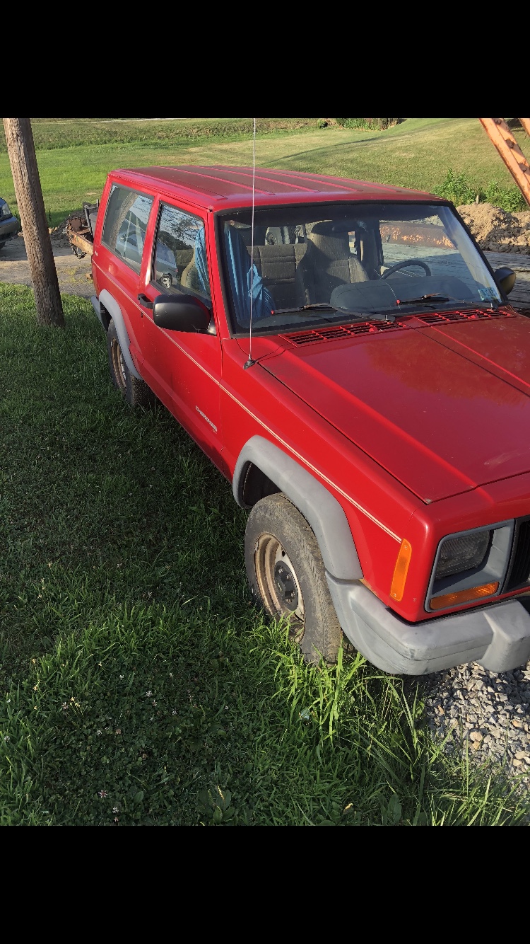

Story goes that it was used on a pheasant farm all of its life . So it’s incredibly solid since it rarely saw the salt . But since it was used on a pheasant farm and the first time I turned on the heat it blew feathers everywhere , I nick named it birdman. It has the 4.0 with 188k miles , which seems incredibly healthy . More pics to come

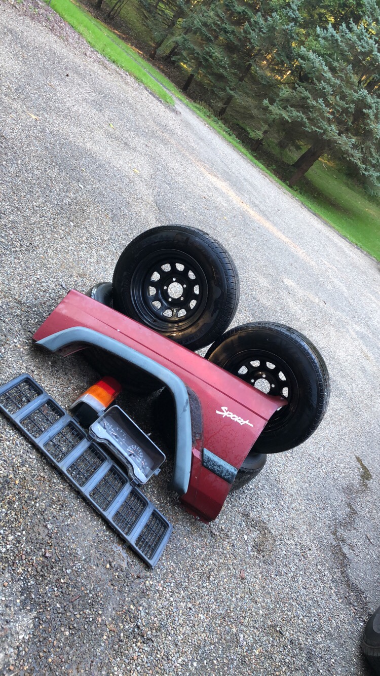

So yesterday I went to my first pick a part and found a total of 5 xj’s . Also lucked out on the fact it was a half off day.
I got :
-Fender with flare
-Grill

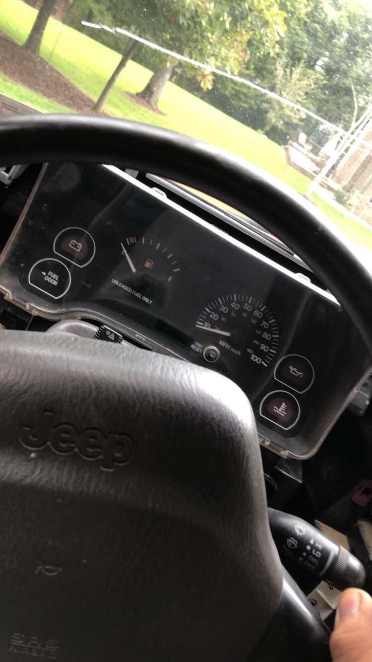

-Sport gauge cluster
-Wiper transmission
-Tail light
-Set of 4 aftermarket wagon wheels
I managed to get it all for $110 bucks with tax.

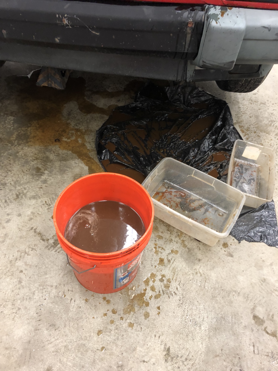

Also did some small stuff , put the grill on and fixed the back wiper . Starting to shape up, also noticed since I have a actual temp gauge now that it’s running kinda hot . I’ve known the coolant is rusty colored and that it needed changed , but it just reinforced that . So that’s the project for tomorrow , and possibly fix the passenger door speaker
Alrigty , time to keep moving . Last 2 nights I’ve been working on cleaning up the coolant . It has the typical rusty coolant , so I’ve been filling it with water letting it run for awhile then dumping and refilling .
Also got a new heater resistor so the heat works . Although it doesn’t seem the heat isn’t that hot for the car being at normal operating temps .
Whoa, that’s a lot of cooling system neglect. Run some white vinegar & distilled water at idle for a while (of course flush after) and that should clean up the system.
Water by itself seems to have cleaned a lot of it out . Once it goes clear I’m gonna run it for a month to let it loosen up more and hopefully I can truly get it clean. Definitely the nastiest coolant I’ve ever seen 😂

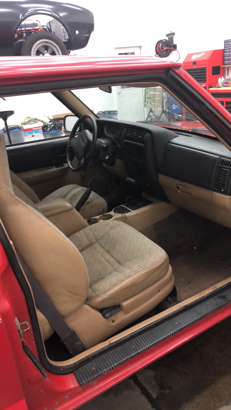

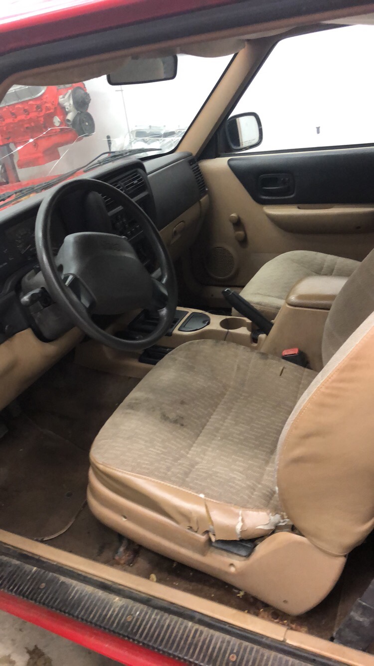

Interior is definetly the worst part about this thing . It just smells so bad and is stained from when it was used on the farm .Ive heard of people using tj seats, but I wasn’t sure how it would look. I’d also like to swap the carpet to black . Can’t find it anywhere for less than 250.

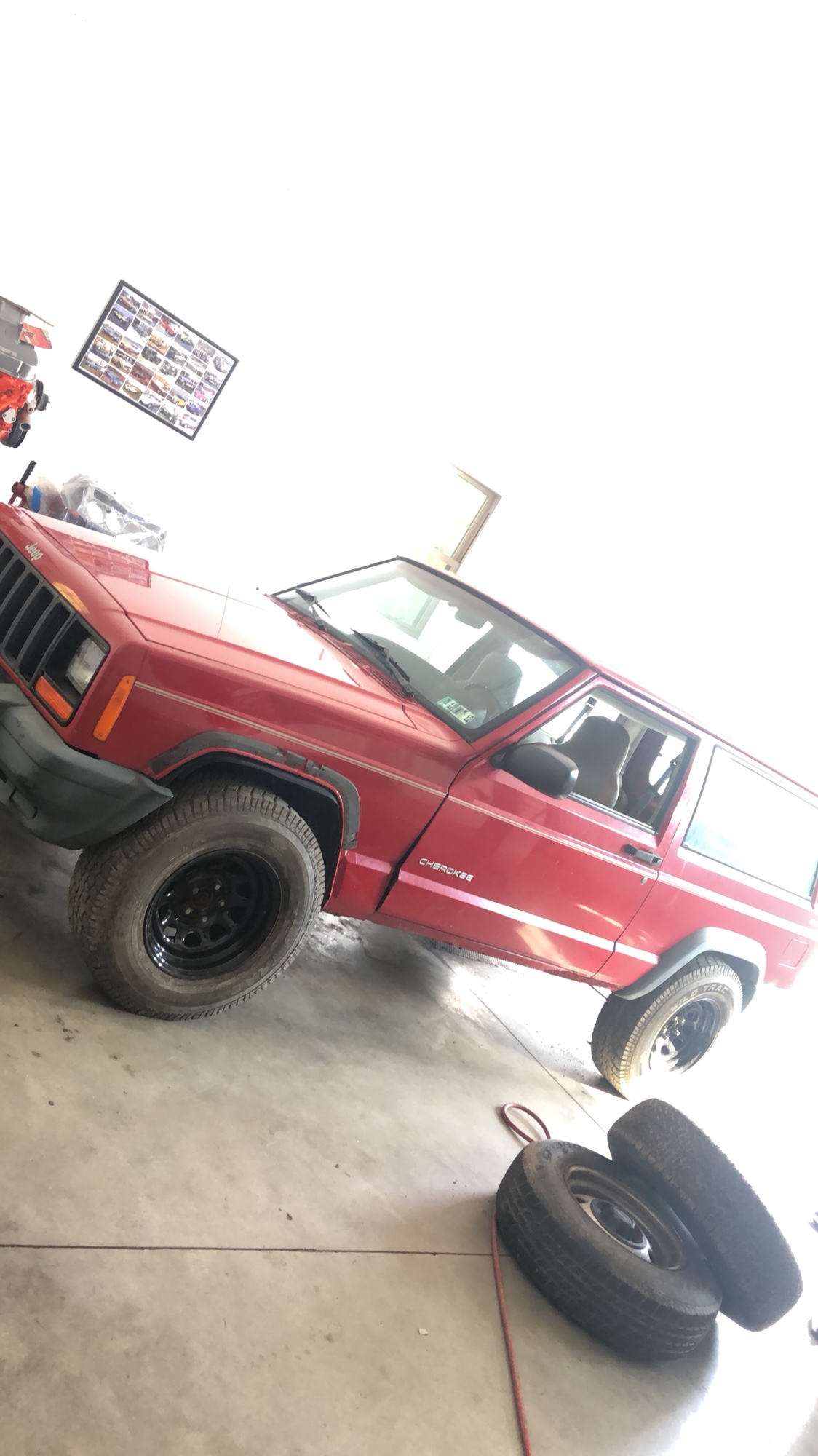

Mounted and mocked up my new wheels and tires today .
I’m loving the way this thing is turning out , even clears without a lift . Although I’m going to have to get one before I go wheeling in spring . Also found out that the pads on the back are literally non existent . I’ve been working like crazy trying to balance school and work, and all my other free time is going into this thing . I probably should be working on my 68 camaro but ... lol

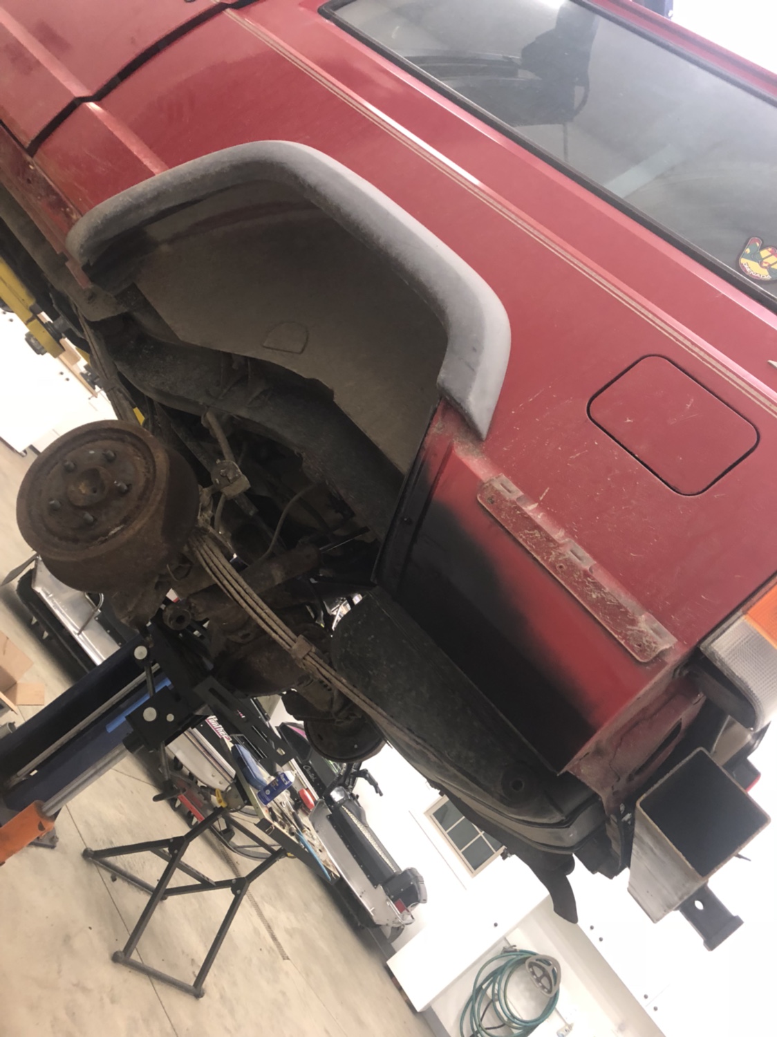

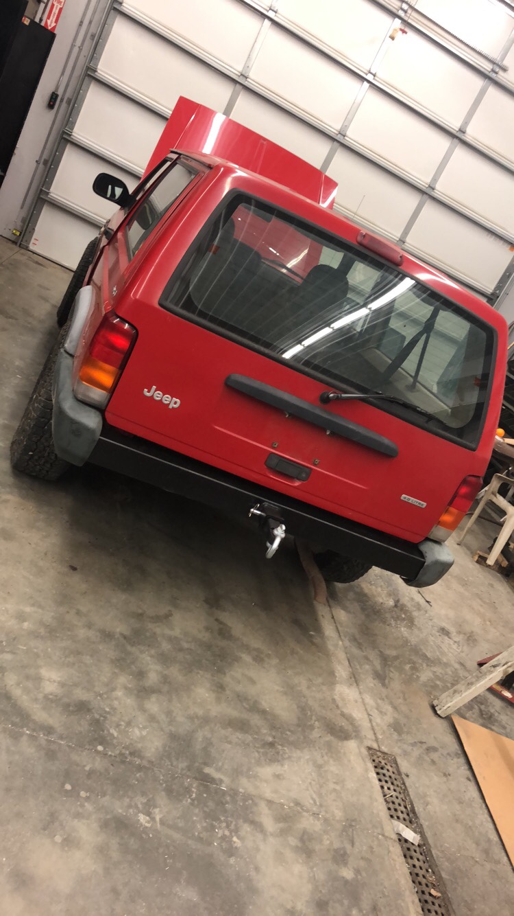

So the 2 tires I had I couldn’t buy 2 new matches for so I decided to just keep them as spares . I picked up a set of falken wildpeak a/t 31x10.5x15’s . Also recently replaced the rear gate struts , fixed some battery issues , sand blasted ,painted and mounted my spare tire . But other than that , the biggest thing has been fabricating my rear bumper . My factory one was rusted and I didn’t like that the hitch that was on it hung super low .

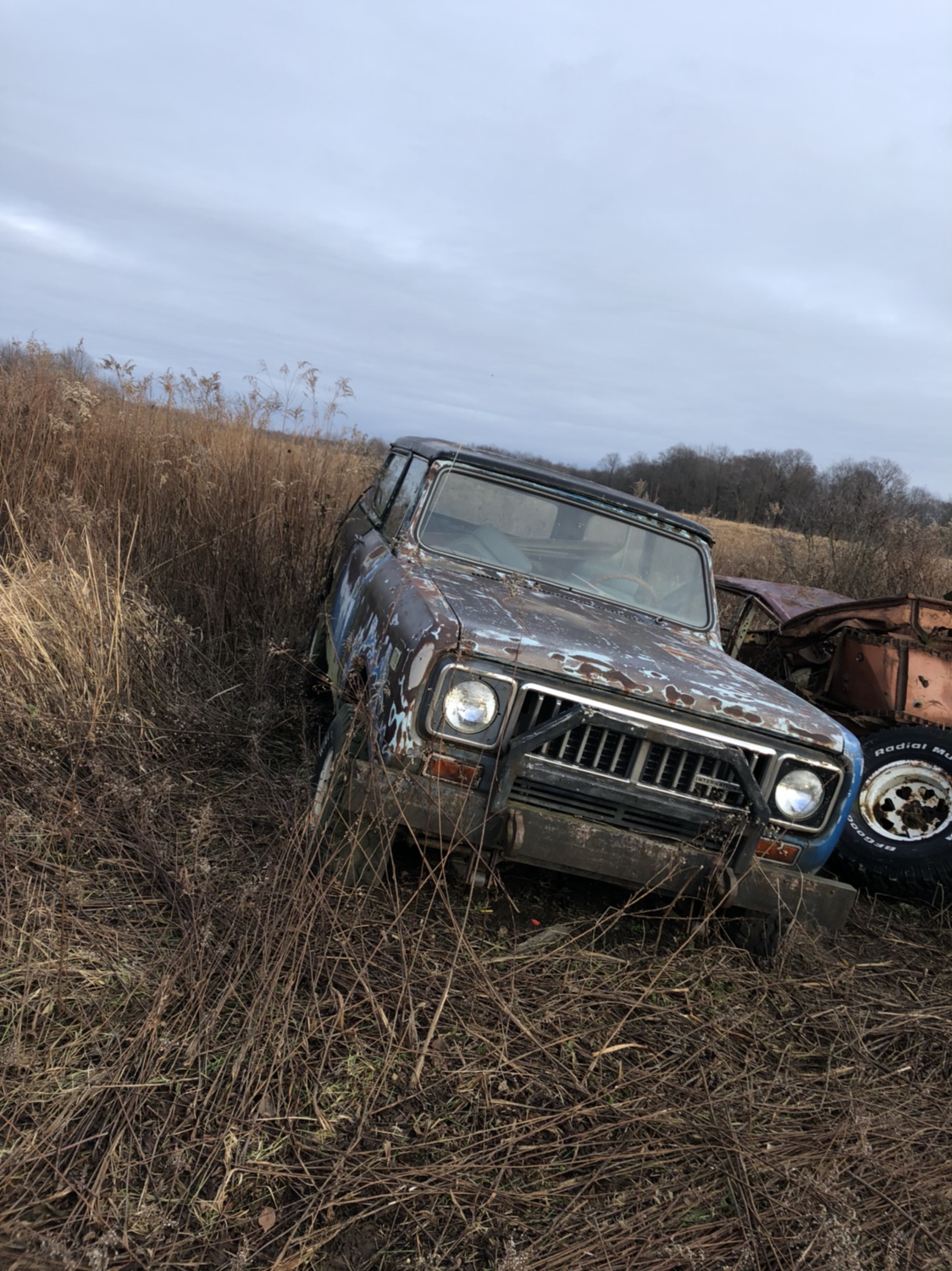

78 international scout. It’s been sitting for 30 years . Got it for free from a buddy’s uncle . 304v8 with Dana 44’s and front locking hubs . Just a couple small things and it should be running and driving .
Birdman and Git-Um-Up-Scout.
Or you could name it Tonto.
Good score. I've owned a couple Scouts, but neither
had the V-8. They're tough.

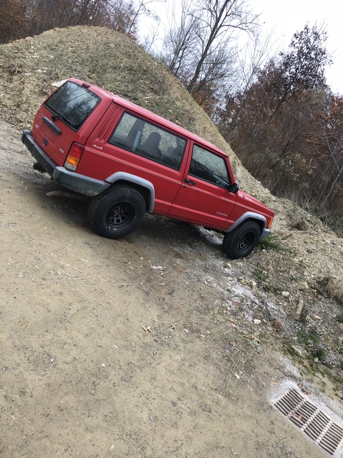

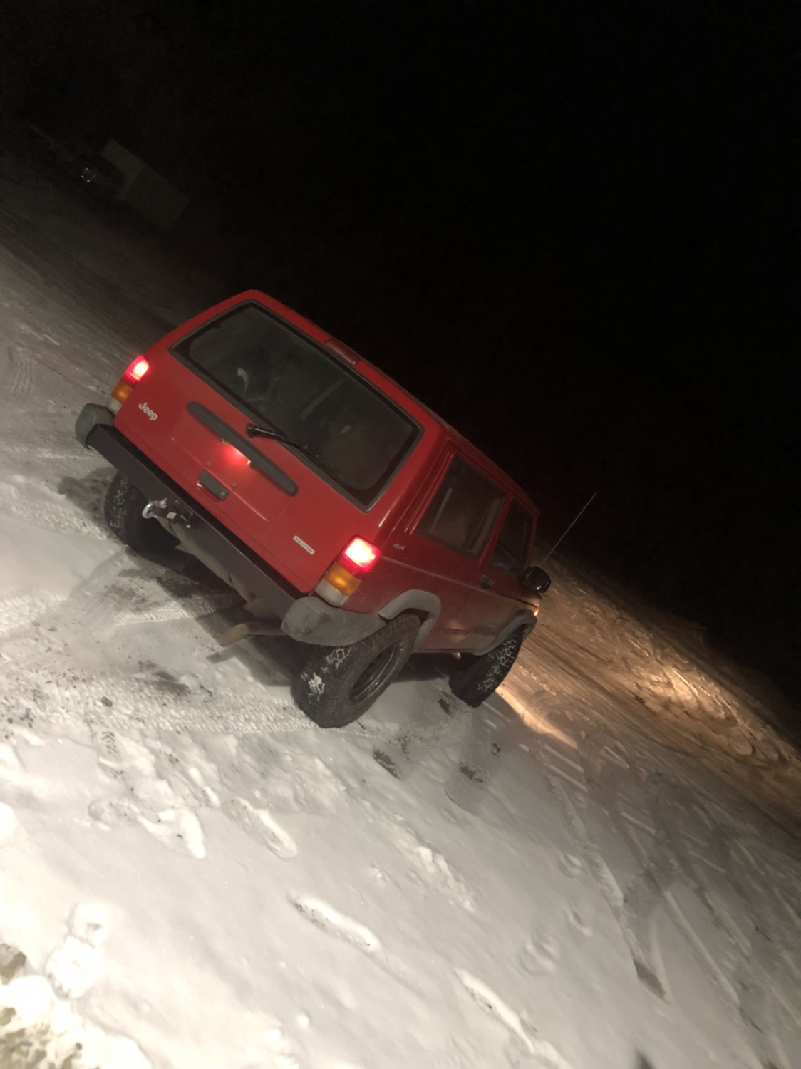

Been awhile , but she’s finally street legal !!
no issues , just had to swap map sensors because my old one was causing me to get 7 miles a gallon. Swapped it with one from my parts car and now it runs like a champ getting 17 mpg. Still need to finish the rockers but she’s coming along.
