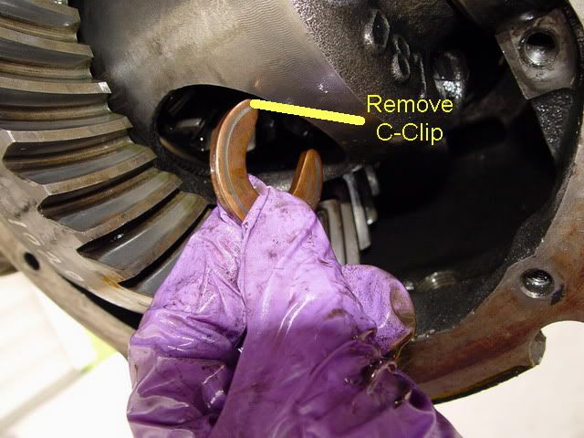

You have a C-Clip axle which means it's held in place inside the axle housing. You need to take the rear diff cover off and remove the c-clips.

Sorry, I don't think I explained my problem clearly. I took my axles out already. When I look into the axle tube ends, there's a seal then farther in there's a roller bearing. Those are the things I can't change out.

Remove the seal, then the inside snap-ring then pull the bearing.
You may also need to remove the brake backing plate.

Snap ring.....DOH....
How come neither the FSM or Haynes says anything about a snap ring? Haynes says to pry the seal out then just go at it with a slide hammer. The FSM says to just use their special tool that pushes against the axle tube to pop both out at the same time. So confusing...
