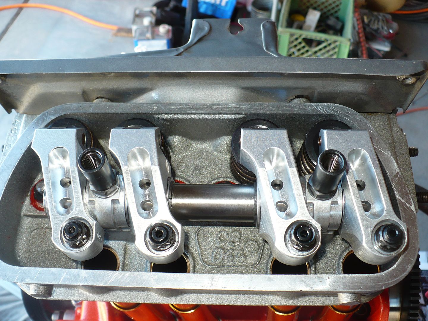

Try again after everybody in my house got Covid! I finally got the entire engine assembled, now I have have to measure for pushrods and order up some custom ones.

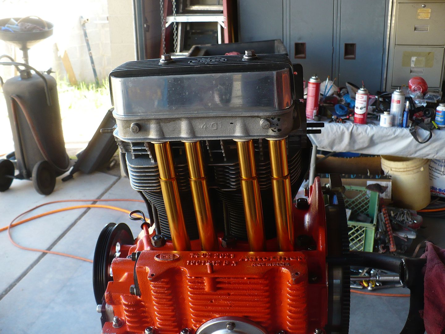

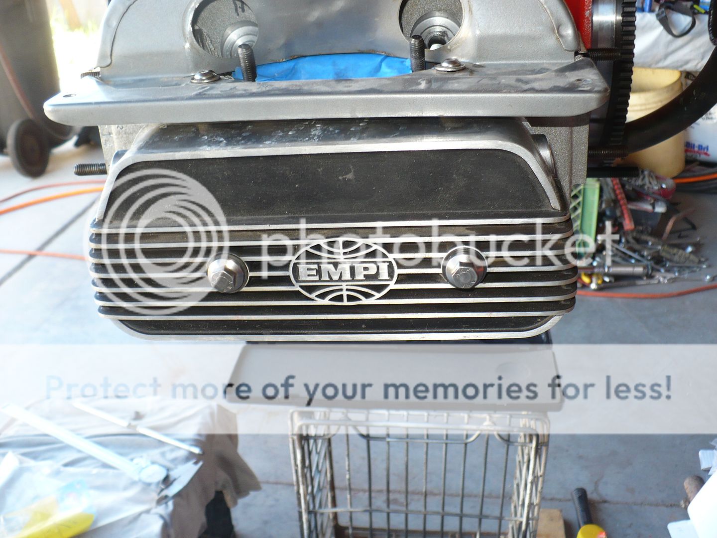

I got the "big bore" pushrod tubes and valve covers installed.
