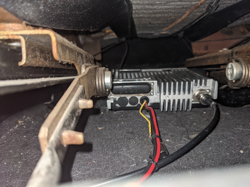

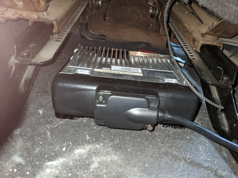

Spent the day on mine and will tomorrow as well. Think I have it on the run with mock-up of overhead bracket, copied from another member. Love that there will be very little weight there to wobble and no heat on the headliner. Hoping my remote pigtail is long enough to reach the driver's side under rear seat and should be good. Considered under passenger front but like the protection of the rear.
